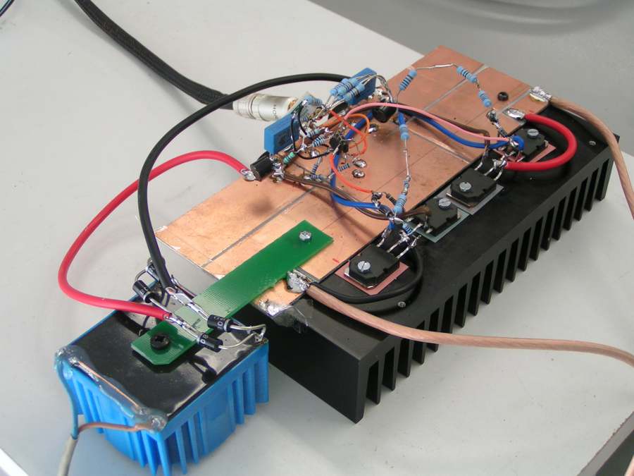

I just completed a fully DC-coupled, all-FET, zero global feedback, balanced bridge power amplifier. It has a dual JFET in the differential input stage and one dual JFET in the balanced driver stage. The driver stage directly drives the H bridge (4 x power MOSFET). I didn't use constant current sources nor current mirrors.
The design uses local feedback to set the total gain. The design offers very high PSRR, and runs from a single 40V DC power supply.
It has balanced inputs, but can also be driven single-ended. In this case the inverting input must be connected to GND in order to avoid picking-up interference.
Stability is so high that I could leave-out both input filter and the Zobel networks on the outputs. The back-emf of the speaker is rectified and fed back to the amplifier power supply.
Both halves of the H-bridge run at approx. 100mA bias current, set by diodes (1.2V voltage drop).
Due to the bridge configuration it's easy to achieve high enough gain to drive the amp to clipping levels with only 500mV input signal. This way lower DAC output voltages can be used.
The DC-offset at the speaker equals around. 80mV without offset trimming. When tuning the input stage and / or driver stage source resistors, DC-offset can be further reduced. DC Drift is very low.
This power amplifier provides exceptional resolution and clarity. There is no audible grain or glare. The full DC-coupling also avoids sound coloration introduced by coupling caps.
I attached a picture of one mono block prototype. I used a 25VA transformer for quick testing, limiting output power to approx. 11 watts rms.. Not a "breadboard" this time, but a blank PCB mounted directly to the heatsink.
The picture also shows how simple this design is, I built this prototype in half an hour.

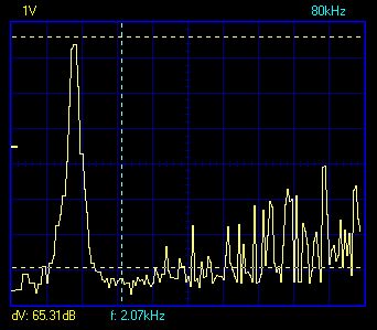

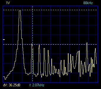

John, why not run a 1kHz 0dB signal and show the FFT result?
That is what I did as well to find optimum load for the TDA1543, just find best compromize between output voltage and THD.....
and here to compare a lower output voltage configuration with consequently lower THD
of course this is only valid for the setup I used (VB = 8Volt and mid bias 3,85Volt)
Johns bias setup is different. This is just to show it is not a digital world we live in :D

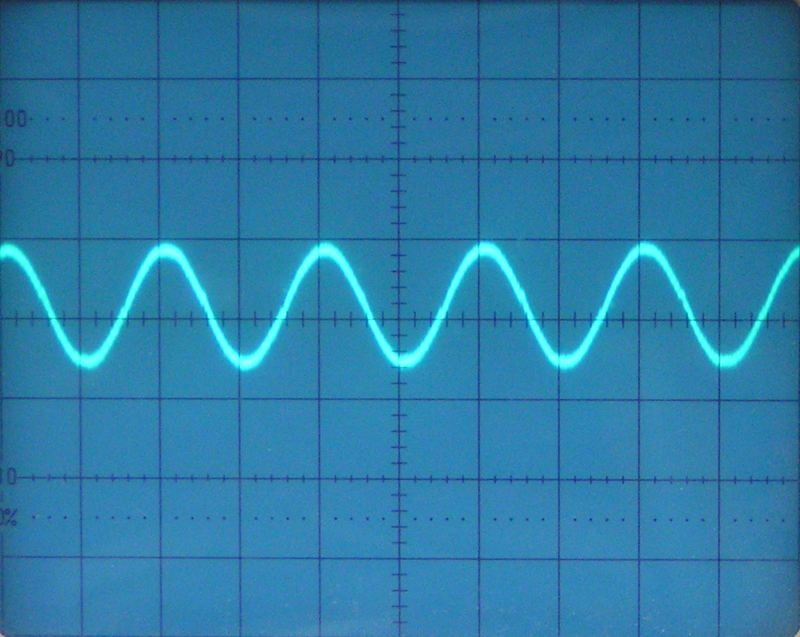

Hi FYC
Hi EC, thanks, but still I cannot understand.
Sorry, I was too hasty and made a mistake. The bias voltage across the I/V resistor is added to the 1.8V bias voltage of the TDA1543:
1.8 + (0.00115 * 680) = 2.582V.
So the ac signal swings around 2.582V:
2.582 - 0.782 = 1.8V, and 2.582 + 0.782 = 3.364V.
I added an oscillogram of the SD-player output, lower division equals 0V, upper division equals 5V, setting equals 1V/div, the signal swings between 1.8V and 3.5V.
The external bias voltage needs to be 2.582V or slightly higher (margin), I used approx. 3.2V DC.
Based on this, the maximum output voltage with passive I/V conversion, 1.8V DC at the DAC output, and a 9V power supply theoretically equals:
9 - 1.8 = 7.2Vpp or 2.54V rms with a single DAC chip. I/V resistor value: 7.2 / 0.0023 = 3K1.
External bias voltage would need to be approx. (0.00115 * 3100) + 1.8 = 5.365V or slightly higher (margin), 6V DC for example.

Hi Bernhard,
John, why not run a 1kHz -60 dB signal and show the FFT result?
I guess I have to buy a suitable spectrum analyzer first. Perhaps somebody could give me some tips about suitable and affordable equipment.
I did attach the 1 KHz -60dB signal from the SD-player (TDA1543, cryo-treated, 680 Ohm I/V resistor, 3.2V external reference voltage, battery powered, unfiltered).
Scope setting, 1mV/div.
This might give some impression about low level performance.
