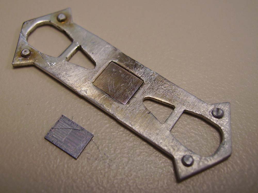

This is a curiosity only. I have a defective TDA1541A and I've opened it to see the chip. See enclosed. There is the chip in itself and is mounted on a metal piece to disipate heat. In the process I've damaged the chip, sorry.
It's fan.
Best regards, and have a nice weekend

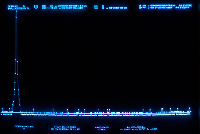

While I was on my analyzer for another thread, I did a FFT of my DAC with passive I/V @ 1 kHz / 0dB.
As you can see, it is totally clean down to the noise floor of ca. -90 dB.
I was lazy to program averaging to remove the noise floor, it would be clean down to and below the limit of my analyzer = -95 dB also...
Vpp on each leg of the balanced DAC is 395 mV, that combines to 1,3 Vpp after the TVC
The measurement was made on the output of the transformer volume control, thus includes the distortion of the TVC.

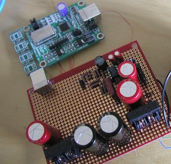

Dear EC, yesterday I made my first attempt with the dynamic jitter attenuator for my D1M. BCK is taken from PCM2707. I put a trimer resistor parallel with 220nf, in series with 150R to ground as per your diagram. The trimer set at 283R (rheostat mode) gave 1,22V DC for BCK. Ripple measured between 150R and 283R (trimer) and ground was around 10mV, even with 230nf or 320nf...is it good enough? Shall I try lower capacitances?
Today I will try to replace the trimer resistor by a better quality fixed R.
Another question> could you advice what tweak would be better for the BCK signals of the multiple DAC chips (DI4 and scrambled versions) converters-> conventional signal attenuator or dynamic jitter attenuator???
Many thanks,
M
PS> the 220R series BCK resistor is place AFTER the bat 85 (in my case) and after the dynamic jitter attenuator. Must I change it?

Hi 2A3SET,
I would recommend using trimer resistors on daughter boards when playing with attenuators and dynamic jitter attenuator (DJA), to set for optimal values and optimal sound, IF you have a scope to check. I would do it just for the fun of learning how the waves move up an down. :D
After that it is easy to measure and replace by better fixed R.
A question> do you get sound coming out?
I report that, even if not optimal, my own version of the DJA made a significant improvement in sonics. :cool:
Another philosophical/technical question to John> do you think using inductors from attenuators R TO GROUND will improve sound???
