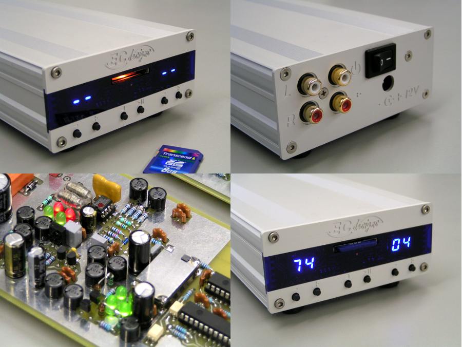

SD-player design is now completed, I attached some impressions of the finished product. This is the basic version, I also plan to design a TDA1541A-based version later, provided it offers significant better sound quality than the basic version.
