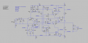

Low voltage adapted for headphone use
Hi Elvee,
I built a headphone adapter for the low voltage bonsai version. The headphone and external speakers can be switched by a toggle. I used the voltage divider scheme to provide a max of 36mW for a 32 Ohm headphone.
I tested it with an old Denon AH-D210 I had lying around and it sounds really good.
Thanks!

Well, it is an unexpected development, and to be honest, I find it a bit too complex for a headphone-only amp, but why not, and it certainly gives good results.
For headphones, I would rather favor a class-A PP in the xyz-style (the name of the creator escapes me for now, but I used it in the driver section of this project: Volume control, Evil Mad Scientist style).
It is much simpler, uses a comparable amount of of power and offers an excellent quality too.
If someone can recognize the xyz topology, i would be grateful if he/she can name it, otherwise i am going to lose sleep about it until my memories come back
It looks perfectly OK then.
About the headphones divider, I am not sure that it is the best solution for all types of HP: traditionally, headphones were connected to the main amplifier output via a single, largish resistor (470 ohm or 1K for example).
This was more or less equivalent to current drive, and for many types it resulted in a pleasant sound.
Nowadays, many audio devices have a HP output only, and the impedance is very low, resulting in a high damping factor.
Those types are probably optimized for such a driving method.
With your divider, you have a tradeoff between the two methods: a more or less matched drive, similar to many tube amps.
It may be the best option for your HP's

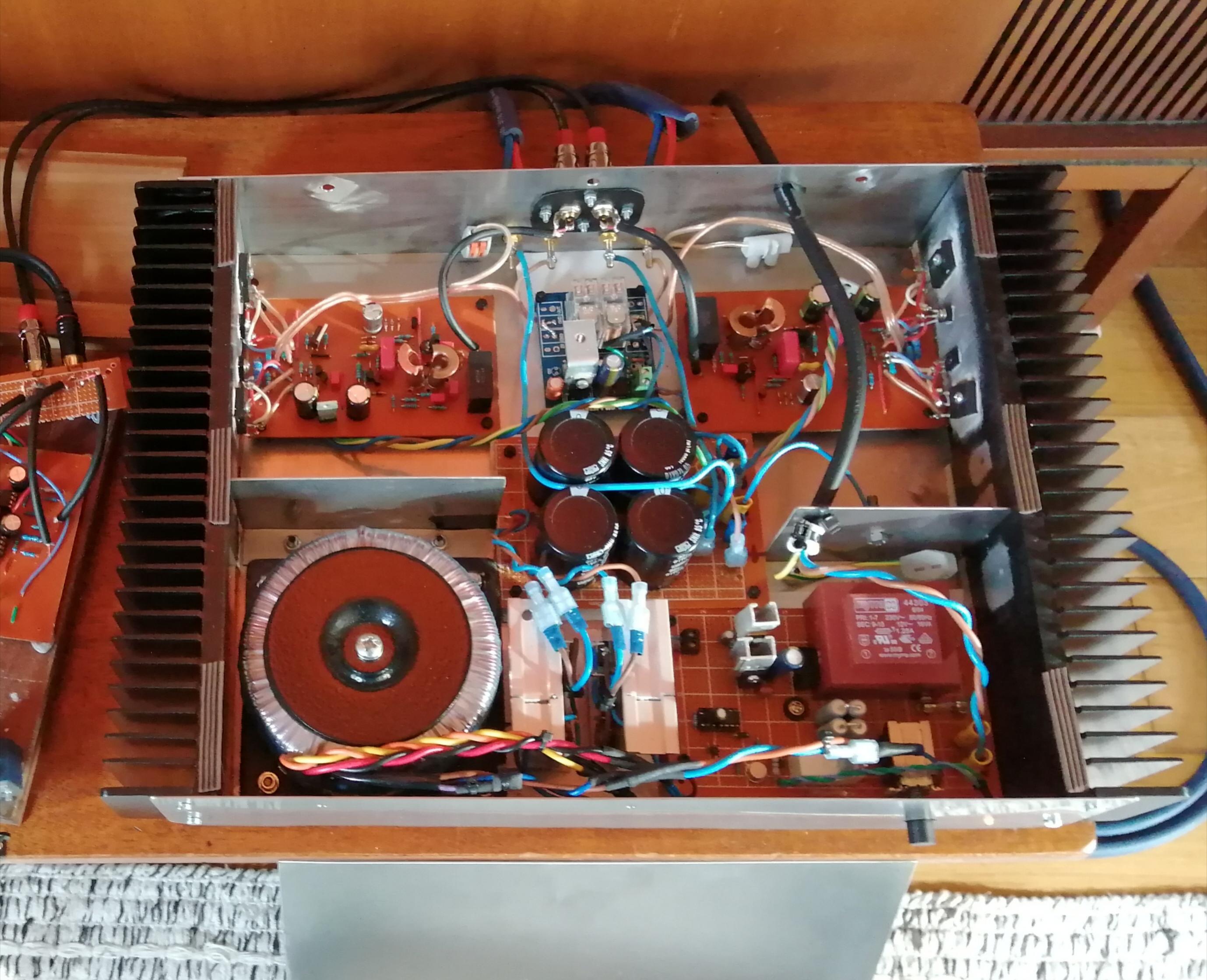

Hi all,
This thread has been a safe harbor for me during the last 6 months of global craziness.
Sincere thanks to Elvee, Daniel, et al.
I built the 'Standard' Circlophone on page one ( 35vdc ) on diy wakibaki pcbs. My second amp build.
It is wonderful... Clean, lean music making machine. Pleasant mix of musicality and precision at all frequency ranges. Perfect scope measurements.
Welcome to the C-club!
Is there any reason not to use a nonpolar / bipolar feedback capacitor (C3)?
You can always use a BP cap in all polar caps roles, and C3 is no exception.
BP caps are bulkier and more expensive than regular, polar caps, and when they are not needed they are normally dispensed with, but you are perfectly free to use one in this case.
In the case of C3, it will normally see the polarity indicated on the schematic. It's only mV's, meaning you could safely install it the wrong way (but I don't recommend it!), and if something goes really wrong (with the output stuck to a rail for example), the back-to-back diodes will protect it.
To summarize: using a BP cap is not needed and brings no benefit, but it cannot harm anything either.
Is a lower voltage supply preferable when driving low impedance loads?
It all depends on the max output power you need: P=U²/R, which means that a lower impedance will increase the power accordingly, maybe exceeding the limit of your speaker or your circlophone build if you keep the same supply voltage.
The C is like any other amplifier, and the output power is dependent on the supply voltage and the load impedance: its peak output voltage is the rail voltage minus 1.5V. From there you can derive the rms output voltage and the output power.
The subject is well covered on the net and DIYaudio, but if you need more details you can always ask.
You should avoid designing an amplifier having a larger output capability than your target speaker: there is always the risk of someone pushing the volume knob to the max and frying your speakers
