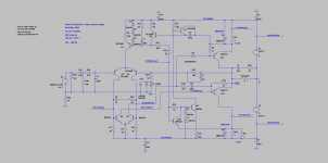

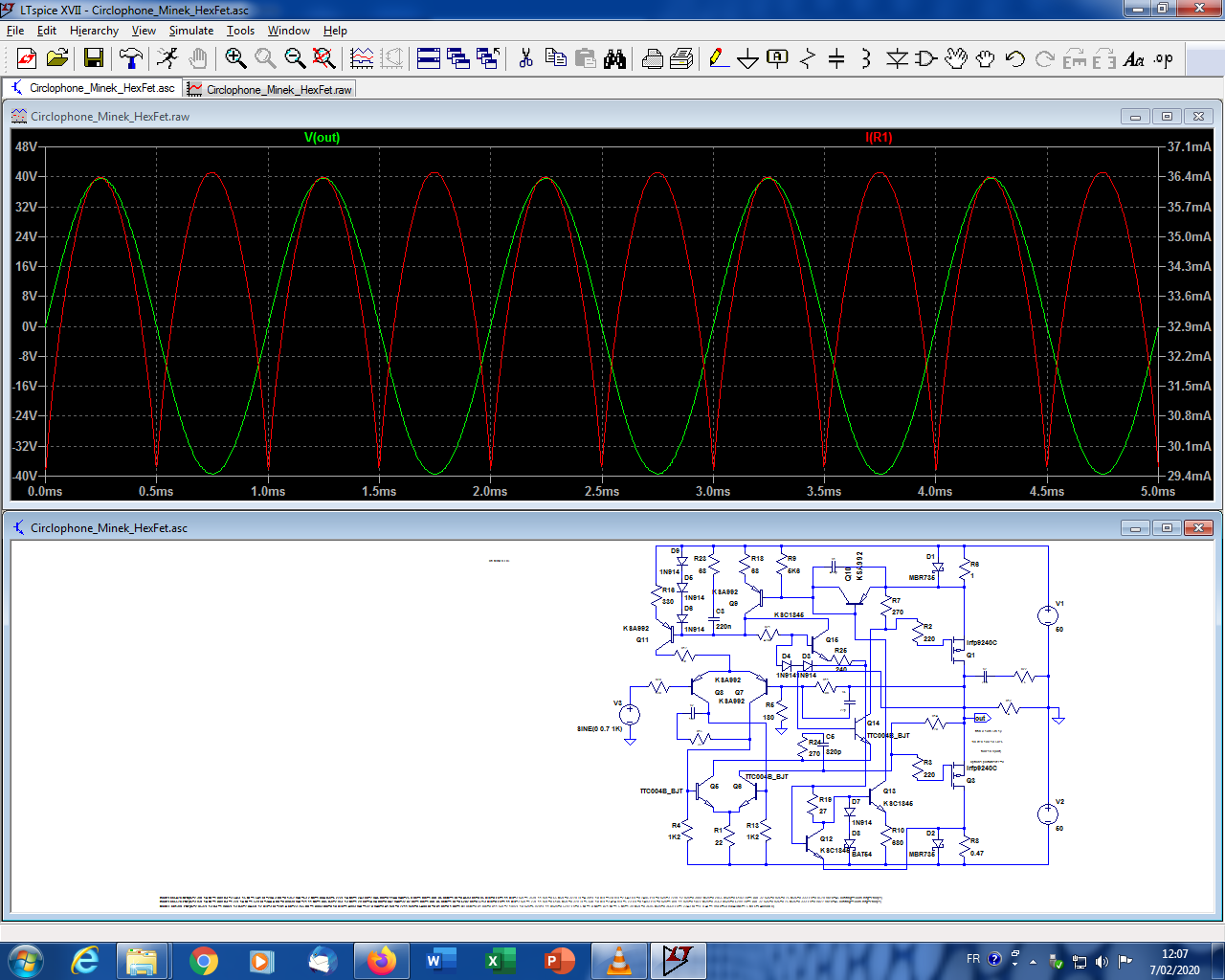

Polarity is correct. Cap voltage is correct (50V). The cabinet is not ventilated well, but these caps are warmer than the PS caps!
The simulation shows significant current through these caps though.
Can you attach your asc file?
I checked in my simulation - no current flowing through these caps...
Another possibility - are these authentic caps, or perhaps cheap/fake caps from Ebay, with advertised voltages higher than in reality? Like 25V caps sold as 50V caps?
Joined 2014
So, I guess I have to remove R29, R30 and hope for a good enough local decoupling with just the C8, C9 caps. Or, do I reduce the value to 200uF as prescribed originally by Elvee?
Thanks for the experiment, Minek.
From my experience, I keep smaller (E.g 220uF + 100nF caps on the board), and of course big caps in the PSU.
I personally didn't see any difference in test/measerments/performance if I put big caps on the amp pcb.
Something is not logical here: heating these caps would require a large 100/120Hz current, or an even larger HF current.
Such a current would cause a massive dissipation in the OP's, which should be noticeable.
You should look at the rails with a scope: if an AC current causes the heating, an AC voltage should be visible.

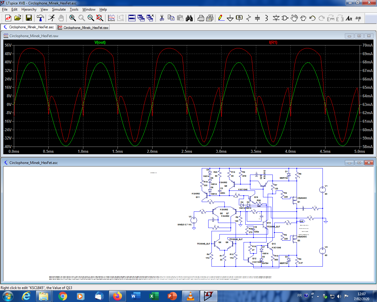

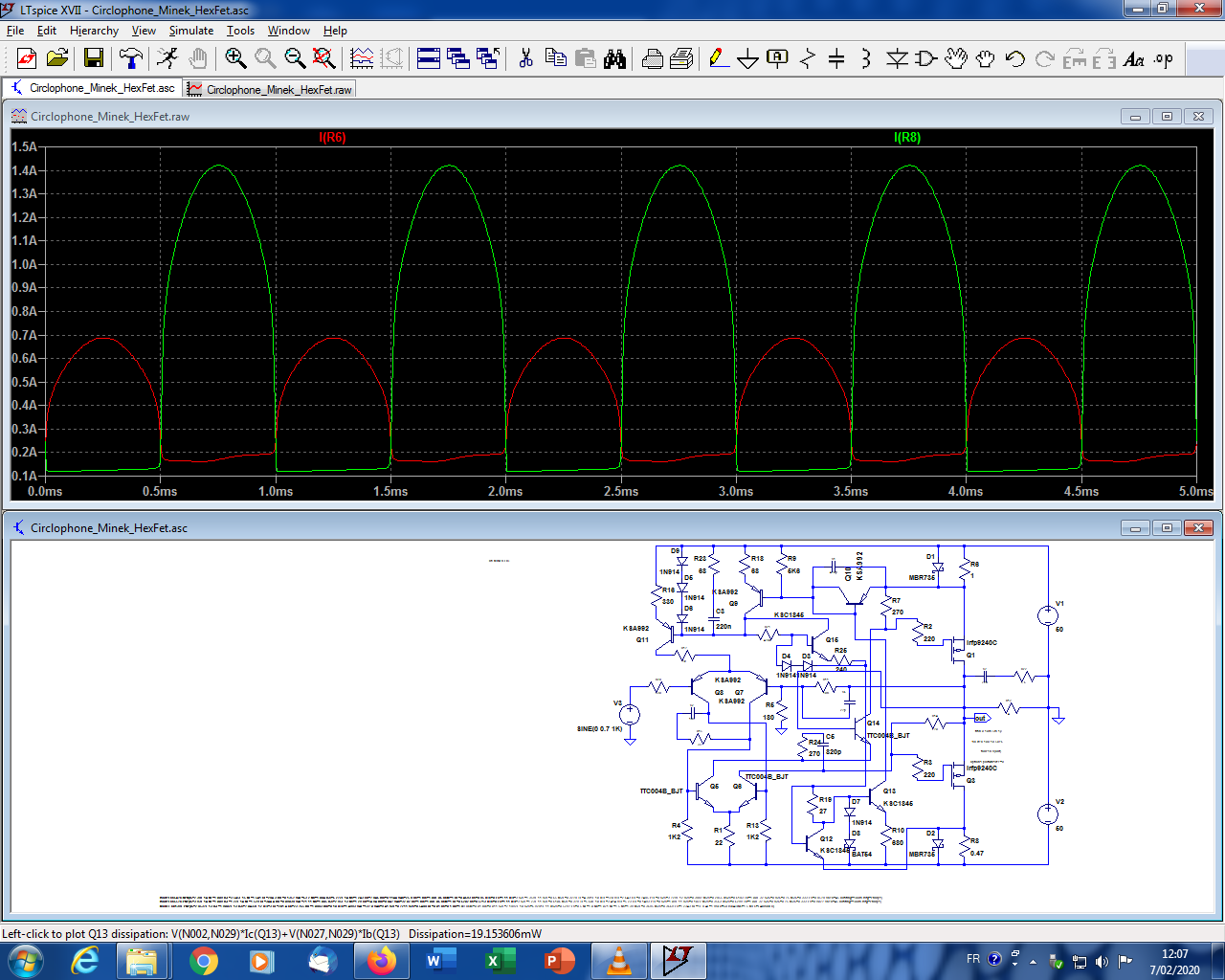

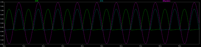

It does not work properly: the Circlo engine runs out of steam, probably because of the high supply voltage and the poor lambda of the PMOS.
Here are the currents in the sensing resistors: you can see clearly that the engine loses control and that the quiescent current falls to zero, with a disastrous effect on the THD:
attachment.php
The tail current of the VAS also has a nasty look:
attachment.php

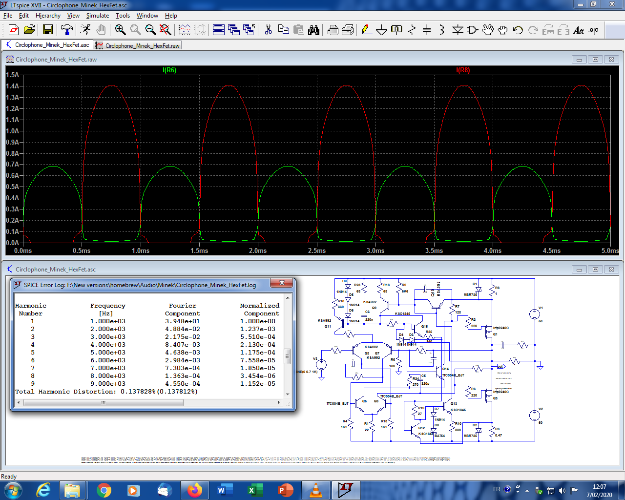

If the values of R7/R14 are doubled, things return to normal:
attachment.php
attachment.php
An unexplained asymmetry remains between the two quiescent currents, but it looks mostly harmless

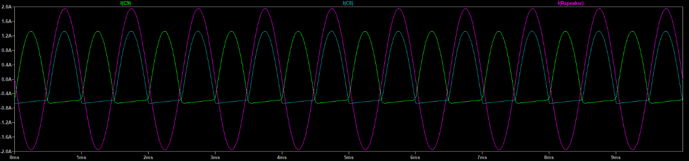

Hi Elvee,
Can you please explain the currents in post #461 ?
A cap subjected to pure DC cannot heat up. To do that, an AC current is required, and since a cap has a Dissipation Factor, part of the apparent power will be converted to heat.
A current applied to the impedance of a cap will generate a voltage, because of the generalized Ohm's law, and this voltage has to be visible.
For example, if you use a too small filter cap in a supply, say 470µF for 3A, it will be subjected to a huge ripple, will see a large 100Hz voltage and will heat up and explode very quickly.
If your circlophone sits idle, the ripple current will be minimal, and practically no AC current will be present

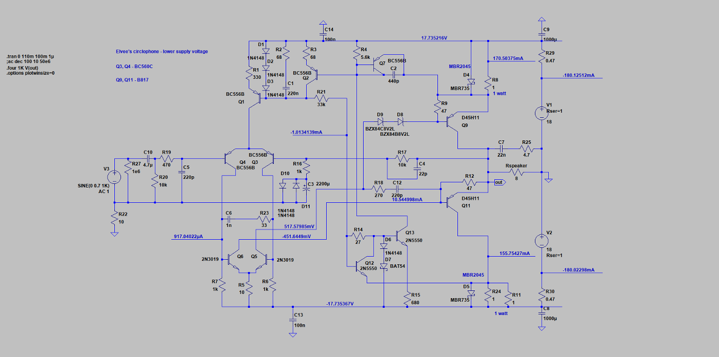

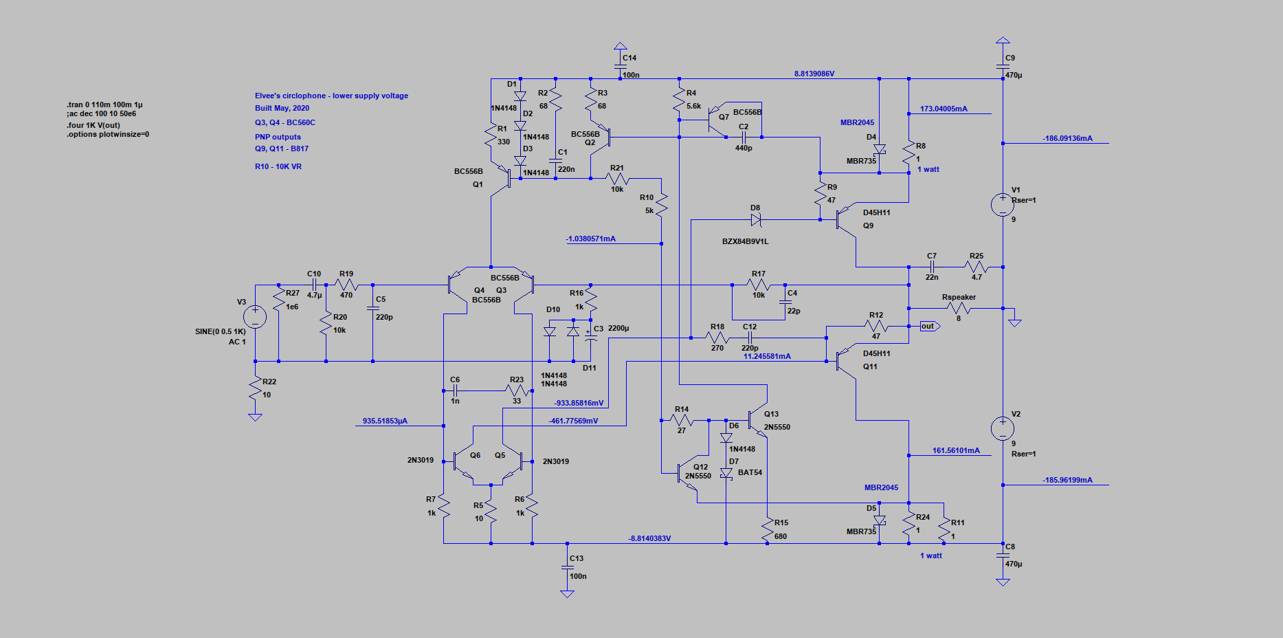

Hi Elvee,
First, thanks for the wonderful amps. They are working great. My preference is the BJT version with D1047 outputs.
I was wondering if a lower PS voltage version (like your "bonsai" version) would work with just a PNP output transistor. I am considering B817 with HFE around 120 - 140 for this circuit. If you get the time, can you please review the circuit.
I am considering this variant for the hot summer months, and till I get bigger sized heatsinks.

Hi Elvee,
Both channels of the lower voltage circlophone bonsais are singing.
Excellent news, even if they come as no surprise: the C topology has been twisted, sex-changed, upgraded, simplified and adapted in many ways, yet it has never failed to the deliver the goods.
It is an ugly little duckling, but it performs remarkably well.
It would be even better if the topology was elegant, but we can live with something that is just plain and effective
