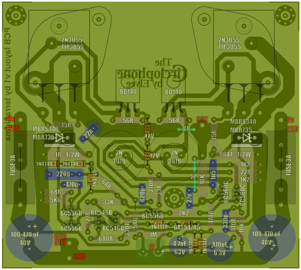

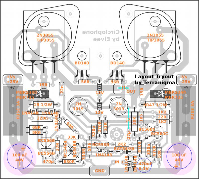

My approach on plain Circlophone
Hello all,
I want to share my plain Circlophone layout tryout. I tried hard for this time. It's output transistor and driver arrangement based on Dx amp (by Carlos). I thought that such kind of layout is best to use TO3 metal case output transistors. Still can be easily converted to plastic case only layout but this is not the main purpose.
Any opinion appreciated.

My pcb status
I think I'm close to final but not sure. Grounding scheme is in question. Due to different requirements of TO3 metal transistor construction, I decided to offer plastic transistor version separately. Bord size is 100*60 mm even with those fuses and bigger bypass capacitors.

Hi terranigma,
I know nothing about pcb layout but can I ask why there are parallel ground traces running next to each other between input and "ground out" ?
I like your pcb so it might be the first pcb that I try to etch myself! What are the exact dimensions?
Cheers
Hi jerryo,
In current revision, I merged the input ground track (the one you mentioned I think) in to the main track. At first, i supposed to establish a star ground effect but later decided to avoid it due to short track length. There is going to be 2 different boards but same layout. One is metal transistor and plastic transistor version which is 10*9cm, other one is only plastic transistor version which is 10*6cm.

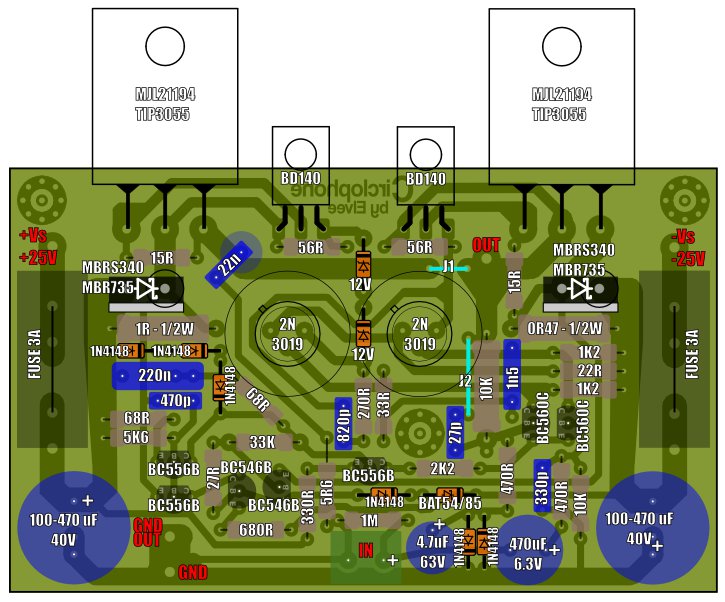

Final versions so far..
Hello All,
I think that my layout is ready for an actual build, though haven't build one yet.
I have exported two versions with same layout. Hybrid (Metal + plastic) version is constructed best with L-shaped aluminum profile. Suggested minimum profile size is 40x40x6 mm. Board sizes are 100x90mm and 100x60mm respectively.
Hope they will be useful for prospective builders of this extraordinary amp.

Hello Daniel,
I wasn't aware of that situation regarding to the referring other posts in same thread. Btw, Option-1 would be the best shortcut as workaround for this issue. I thought that it would be good to not bloat the main thread with pcb design experiments but at this point, it seems it is best to post at least final pcb revisions at another thread rather this one.
I will try to collect my contributions at another thread (or page) and contact with you via PM.

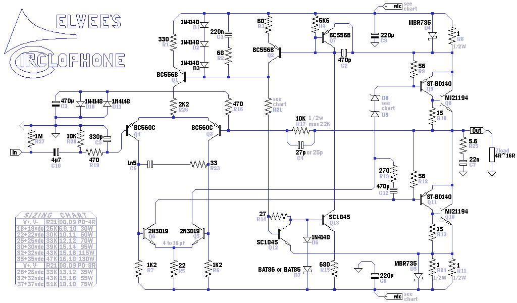

Guys, would it be possible to run this with ±47V rails? What value would R21 need to be then? 68K?
Theoretically ±47V is possible, but I don't know any builder here used such high rails. For example, I've never go over 32V rails due to my limitations but I'm planning to build a high voltage version with 2SC2922's.
With such high rails, you should strictly select transistors depending on their SOA and Vce ratings. My Japanese Darlington&Mosfet version at post#227 is a good example.
I'm using 2SA1698's as PNP Servo transistors now and I'm quite happy with them. I'm using ST TIP142C darlingtons as outputs. I think I gone too quick with doing listening comparisons with UNMATCHED mosfets. Mosfets require much more strict matching.
The current flows over R21 should be 1-1.5ma. I've made some simulations depending on this purpose and I posted values at post#228.
Paralleling would be possible, but only if a strict matching is enforced otherwise it could have unpredictable effects
So, what about darlingtons? Are base resistors necessary?
