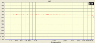

50k pot can make it ''slower'' but not droop it anywhere near the audio band.
I just measured for you a Mez build I got here with 20k pot. It was connected to the amp as I was measuring from a parallel output. 176.4kHz rate 1/96 octave band pink shows just my Emu's filter shape 88kHz limit with the DCB1 in the loop. 48kHz 1/12 added to see the lows too. There is something else wrong in your system most probably.
P.S. THD+IMD merged plots 0dB=1VRMS top, 160dB window.

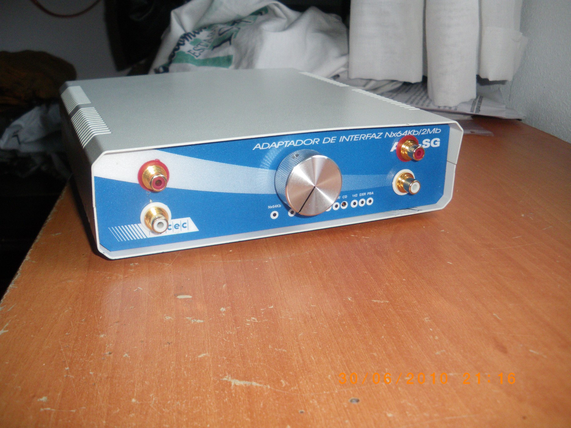

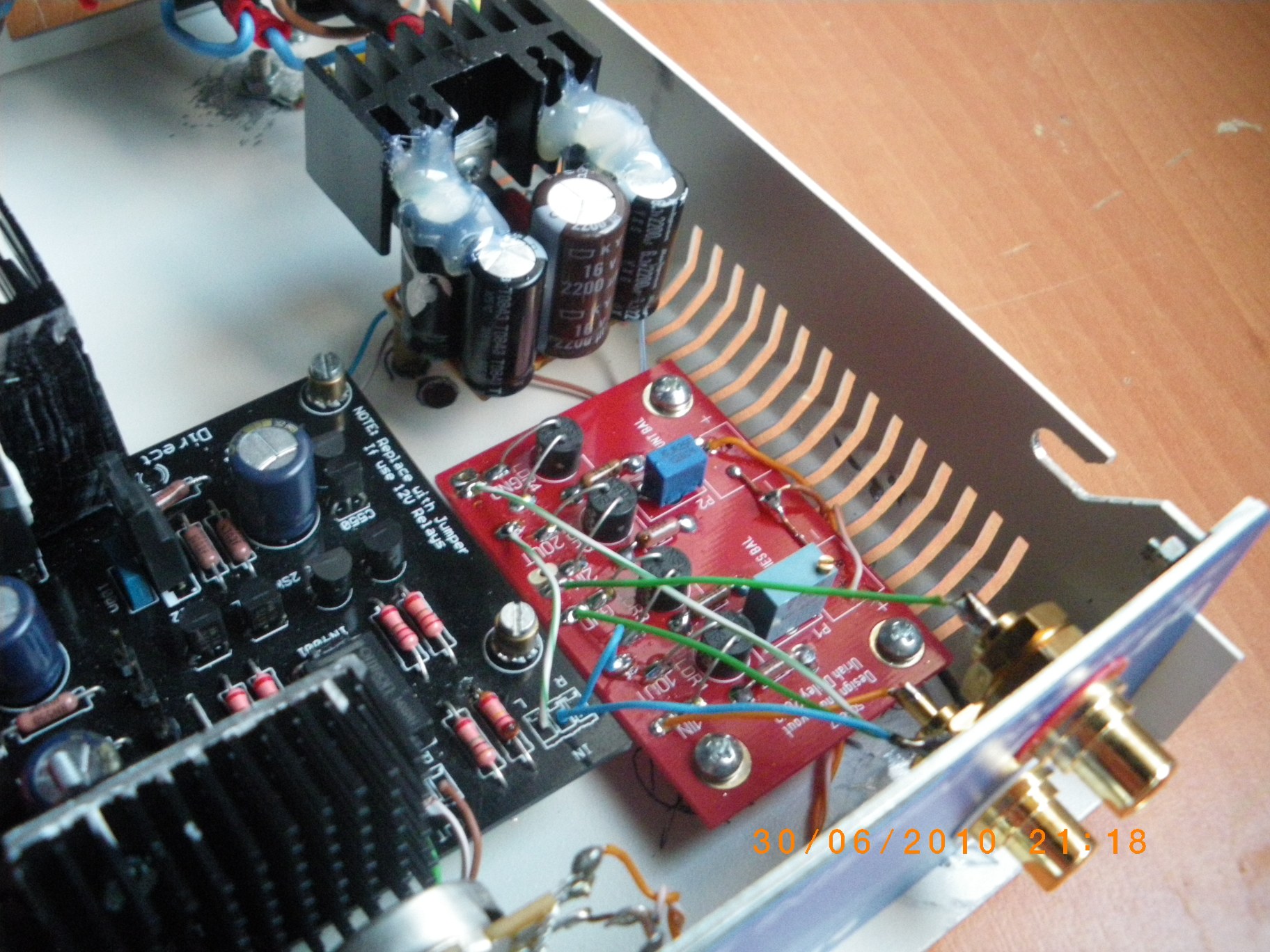

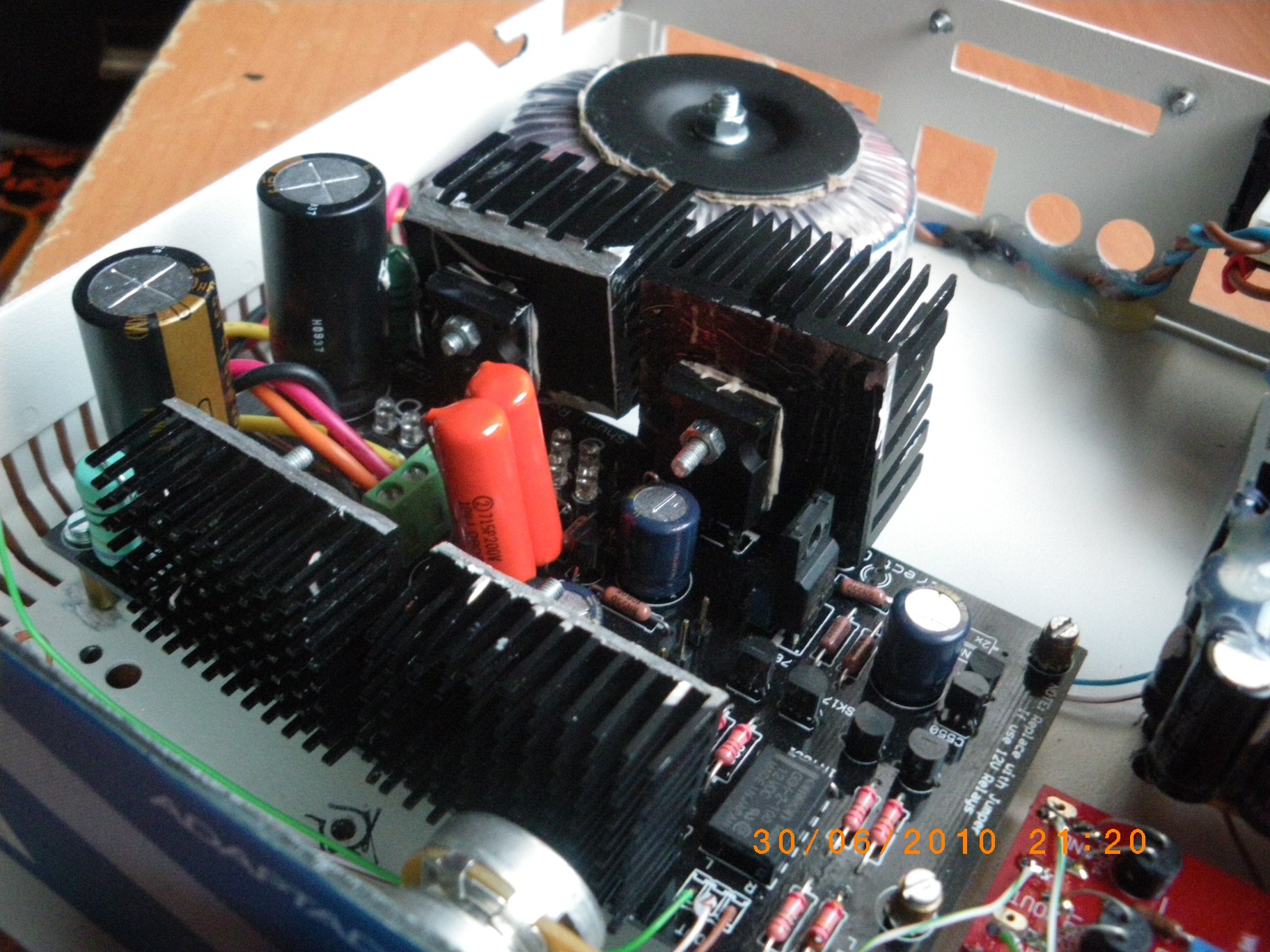

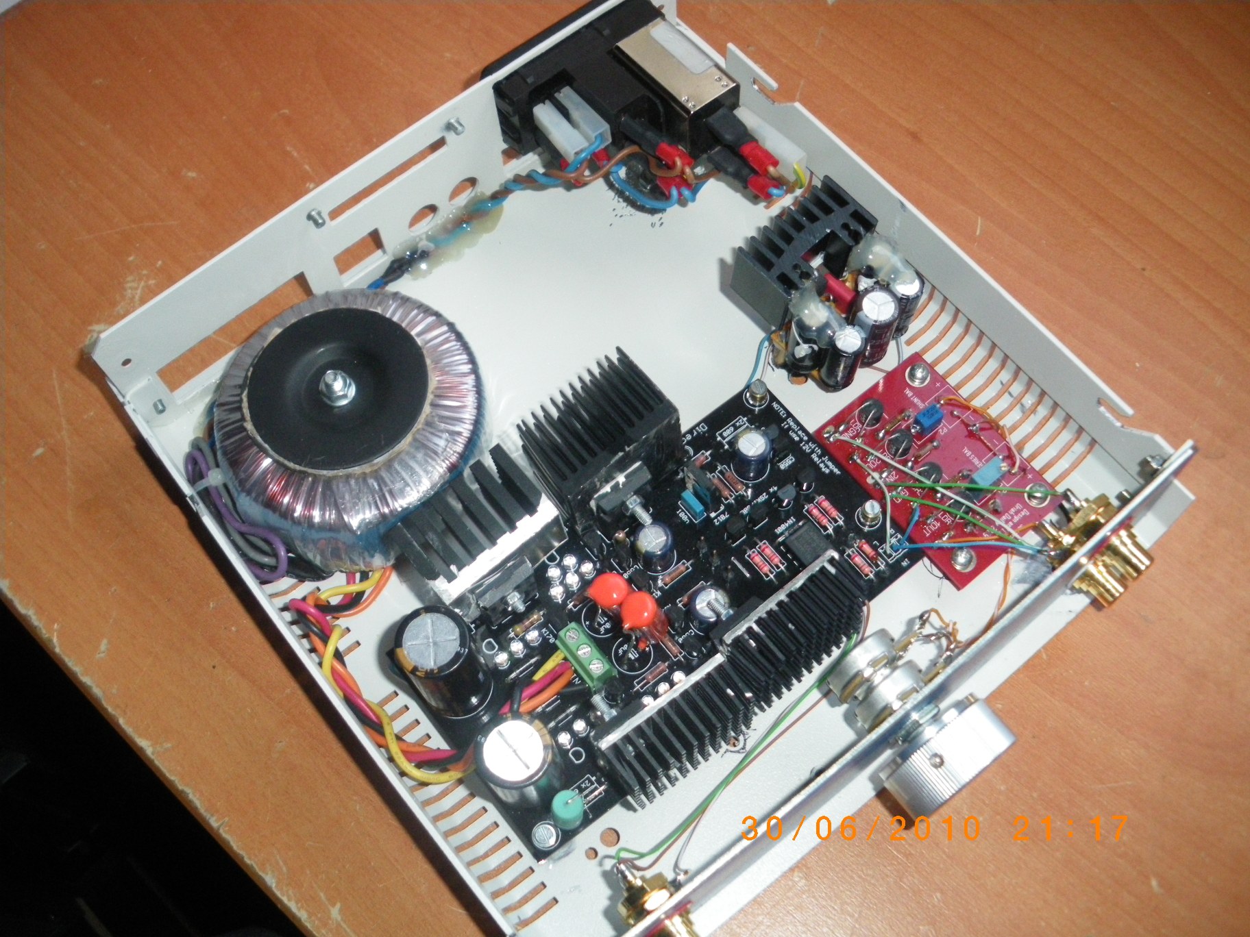

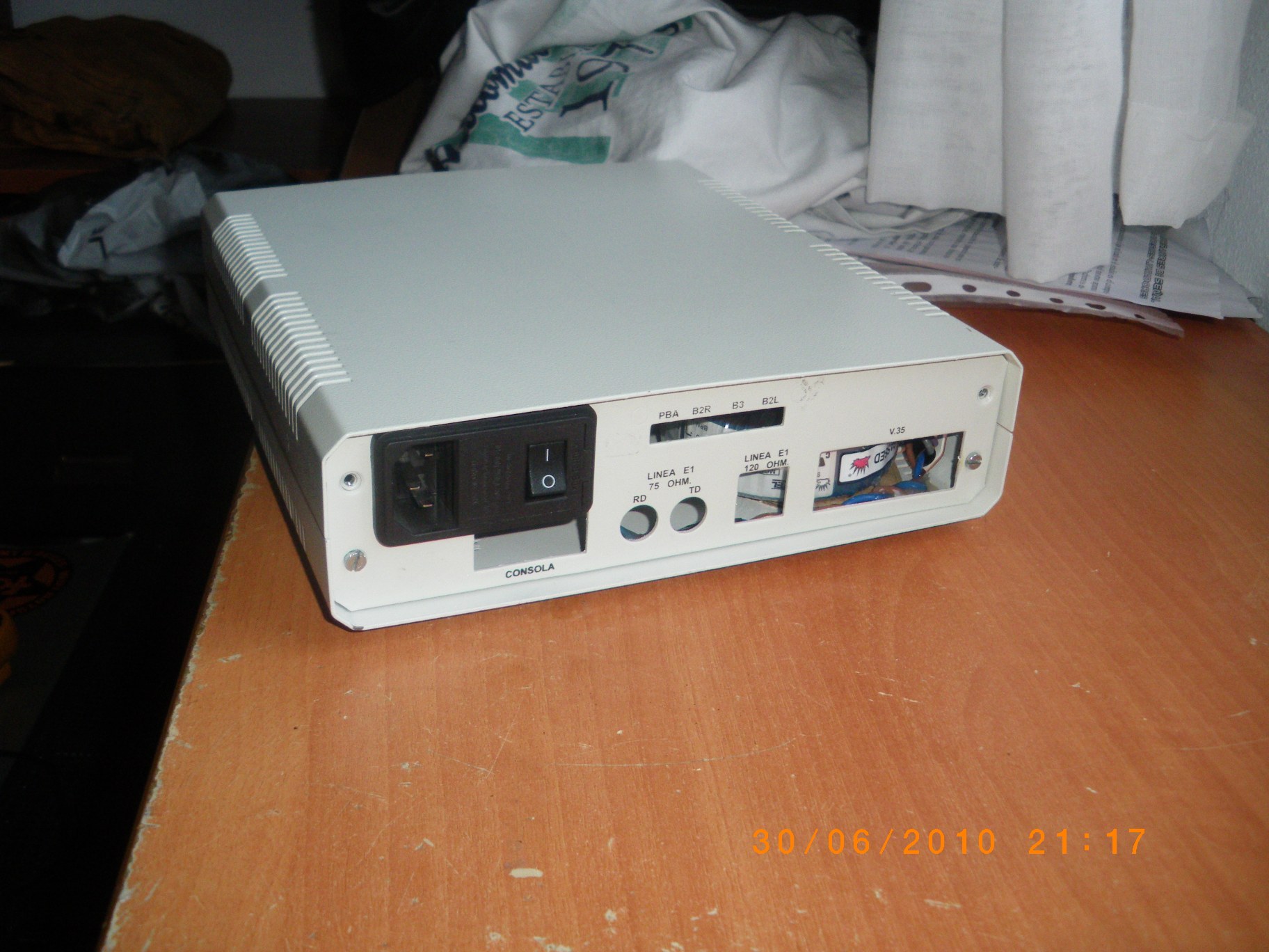

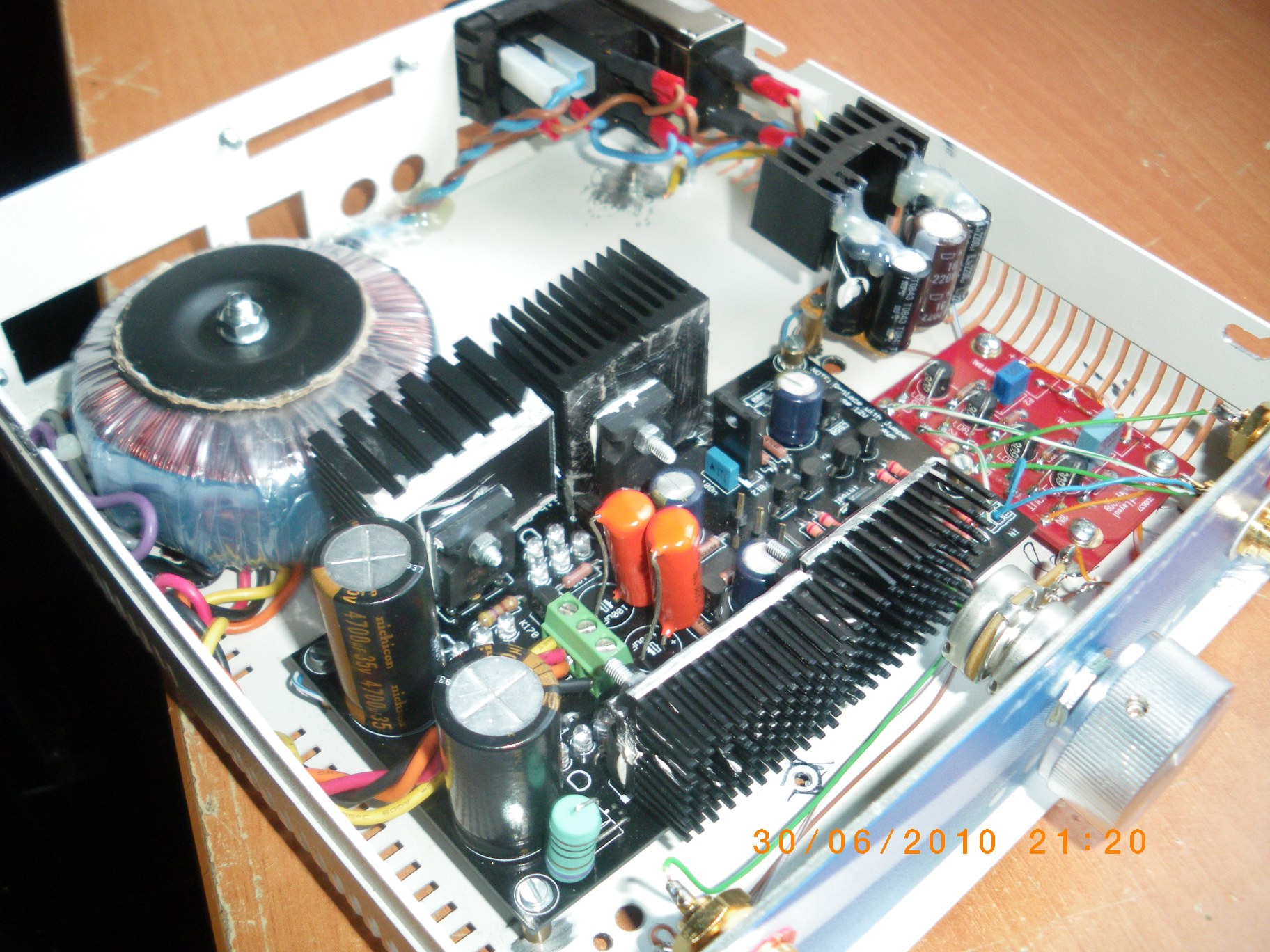

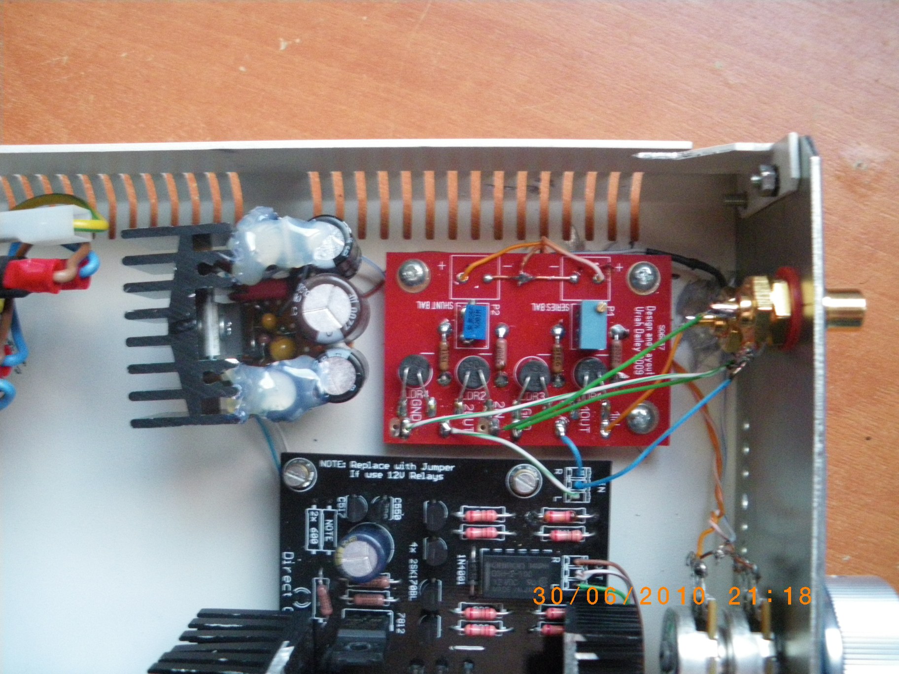

I have finished my DCB1 and placed it in a definitive enclosure. I have changed the internal arrangement to place the transformer far away from the LDR volume control. The LDRs have its own psu separated from the preamp, but feeded from the main filter capacitors of the DCB1.
I changed the bypass caps for two 0.1uF Orange drops. CCS resistor is 10 ohms 5W. Wiring is Cat5e and the enclosure is from an old telecom equipment.
I will make some RMAA measurements and post them soon.
Enjoy it,
Regi
Enjoy it,
Regi

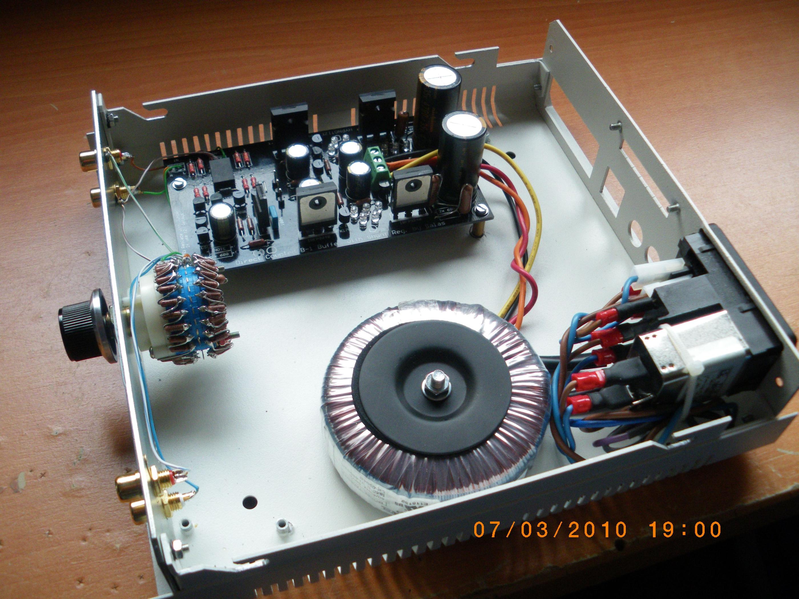

Yeah, it is the same buffer I had before but with the capacitor mod and the LDR volume control. It is the same enclosure but with a different arrangement. Attached is how it was some days ago, with the cheapo switcher.
I really like the sound of this amp. I cannot be sure about the changes because I have changed my loudspeakers recently. But it sure is a better volume control with no contact point issues. The cheap one used to fail from time to time.
Regi
