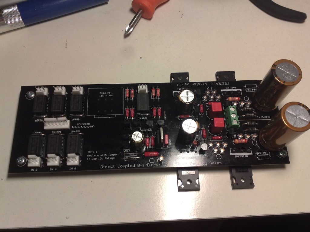

I'm in trouble with LED matching...
I must have missed something.:scratch2:
I've bought LEDs in v4.3 BOM (Mouser 593-VAOL-3HCE4), and measured forward voltage of each LED fed by a 9V battery and a 1K2 resistor in series (right, isn't it?).
Measures varies from 1,901V to 1,910V, in spec according to datasheet (mav 2V froward voltage) but far from the typical 1,8V expected value.:eek:
So no way of getting 9V or 5,4V (9,53V and 5,70 are best match)
Help!
It will be OK. The Vout values will still track with positive somewhat higher as expected and in sweet spot range. Just find 2 similar strings.
I had the same results when matching my leds (same part number). You will get a few more tens of a volt in the supply rails. Nothing to worry about.
Other people in the thread reported to have the same values with the same part number.
Thanks everyone, so it's OK :cool:
Powered ON soldering iron again...:smash:
I have red LED from different suppliers that vary between 1.55V and 1.95V.
Wow! So I suppose I've been lucky...;)
Well, soldering iron now is powered OFF...:D
Haargh, my R-Core transformer is still shipping from France...:headbash:
I've implemented directly last mods, I think...
Vref caps are Wima MKS2XL 2,2uF, the value is ok?
Is 10 Ohm 5W the right value to replace the 68 Ohm couple?
Thanks in advance
