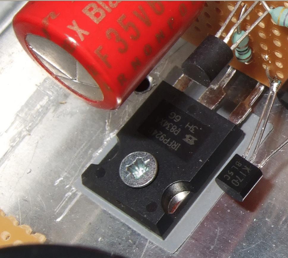

Its a special washer, shoulder washer. So it goes DOWN into the hole in the tab of the mosfet and it also spreads out over the top of the tab. The bolt then goes through this plastic washer and does NOT touch the tab at all. It touches the heatsink only so it cant short anything out this way.
This IS a necessity. Unless you use a plastic bolt.
That's a bummer. Now I have to wait another week to wrap this up. Oh well, thanks for the info.

TO-247 don't need a washer, have a plastic eye. The pad is enough. TO-220 need washer or nylon screw & nut. IRFP series are TO-247 casing standard.
Thank the Lord Jesus. I was wondering why no had mentioned using them this whole time. Thanks as always Salas, particularly for your prompt replies. My goal has been to finish this project during the holiday...
