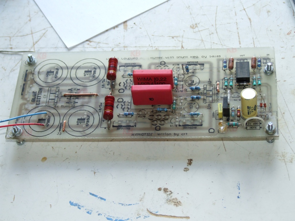

Spooky hum problem
Hi all,
i have a funny problem with my DCB1.
Since i have finished my F5 on sunday, i have disconnected my 300B mono's and now the F5 runs with the DCB1.
Now the following happened:
If i connect only the right channel from the DCB1 to the F5, all is dead silent.
When the left channel followed i have a hum on both channels.
If i disconnect the right channel, the hum stays on the left channel.
All that is intependend to the connected inputs and the mains cable...
Yes, if i disconnect everything including the mains, the problem stays!
Very crazy... Perhaps someone has a good idea...
Hi all,
Oscillation? Do you use same long cables as it was for the 300B amps?
Hi Salas,
Yes, the same cables. I have tried some other Nordost Tyr i have with the same result.
BTW, it's a deep hum but not loud...
