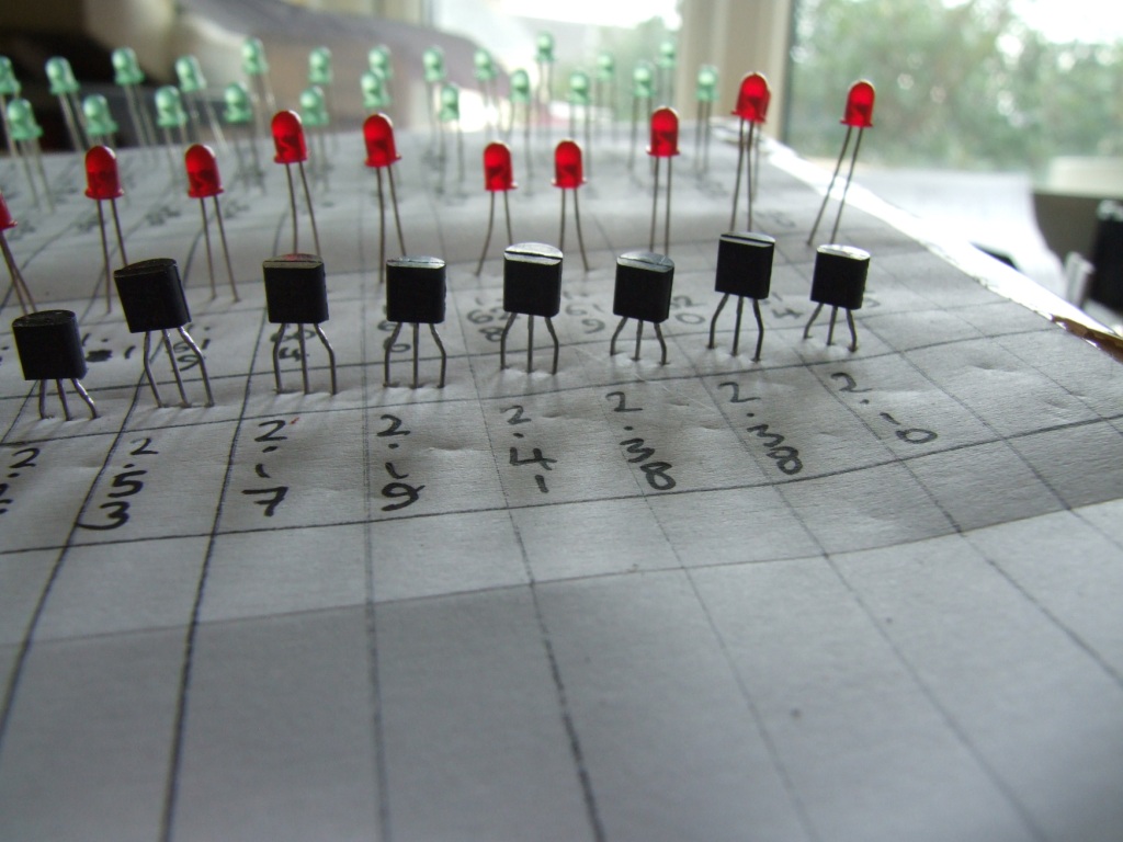

I bought a batch of 100 from spencer and they ranged from about 6.5 t0 11. 2.2 is definitely very suspect.
Andrew, when did you start using 1R0? Isn't that a tad low? I used a 0.1% 100 ohm resistor and that seems to work quite nicely. Perhaps 100 ohms doesn't give quite enough resolution though for really close matching, a 10 ohm resistor would allow me to use the 200mV range on the multimeter rather than the 2V range... I assume this is the reason for going with such a low resistor value? Or is it because you can just use the reading without needing to divide by the resistance?
Tony.
I agree.
You do need at least 10R0 to get full resolution on most meters.
My initial measurements were taken with only the shunt of the meter as a load.
Before I go tearing into my supplier.

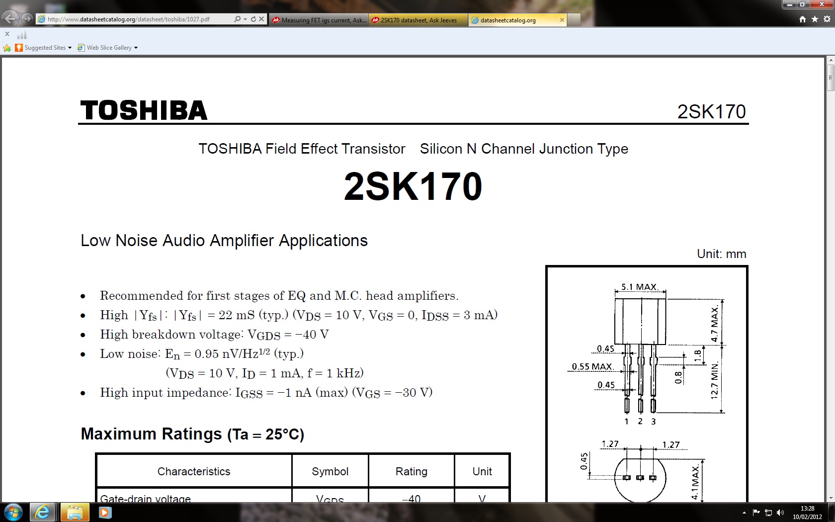

I've just been looking at the datasheet for the 2SK170.
The parameters are quoted at Vds=10V Vgs=0V and Idss=3mA.
That's not too far from what I am seeing.
That is about minimum transconductance expected. 22 milliSiemens is the low side GR(een) grade's bottom Yfs. Anything marked BL(ue) shall vary between 6-12mA IDSS @ 10V VDS with a midway Yfs of 37mS. Else its a bad or fake sample.

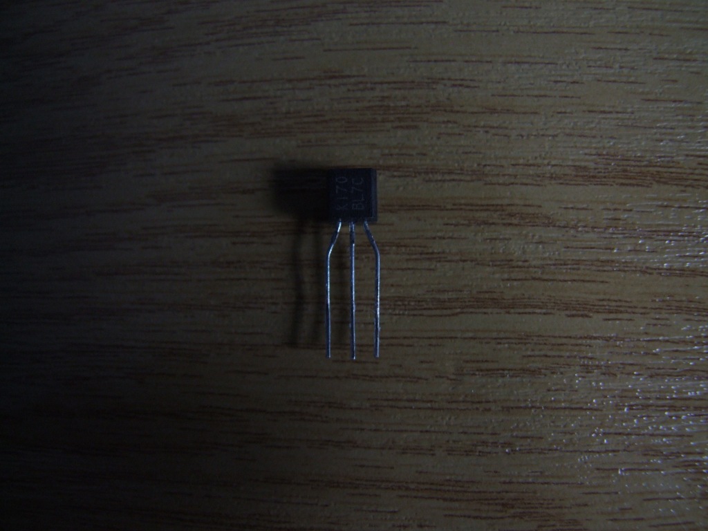

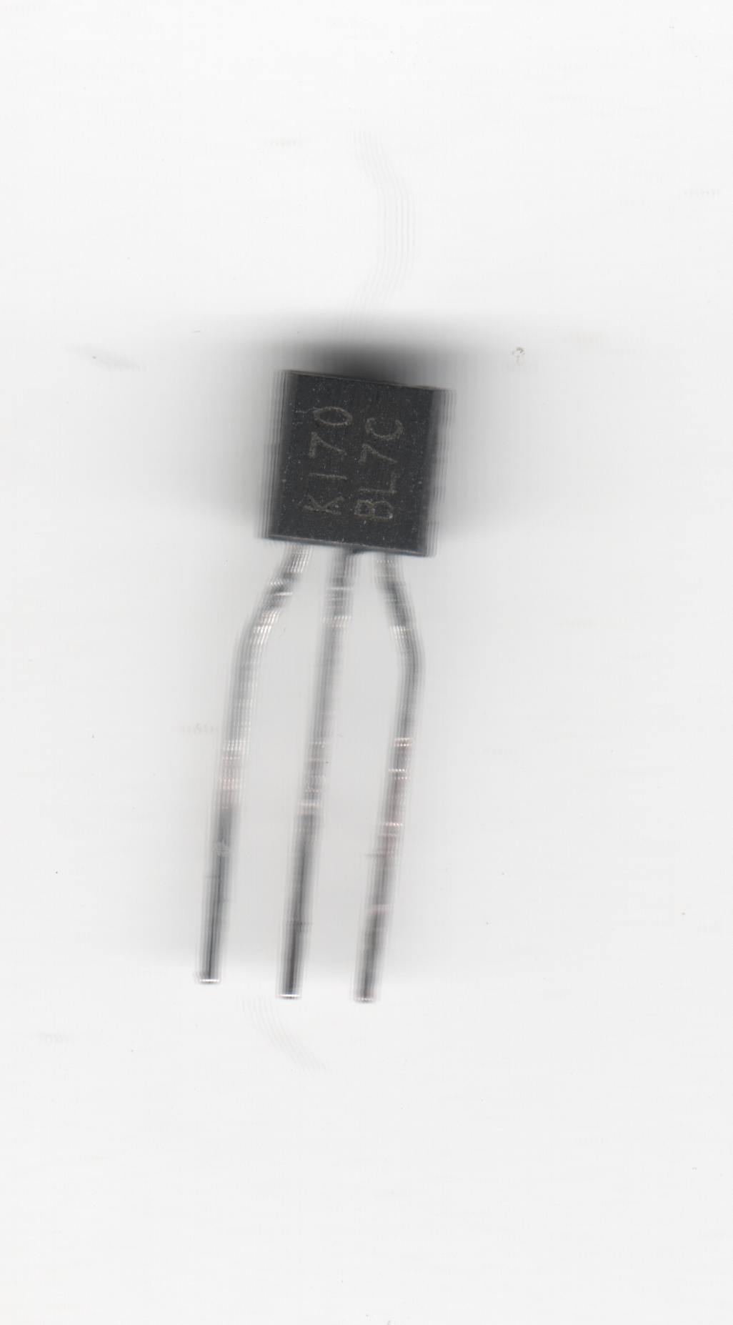

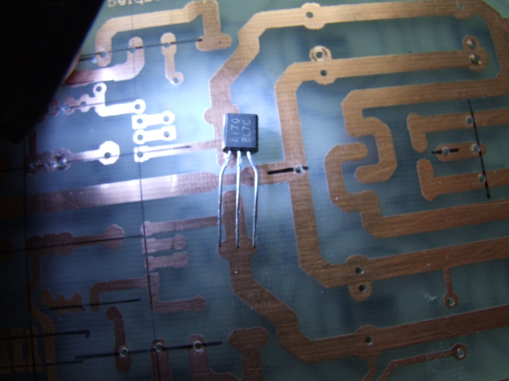

Show us a good macro picture of the JFETS there:
http://www.diyaudio.com/forums/parts/82638-my-transistors-original-copy-44.html
Little Buggers are not easy to photograph.
I've tried my best - see what you think.
They definitely look "brushed" to me. That would be my first clue that they have been remarked.
