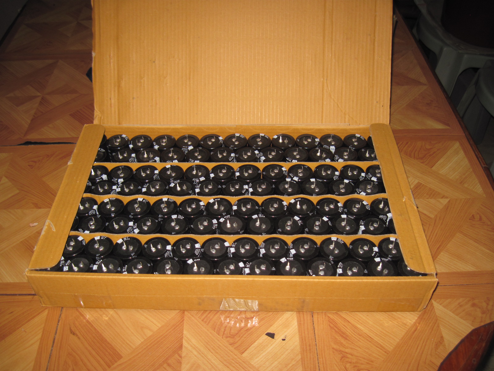

i get those caps from discarded atx power supplies and crt type monitors and color tv's...
i am all for recycling!

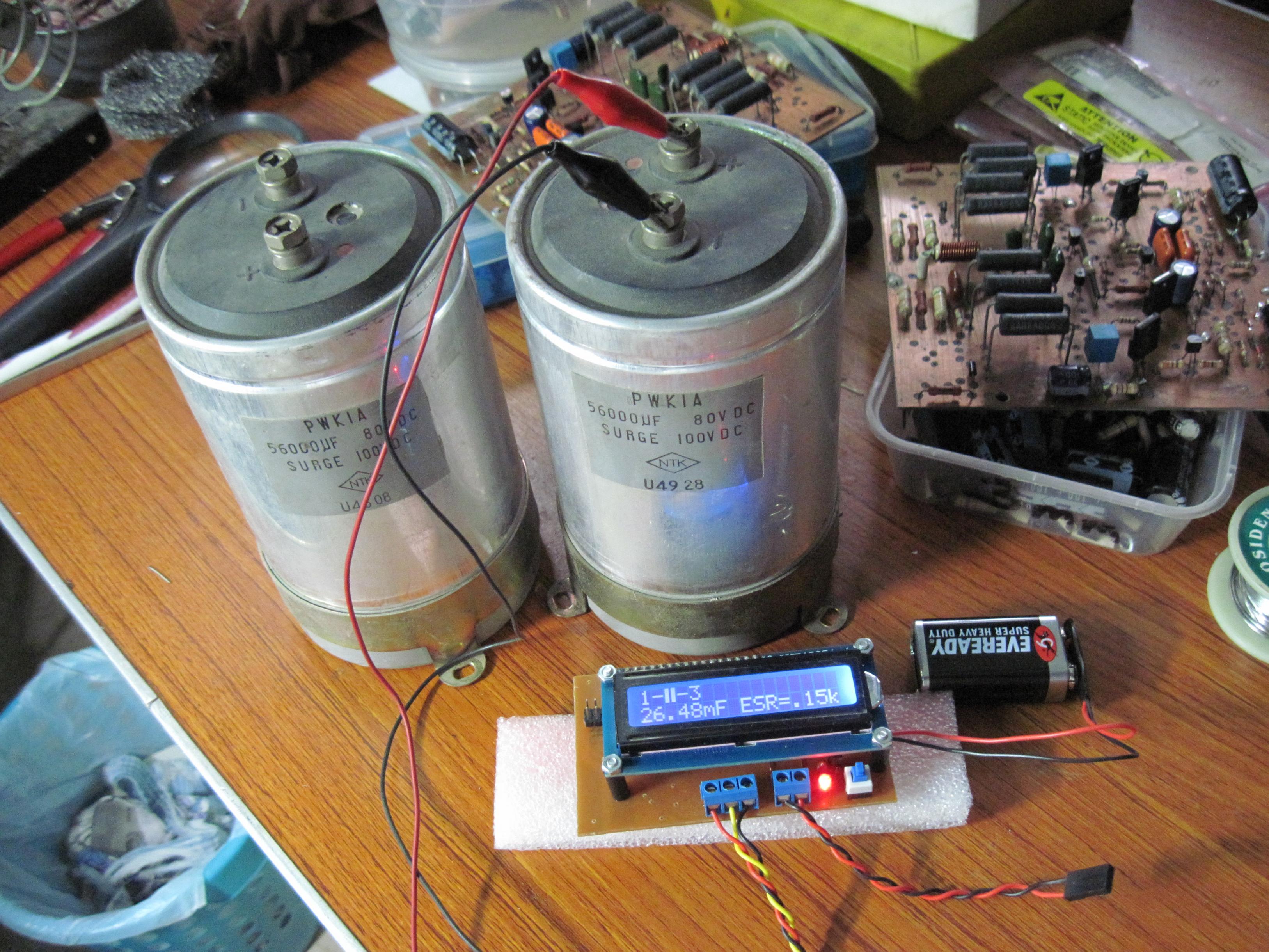

not more than 5-10 years old, as long as they test good,
i use a cap tester to measure and screen recycled caps....
i do not bother with small ecaps as they are cheap to buy new anyway....
i also buy new caps....
