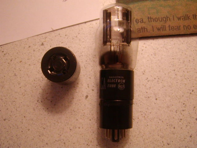

Rectifiers I have tried ...5Y3, 5AR4,5U4, #80, and 83 My favorite is the 80
What type of adapter did you use for the 80 since its 4 pin? Those emission labs tubes look very well built but expensive.
8 Pin Bottom To Four (4) Pin Top Tube Adapter For Rectifiers
