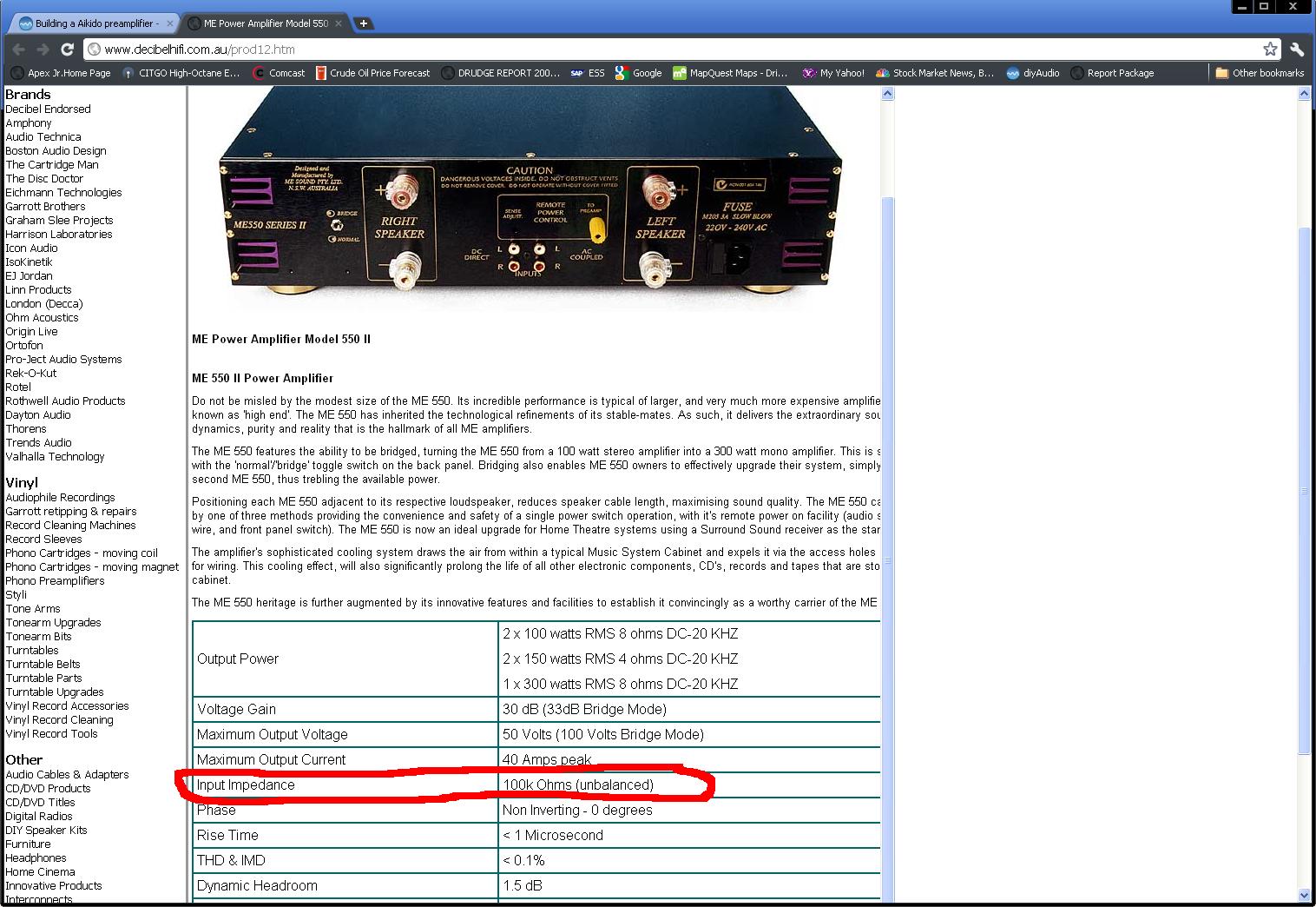

You may want to recheck that amp impedance. I though my ICEPower at 10k was low...
I don't think there is a tube in 2nd socket, or a paralleled tube that will get you 2 - 10 ohms.

I googled it and it says 100k unbalanced input impedance, not 10. The aikido will have issues driving it at 100k.

Its not 100K: but 1K input impedance...!
Hmmm, my eyes are failing me, as I see 100k on the amp specs...the Aikido will have NO issues driving this amp as designed with 100k input impedance.
Unless you modified the stock amp to have a 1k input impedance, but why would you do that?
....you are looking at the 'Type II'...., which does have 100K unbalanced, .....however, .... mine is the 'Type I'..., which has 1K unbalanced. How do I know? I was directly informed by the designer himself.
