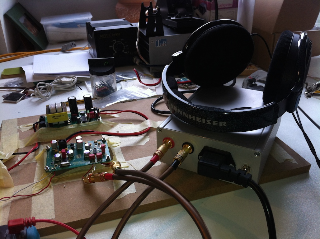

Hello,
My SUBBU DAC is finally playing music (see attached). I use the TOSLINK to connect it to my PC but I've got a problem with audible hum/noise. When source is muted the output is nearly silent but starts to hum as soon as the audio signal is present. The hum is not loud and I guess it is there due to the ground loop introduced via TOSLINK power GND which is common with the DAC power GND.
You may wonder why to use TOSLINK at all and have the trouble? The answer is simple - I have not a single source which has coaxial SPDIF output...
So could someone advise me how to solve the ground loop problem with a minimum effort? I already explored the possibility to use pulse transformer to isolate the TOSLINK module from the DAC risking to worsen the SQ... or install a separate set of rectifier+smoothing cap to power the TOSLINK. Actually I am not sure if the last option would provide enough isolation to break the ground loop either...
Any idea which helps to get rid of the ground loop but does not require using separate PSU is welcome!

OK, just tried powering the TOSLINK adapter with the battery, so no ground loop of any kind. The hum is still there. It has the form of digital packets interfering with the analog side. During the silent periods while playing music - almost no hum, but as long as the music comes out the hum rises to. So now I am really confused as to what can cause digital signal interference with the analog side?
My system is:
PC optical out ->TOSLINK adapter + SUBBU DAC -> MyRef Fremen Edition -> Zaph ZDT3.5.
The volume is controlled by the PC, so DAC to amp runs at full swing...
Any idea as to where to look for solution is welcome!
OlegSh

Please disconnect the PE wire from the superfluous PCB in the middle and test if things are OK. Your case already has PE connected to it for safety.
If still not OK then please disconnect the blue wire from the Toslink PCB and test.

Hi Jean-Paul,
Thanks for the hints. I've tried it all already before posting here. That little superfluous PCB is the ground loop breaker. It has a 35 A capable bridge rectifier soldered underneath. It works as intended but even if disconnected makes no change to the hum.
May be it is SNR problem due to the low output volume from the PC? The hum level does not depend on the volume setting. It is either present together with the music playing or it is absent when there is no music but it does not attenuate with the volume setting...
So the problem is still there...
PS: and what is the problem running DAC to amp without a volume pot?
The ground loop breaker is normally used at the power amp. All connected devices can/must have their cases connected to PE but signal GND can be kept "lifted" from PE. I even keep signal GND of sources floating and never have ground loops but many will condemn this for some reason (while being fully legal here). Signal GND is connected to the power amp by means of the RCA connectors of all sources anyway. Maybe your power amp has a small GND loop problem that only turns up when driven "open" ? Try another power amp if you have an extra one.
