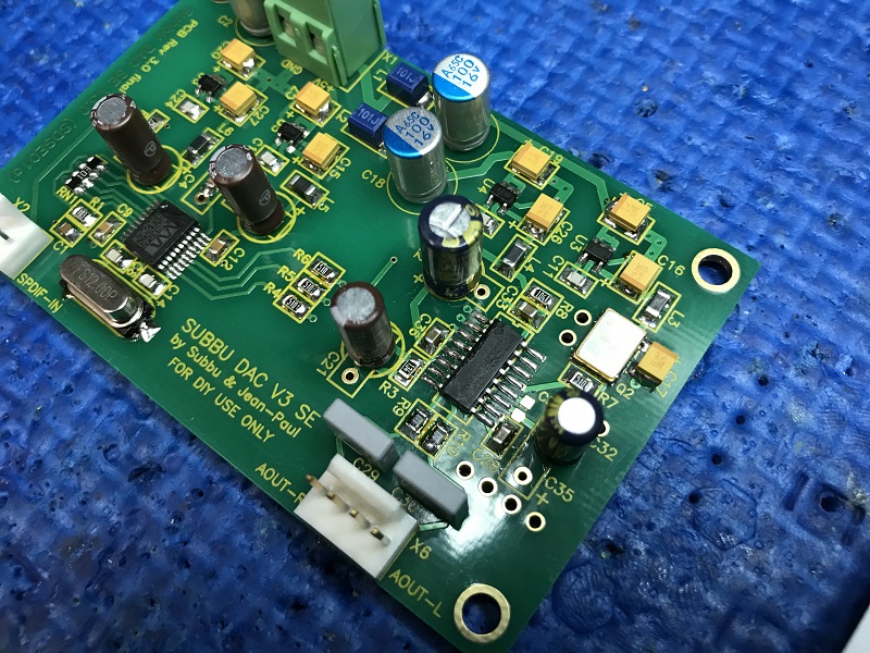

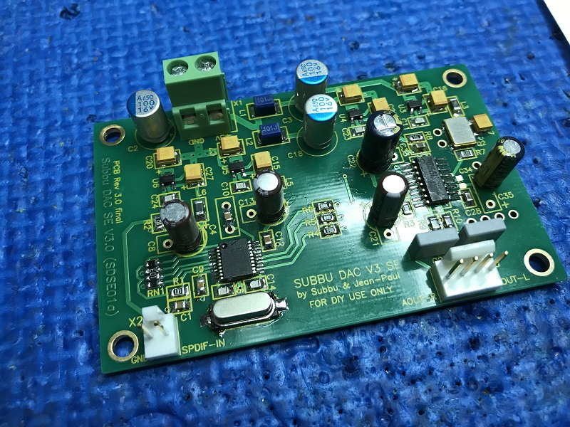

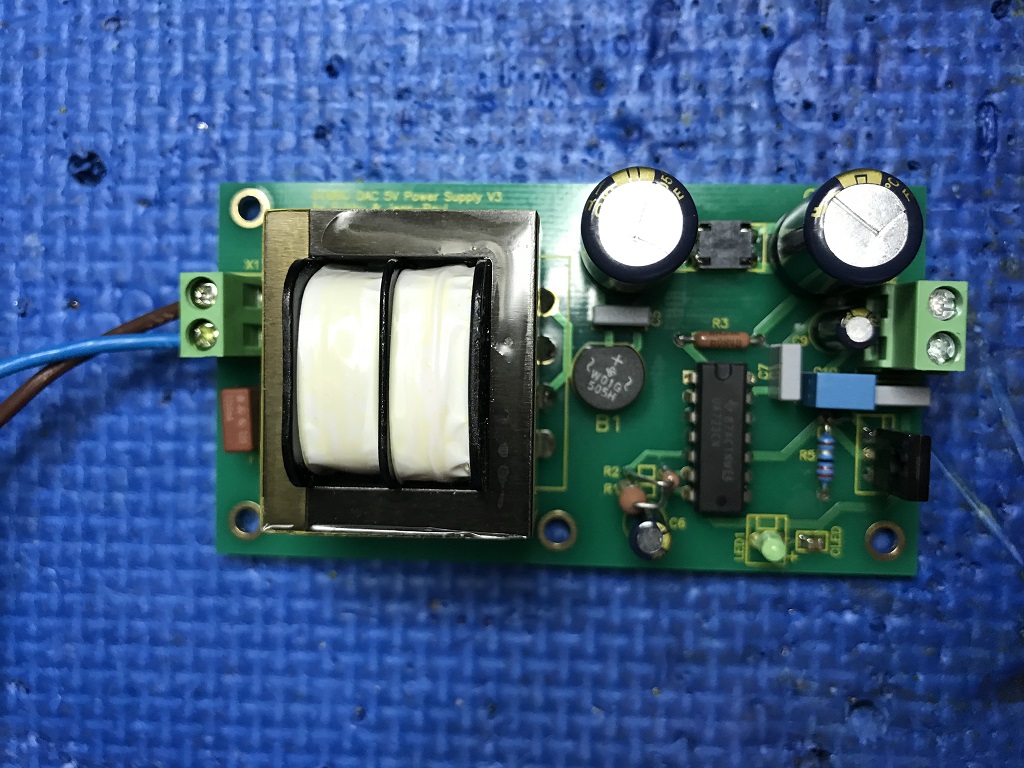

Here's a build I just completed for someone who bought one of my three sets of Subbu PCBs
All in all, a very fun build! Sounds really good too! :)
All the best!

Nice built. I have looked over my subbu dac for any upgrades or modifications to my initial built and have made sure that i fix the C7 orientation cap. for what it's worth is the C7 capacitor orientation in your built needing to be fixed or..... ? according to the picture in page 1 of this tread ?

I have an unpopulated PSU PCB if you'd like. PM me if interested.

I recently had the DAC board a few months back. Built it for a friend and the project called for a larger PSU... hence the extra PSU board.
