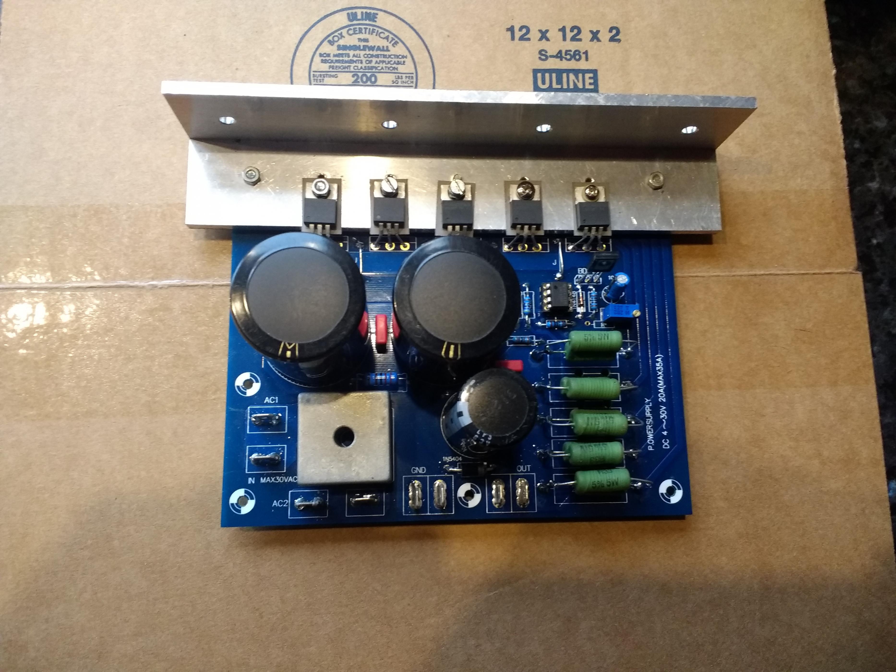

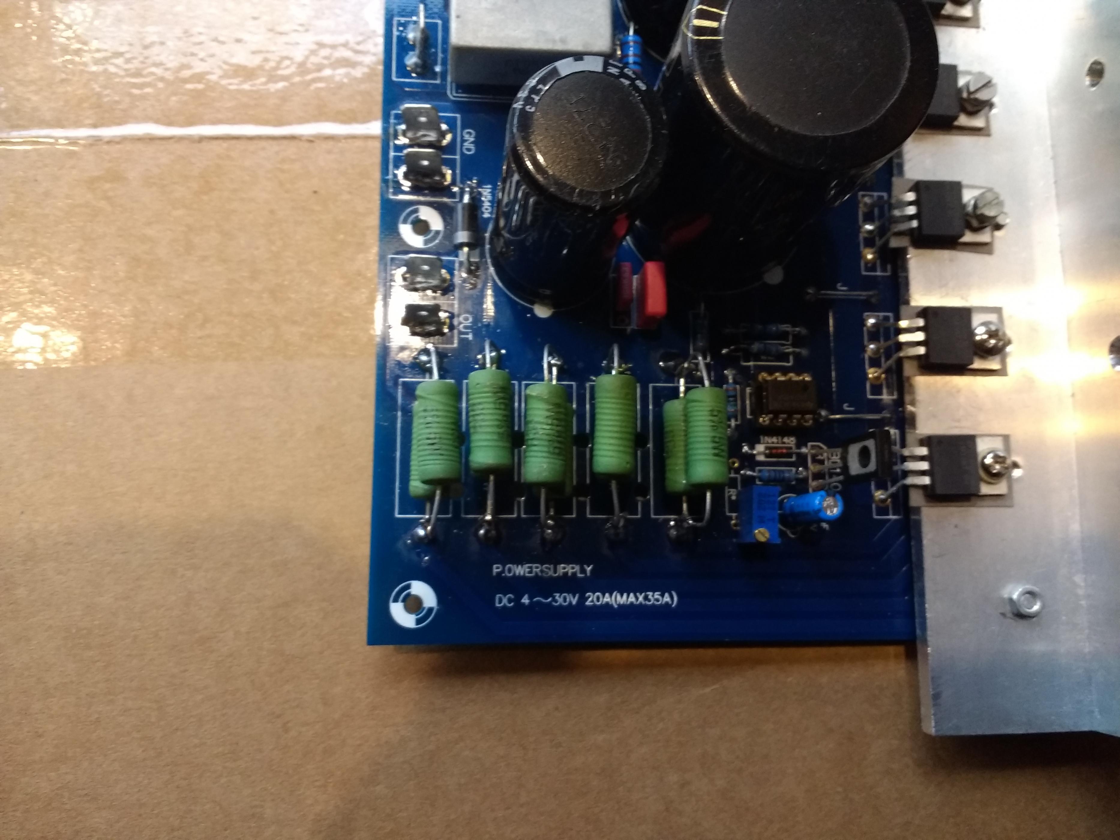

I'm planning to test my MoFo with this PSU
It has after the retifier bridge 2x 22000µF caps
PSU is already tested and adjust with an output of 24 Vdc under load

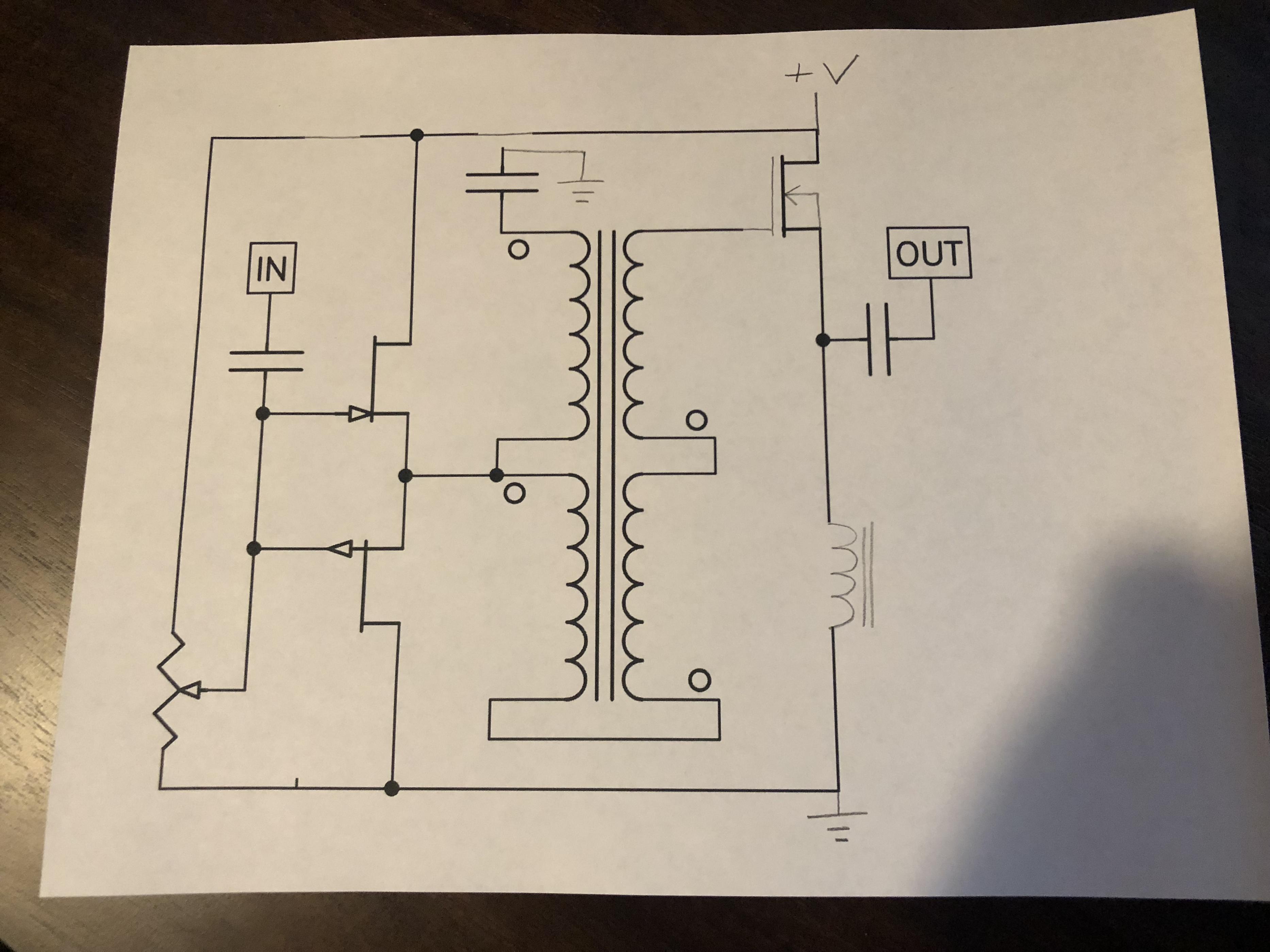

Or maybe in the style of SIT-3
I think the circuit from Post #637 is going to be noisy if you try to use that with a laptop switcher. It'll be fine with a nice quiet supply of the linear variety though.

Isn’t this like an M2Fo? Although I feel an extra 3x gain on low noise low distortion preamp is preferable to a signal trafo that pickups hum and generates its own 3rd order distortion. I have used M2 with dual 24v smps and it was quieter than linear trafo.

The SIT-3 circuit as originally posted has the positive rail nailed to ground. Nelson notes that the noise rejection of the Vfets is not great and this is one way of ensuring that the supply on the drain is quiet. Or at least I think that's the deal.

point is having clean rail (GND ) at VFet drain , and wiggly rail at VFets's source
everything else referenced and de-coupled to clean rail
