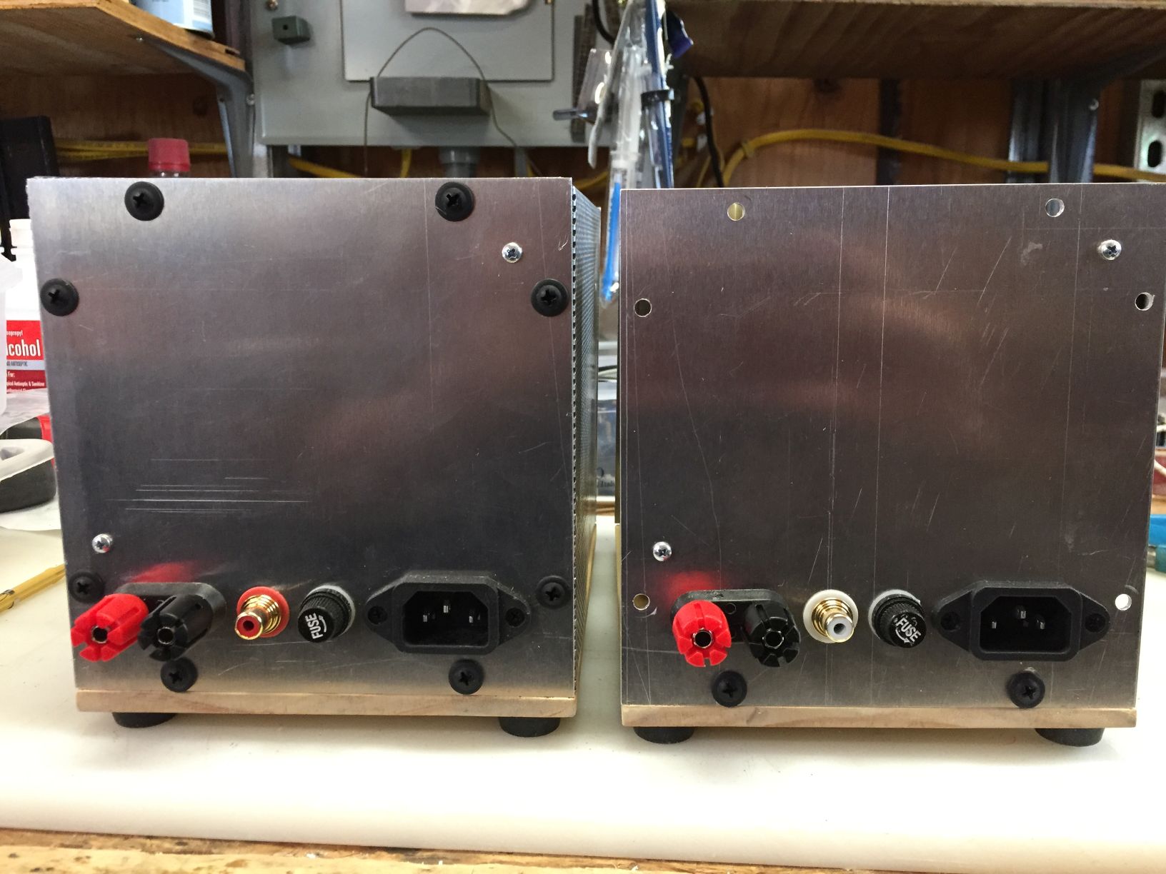

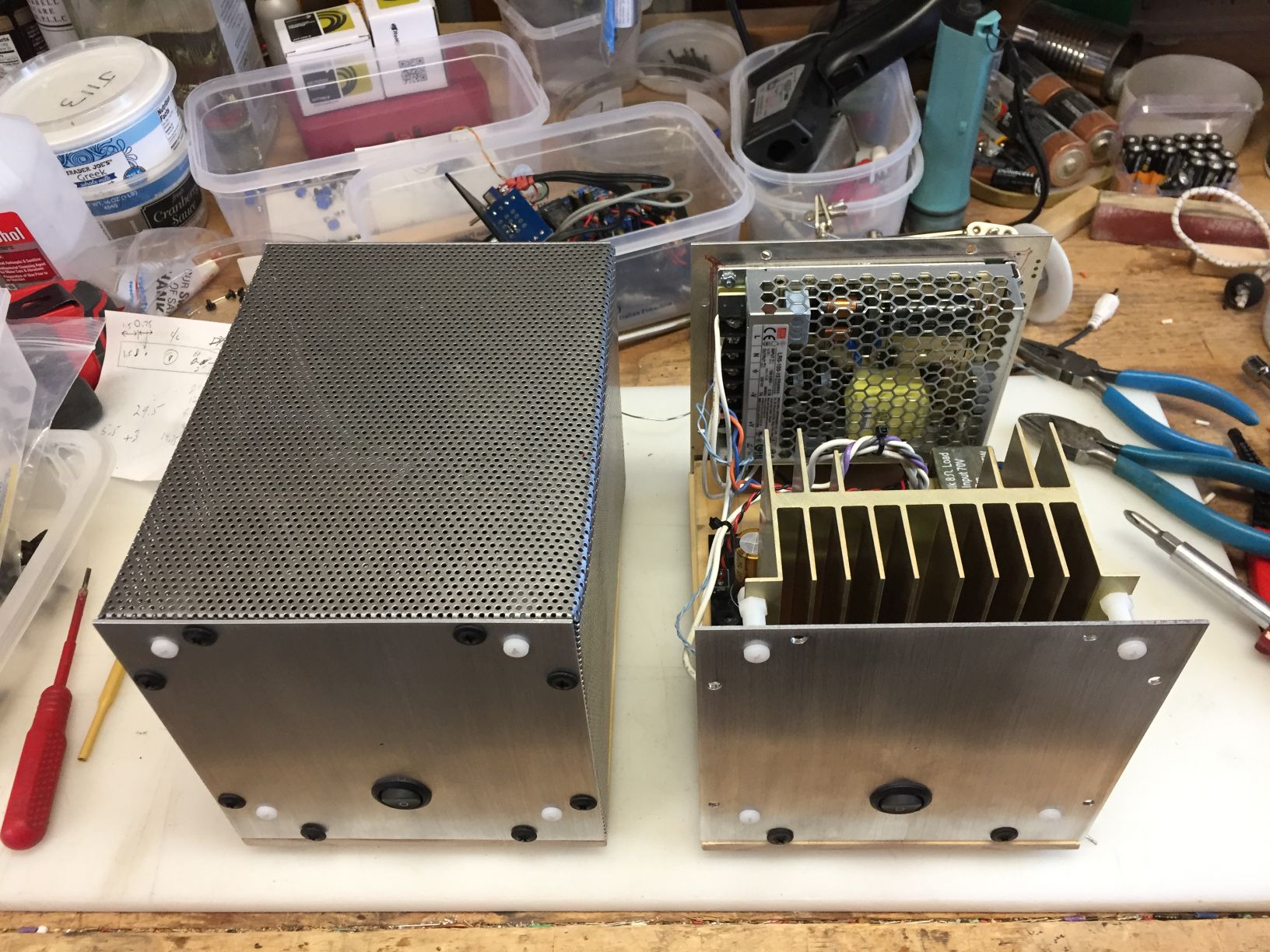

Here's my build:

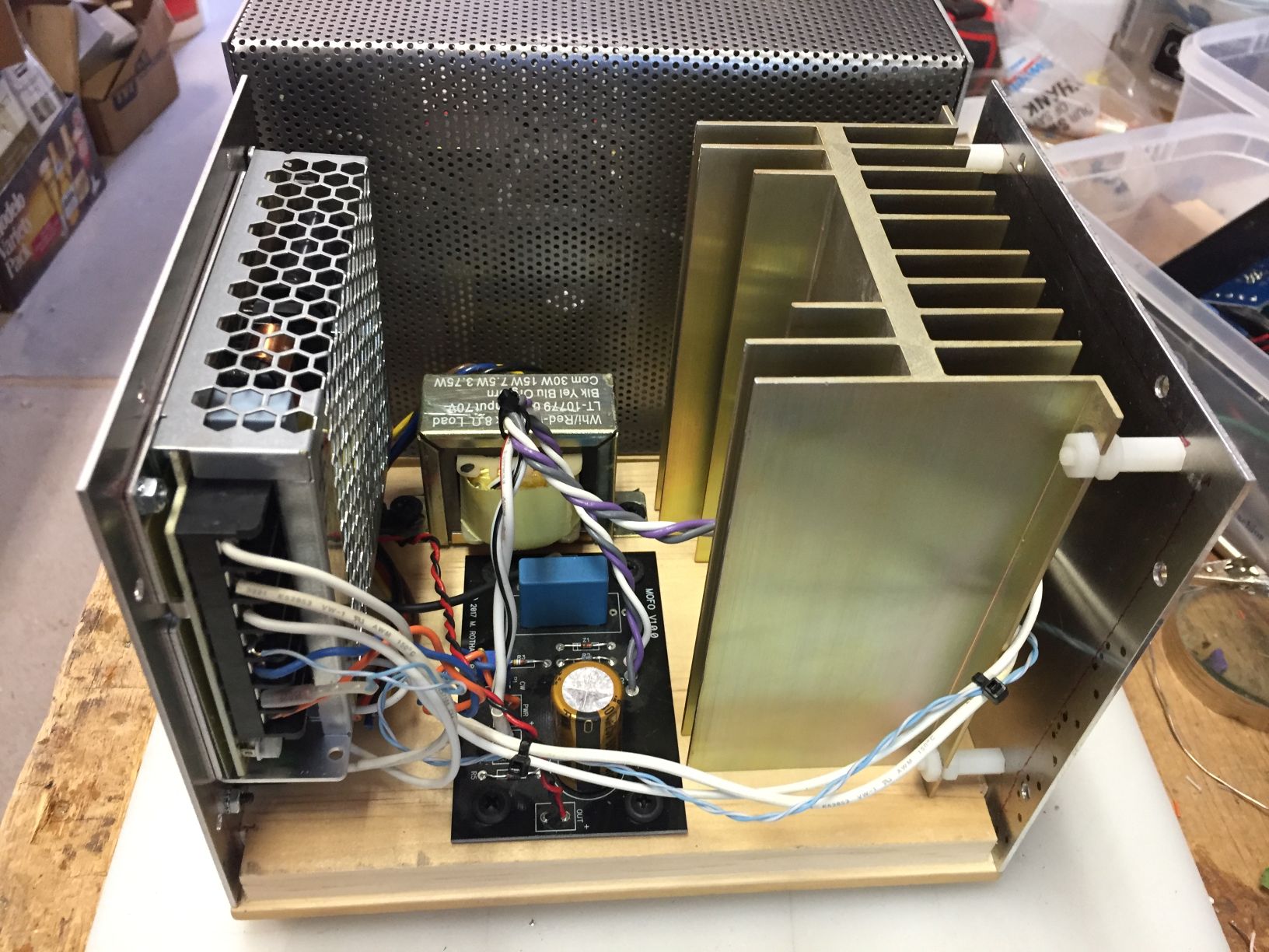

A home brew monobloc chassis for each channel, with:
MeanWell LRS-100-15 100 watt power supplys set to 18VDC (only $16.00 each, what a bargain!)
Junk box high quality 30 watt 70V loudspeaker line matching transformers, using the 8 ohm secondary as the choke. Surprisingly similar to Hammond at 0.6 ohm DCR. At 18V, I biased with a 1 volt drop across the choke for 30 watts.
Crydom HE-54-5.5 Heat Sinks, Canadian surplus, $13.00 each including freight on eBay. Although similar, these are not Amazon's cheap chinese SSR heat sinks. Very nice aluminum extrusion. Spec sheet says 0.75 deg C/watt at 30 watts and measurements prove that out. At 30 watts bias, I'm running a relatively cool 58 degrees C at the transistor case after full warmup.

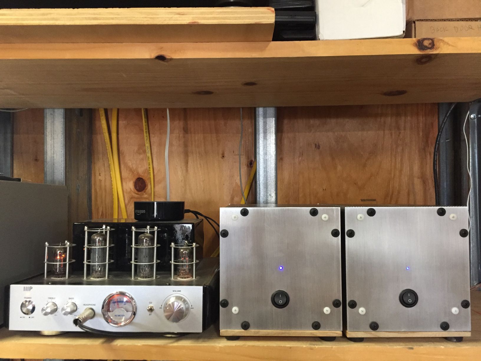

I'm driving them with a tube-hybrid el cheapo $99 Monoprice amp using the headphone output. Much better sound than the hybrid's built in chip amps.
Scope shows some very slight deformation of the sine wave starting below 40Hz. Obviously the 70V transformer "chokes" are the limitation. But the sound is fabulous and the ancient Braun 5.25" 2-ways don't go that low anyway.
A shout out to Zen Mod - enjoy BA 2019 - wish I could be there, maybe next year....

I think Zen Mod is more concerned (big word that is) about some holes underneath the heatsink itself to facilitate vertical air circulation than the cover (which is perfectly fine and looking nice as well, at least to me)...
