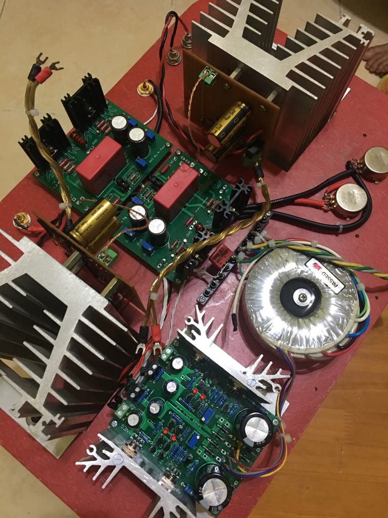

I just finished my MOFO + BA-3 integrated amp. It is a beautiful sound amp ,like tube but don't be worried on degradation. Thank you Michael.

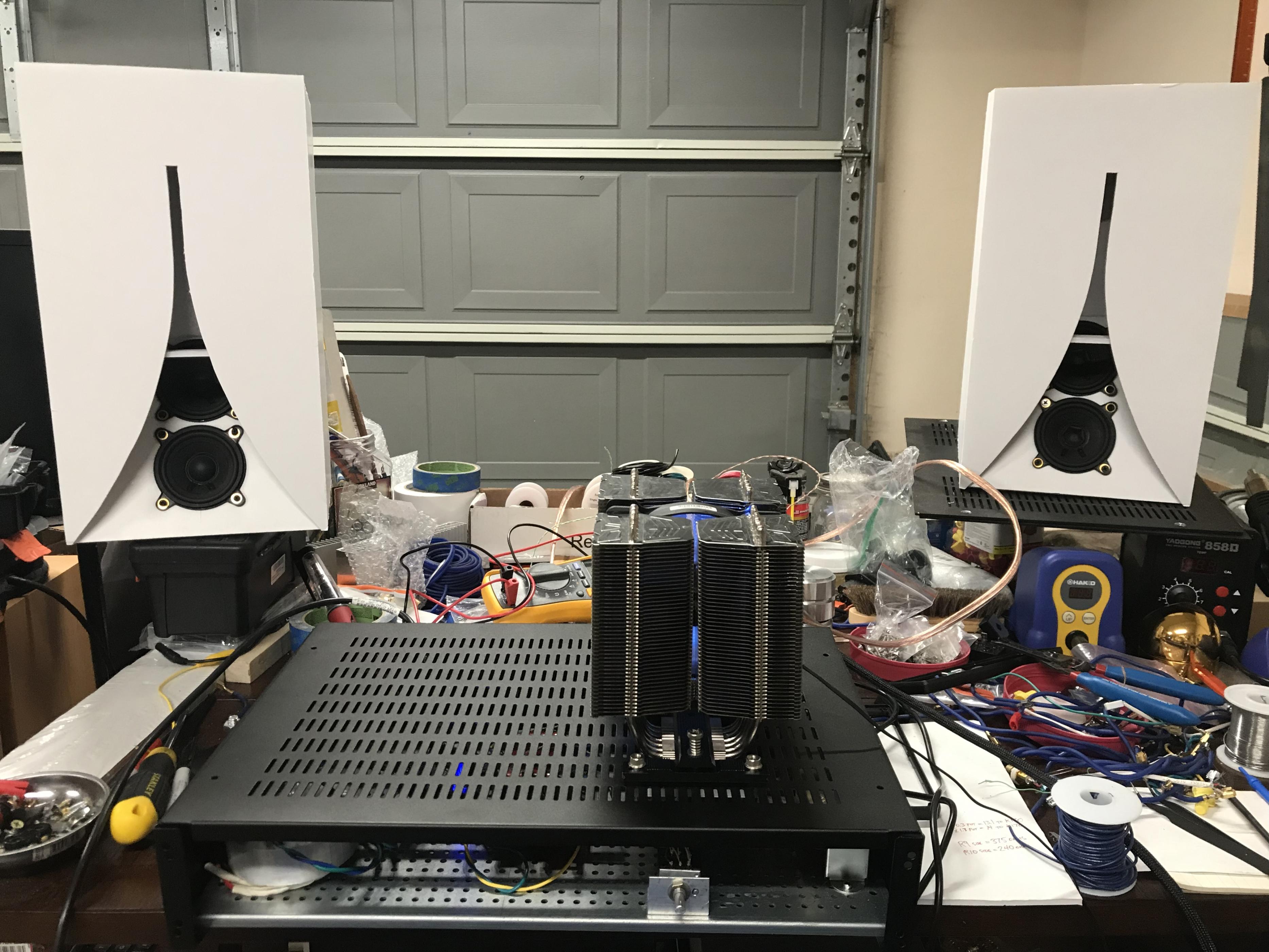

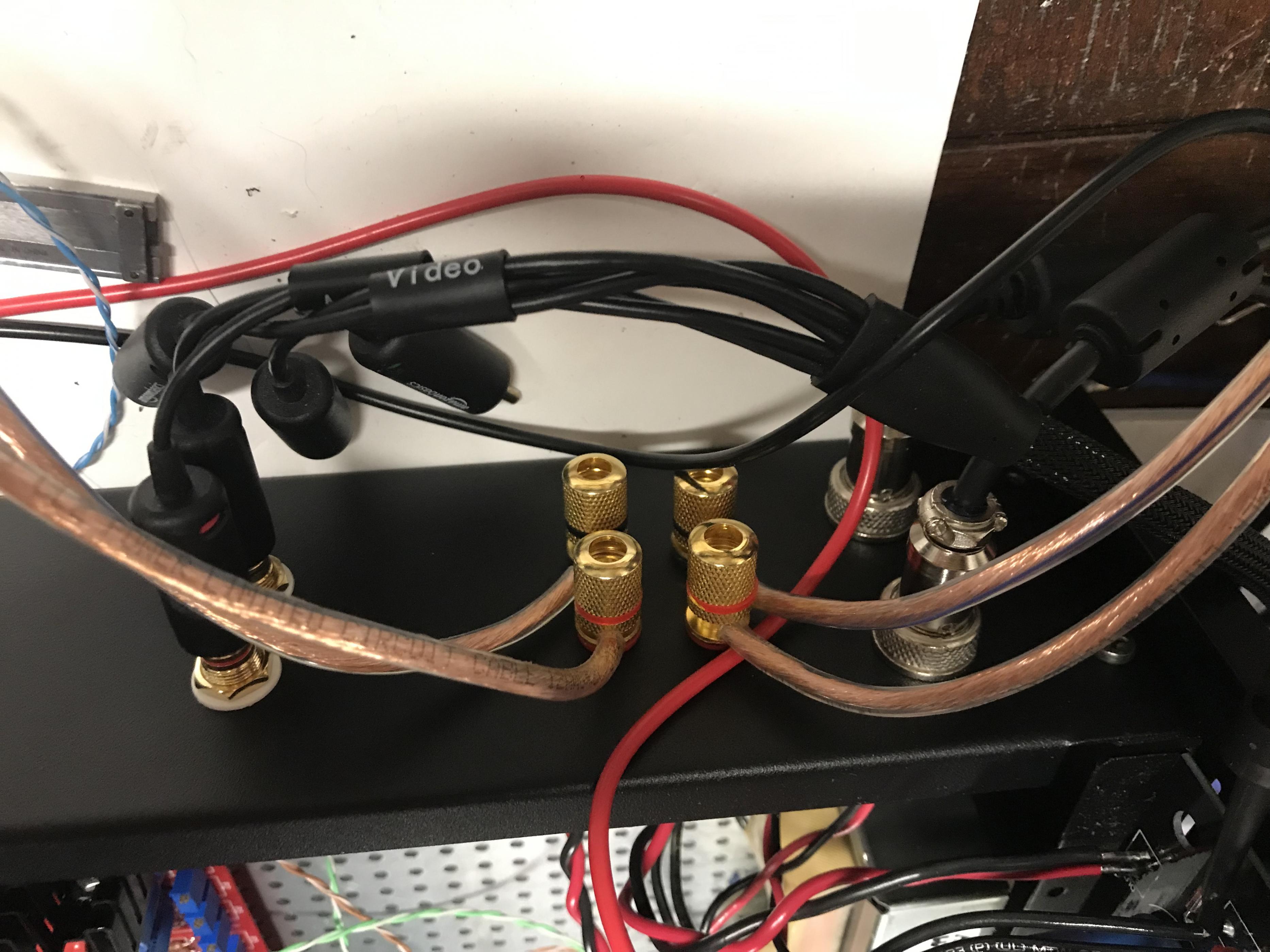

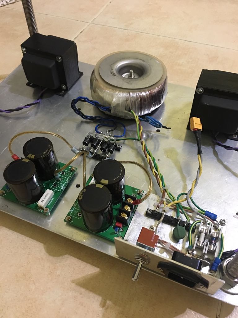

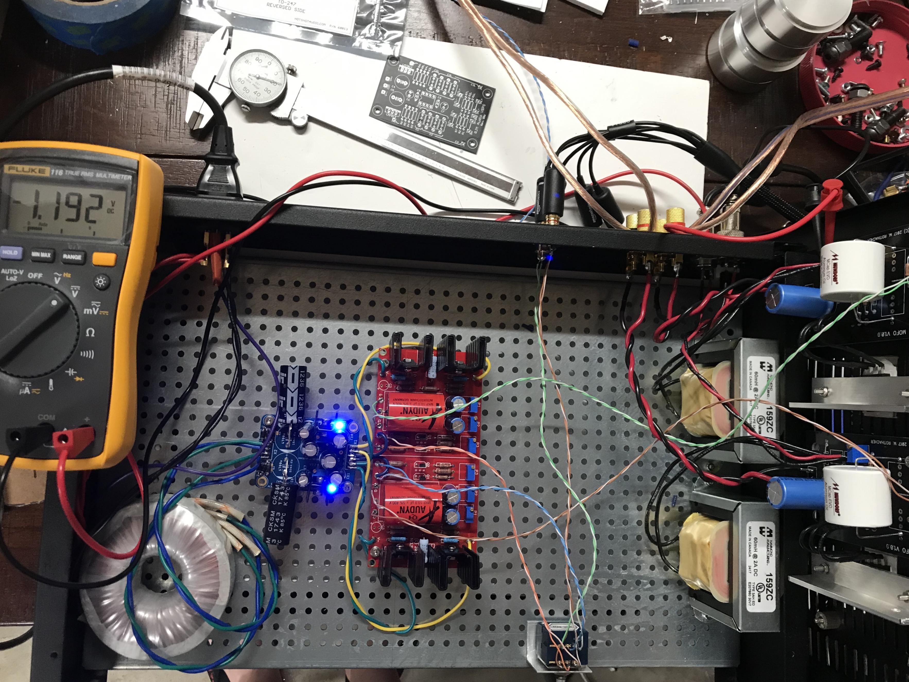

Another MoFo Up and Running
After a short hiatus I jumped back on my MoFo build. Got it up and running today along with the BA3 Preamp. The combination sounds great so far. Playing on my 0.53x mini-karlsonators the BA3 and MoFo go plenty loud. The combo is also dead silent with no turn on thump. This is turning out to be a great integrated project. Still have to get the phono stage soldered up but that’s another project for another day. In the meantime I’m going to get some more listening time on the MoFo. Thank you Michael for a fantastic amplifier and thanks again to 6L6 for the BA3.

@thompsontechs from the BA3 thread. The CPU coolers are Megahalems by Prolimatech, LGA 1156 type. I believe there good up to 120 watts of dissipation each. The heat pipes barely get warm with the MoFo biased at 1.19 volts at the 159zc inductors. I still have to add a resistor to take down the fan speed to ultra quiet.
