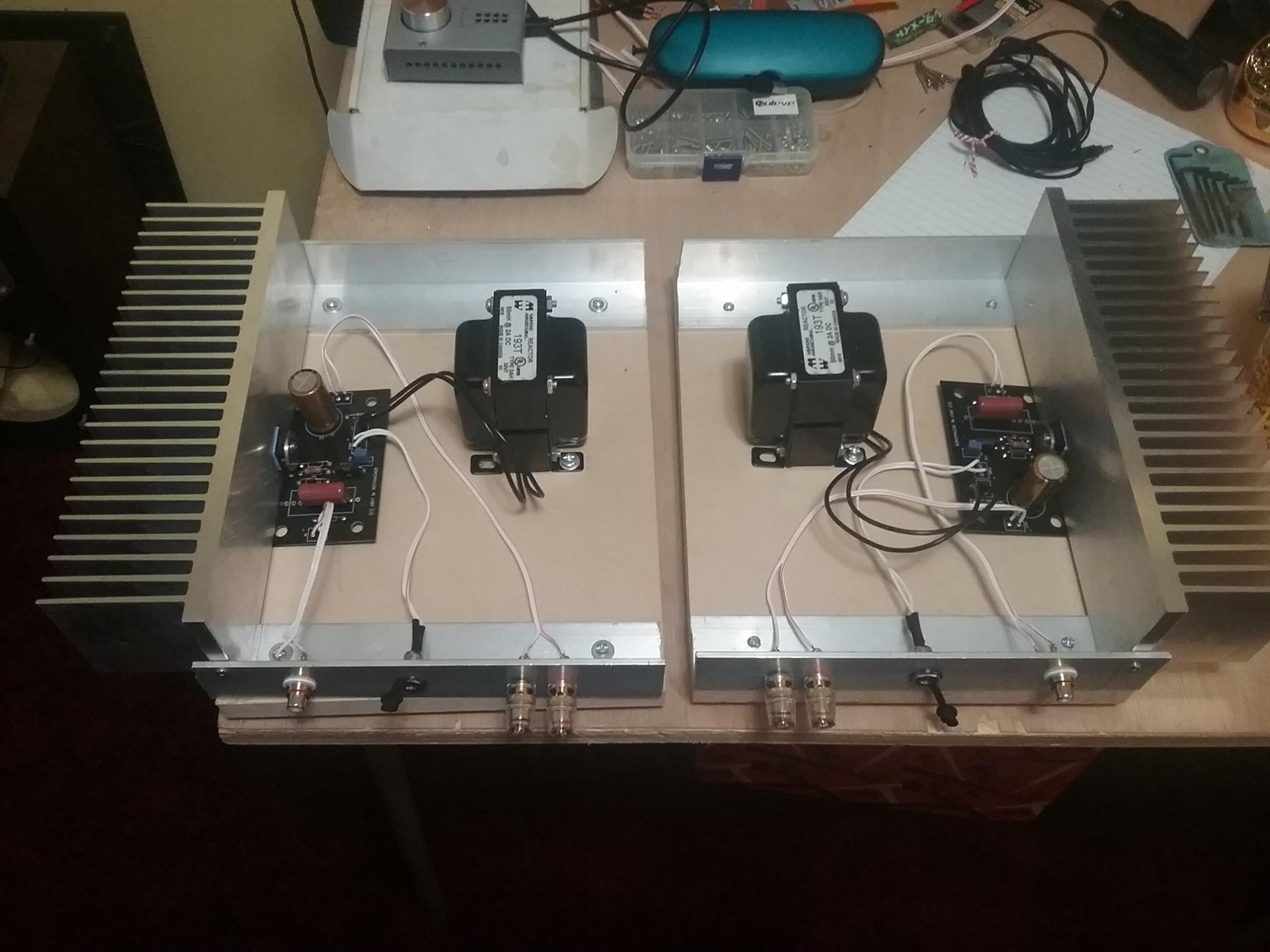

My MoFos keep blowing up.
I'm not sure what's going on, but after listening to them for a while, something gives and the power supplies start cycling in reset mode.
I built my MoFos to specifications in MichaelR's original PDF, with IRFP250 MOSFETs, and Hammond inductors model 193T (50mH @ 2A DC). My DMM reads DCR=0.6R for each inductor.
Power supplies are, admittedly, no-name laptop types that claim to output "19V == 4.75A". My DMM reads 19.5V and 19.4V respectively.
When biasing them, I assumed the published resistance 0.8R (because I don't trust the DMM reading), and so set the voltage across the inductor to 1.02V. If anything, I would think this to be a "conservative" setting if the measured inductor resistance is to be believed.
I just now labelled them "A" and "B" so I can tell them apart, so I can't tell for sure if the non-functional one is the same one each time.
I suppose I could have ordered or received the wrong part in my original order; I didn't check the resistance on each component before installation. And I don't know how to check capacitance or inductance without an LCR meter.
Can anyone help diagnosing what to look at next?

I found my MoFo voltage drop goes up as the unit fully heats up. It might start at .8 volts and rise to 1 volt or more after an hour. I ended up doing some listening tests and my MoFo still sounded good when set to a max rise to .9 V after 1 hour of cooking. When cold, it read about .7 volts.
FYI I am using heat sinking at the bottom of the recommended range with 18.5 volt 100 watt supplies. IR gun thermometer readings are about 60 degrees C at the Mosfet plastic case when fully hot.

I realize now that my previous post was unclear. Only one of the channels has died, but it has happened twice.
@Zen Mod, I can get my DDM in series with the inductor, but I feared it would affect the bias current, especially since the inductor DCR is so low already and the DMM reports 14% lower resistance than the manufacturer lists (0R6 vs 0R7). I had similar qualms about using the low resistor.
Unfortuately, I am unsure what qualifies as a "proven supply". Mine appear to be the "NANTO" brand, model SK90190474. I've seen the brand "Meanwell" mentioned hereabouts, but in both the 'pro' an 'con' columns. Any suggestions of models for Reliable PSUs would be appreciated. I'm considering a single PSU capable of handling both channels.
@avdesignguru, I have been re-setting bias as the units heat up as indicated in the original article. I reset at 15 min, 30 min and 60 min. Perhaps I should try dropping to 0.9V and see if that helps.
@vdi_vienna Good question; unfortunately I'm not sure it's the same one, as I didn't mark them. Lesson learned. I replaced the pad with new. I bought what were claimed to be "thermally conductive silicone" material, 30mm squares.
Waiting for replacement parts, so it'll be a while before I can get Channel B back in service.

Hi Vunce,
It seems to me the MOSFET did blow out. Rds dropped to something in the K range.
IDK about "inadequate", I have 10" of 3"x3" fins. Perhaps I should have gone taller, not wider.
