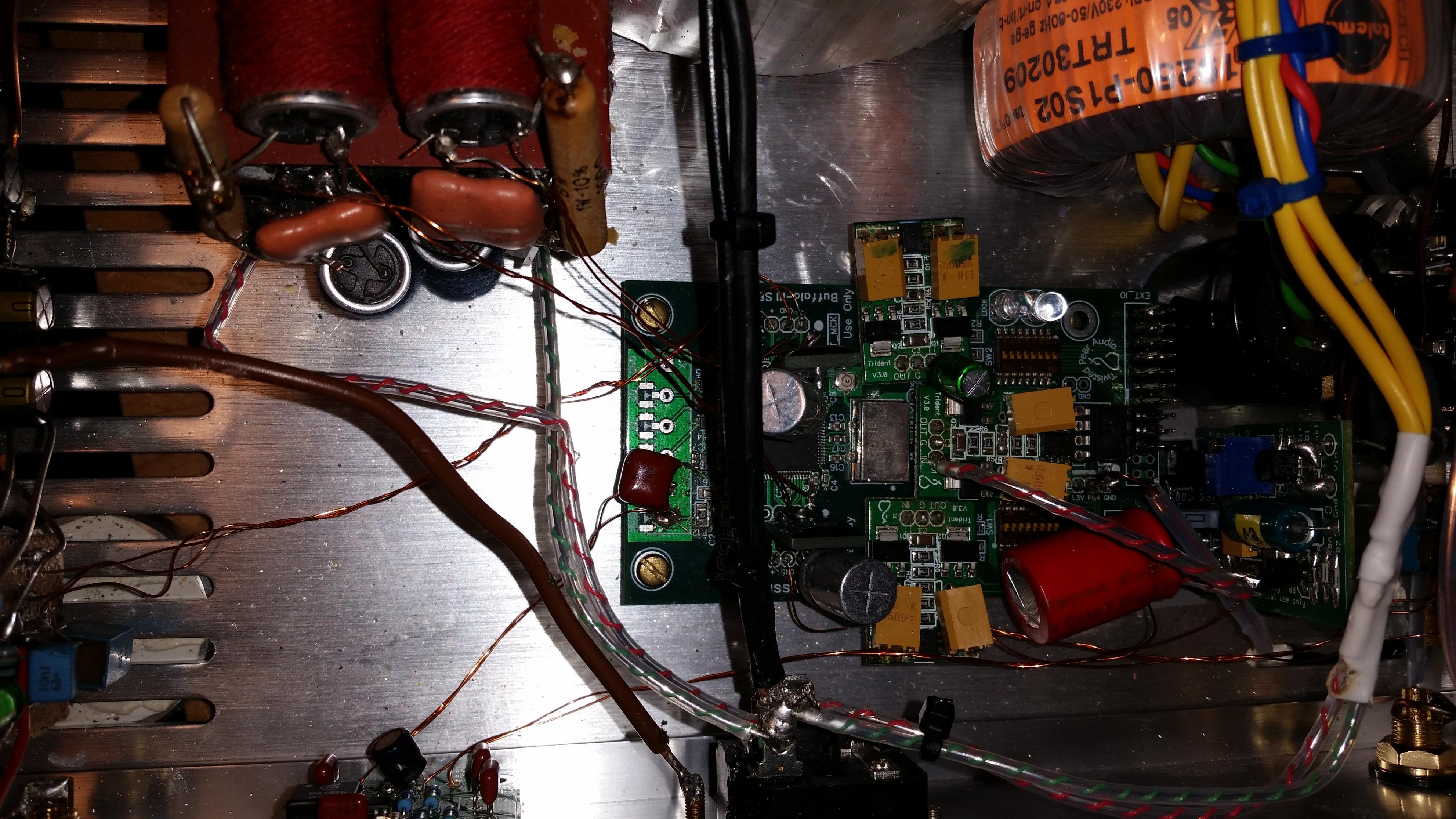

Tape Echo, I have a Denon 3910 that I modded to export I2S (CD) and DSD (SACD) using Twisted Pear Teleporters to send and receive to my dual mono BIII. The Denon swapped R and L channels playing DSD so I used a Twisted Pear OTTO II to swap the channels before sending. It is controlled by a mechanical switch on rear of the Denon.
SQ is excellent! Sorry for the poor quality pic...
