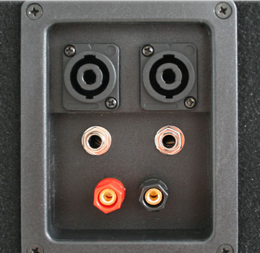

Hi friends, yesterday I bought some Malone PW-1222 speakers of 300Watt RMS, and in your connections has speakon input, speakon outuput, jack 6.35 two, and threaded terminals, what type of cable can I use? XLR and RCA board connections are audio inputs or speaker outputs? what are the audio inputs and outputs for speakers? so to be sure what kind of cables I should buy to connect to the malone, thanks

These are all highlevel amplified inputs. Run a connection from the outputs of your amp to one of these of your liking. I'd prefer speakon because it's the most reliable of the three.
But if I were you I'd bring the speakers back to where they belong. Maybe the junkyard. They're not worth the material they're made of. Horrible stuff.

XLR is input or output?

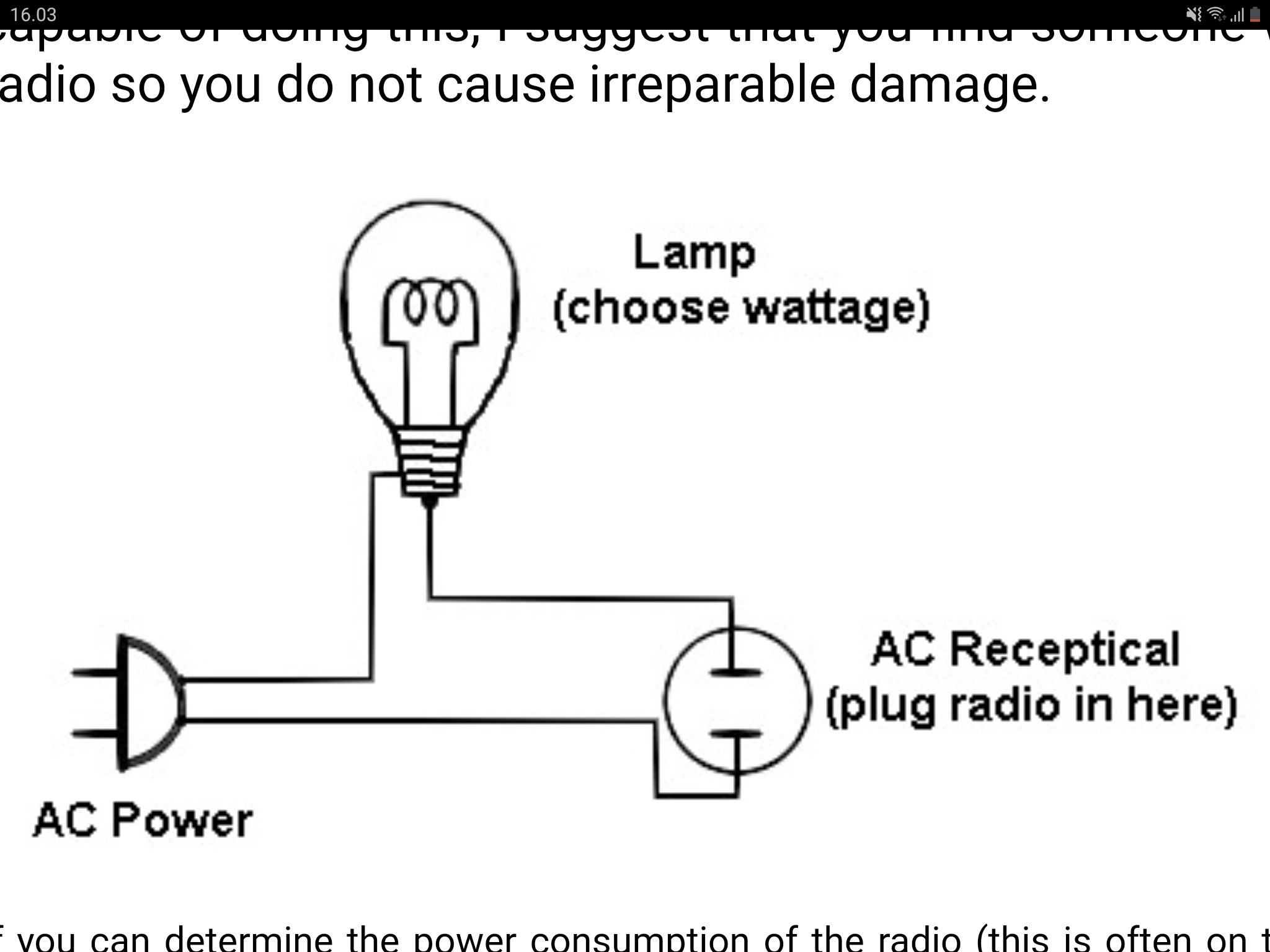

"Do not install the power tube before power-on and the transformer is connected in series. 60‐100W Incandescent bulbs, especially all SGND and PGND on the board"
What does it means? the bulbs are in primary o secundary of trans?especially all SGND and PGND on the board?

I think it connects in the primary
Hi.
Jose is correct, the bulb goes in series on trafo primary side, see attached pic.
And also it says you must try powerup without power transistors installed.
Good luck, check everything thoroughly first, bulb will light up briefly and then dim, that's normal, capacitor charging.

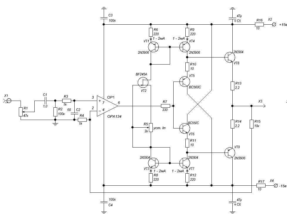

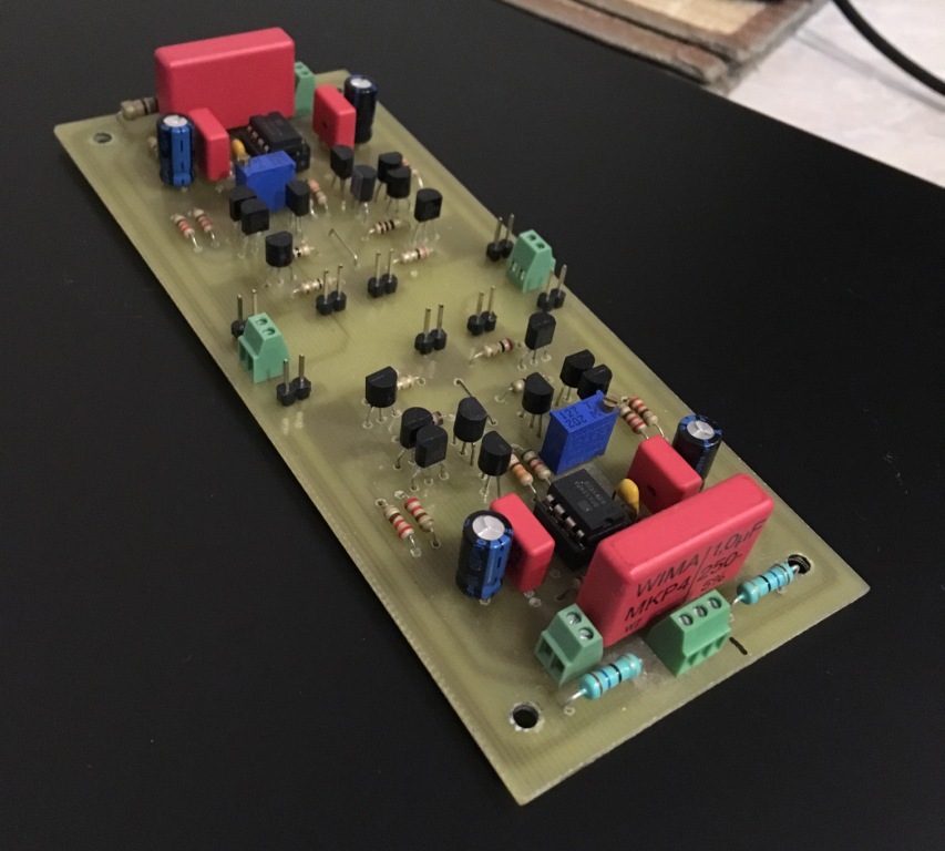

bobina if you look back to post #369 you'll see I detail all of the changes I made to the parts you mentioned. I made the changes because the PN100A/PN200A are obsolete. I know, so are the BC560C but I have a large stash of them, as do many other people. If you want current production devices then use the KSC1845/KSA992 pair ( with a bit of lead dressing ). I changed the resistor values so that the quiescent current of the VAS transistors Q5/Q6 was cut from 12mA to 6mA. At the original current Q5/Q6 were dissipating 400mW and ran pretty hot - now they run cool. To cut the loading on Q5/Q6 now that the standing current was reduced I used output devices with potentially 4x the hfe of the MJE172/MJE182. I've redrawn the schematic with my revised parts values and attached it to this post.
Thank you for the changes in the scheme. It is steady, temperature is normal. My opinion is not enough slew rate, I wanted more.

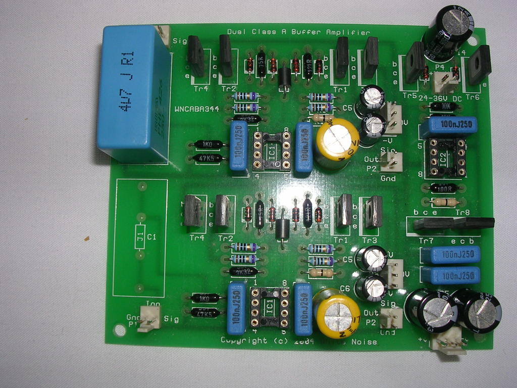

Here's my version. Components down the rhs are a rail splitter and capacitance multipliers. Designed to be run from a single +24V supply. I have used constant current diodes to bias the diamond buffers and two pairs of output devices in parallel on each channel. This is obviously my pcb for experimenting with.
Indeed, lots of possible variations on this theme. You can also use high voltage opamps like the opa445, or bootstrap the opamp power supply, to get higher overload margin. I like the constant current arrangement in your first schematic, it ensures that each half of the diamond buffer gets exactly the same bias current.
