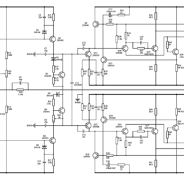

Hello chalky
Looking at your BrystonSmallInp.pdf schematic.
You did replaced the cfp vas by a standard vas and the Vbe multiplier by D3 D4 R14 for the bias.
Wy did you take out the cfp vas and the Vbe multiplier ?
Is it because cfp are less stable ?
Any others reasons for those changes ?
Thank you
Bye
Gaetan
Hello chalky
I forgot to say that my Bryston 4B SST clone do have cfp vas, I found out that there is other version of this clone with no cfp vas but with a standard vas.
Thank
Bye
Gaetan
I think you're talking at cross purposes here. My modifications were to the input board, not the power amplifier board. The schematic you've shown is for a simple push pull vas, not a complementary feedback pair push pull vas, in the power amplifier board. If the latter were true then both the upper and lower vas would be comprised of two, rather than one, transistors.
