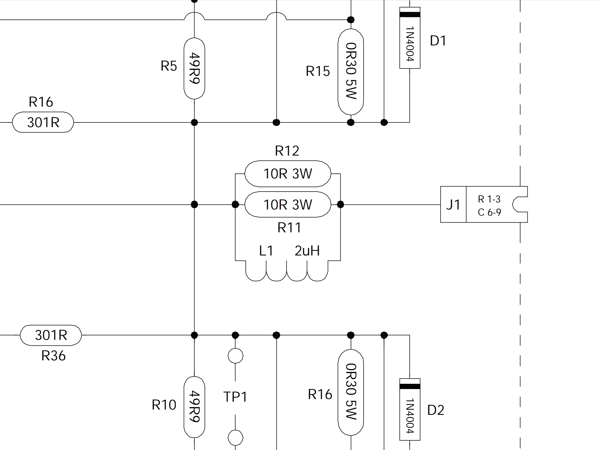

Coil is 2uh use a online calculator and do the math.

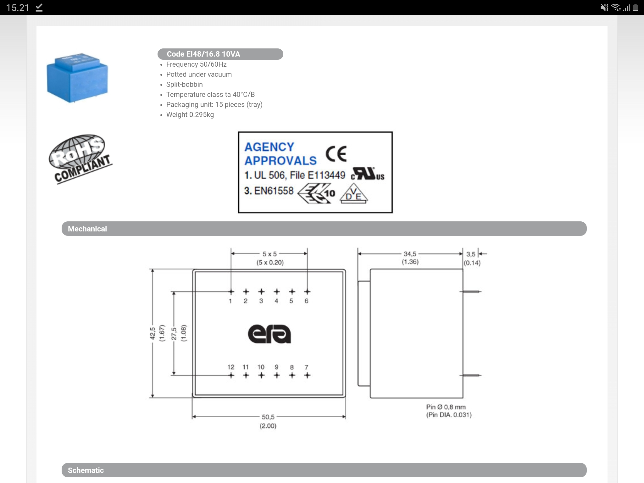

As to the small 12 volt transformer, I think it is a core el48 , but measure the pcb holes and find a suitable transformer, pcb accommodates different sizes, I used a old one I had, needed some leg bending but works fine
