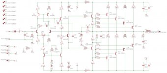

---a real VI limiter ( sense both V and I )
---active on the output and not the drivers ( ita has been mentioned that when the limiter is active the "load " might destroy the VAS stage )
--- and designed to shunt the P drive , on the lower rail transitor to rail and not the output ( ??? )
Questions are :
A ) is it possible to shunt the drive to the rail instead the output ?
B ) why the designer works directly on the outputs and not the drivers ? ( first time for me to see that ) any opinion if better or worst than the typical limiters we have seen so far ?

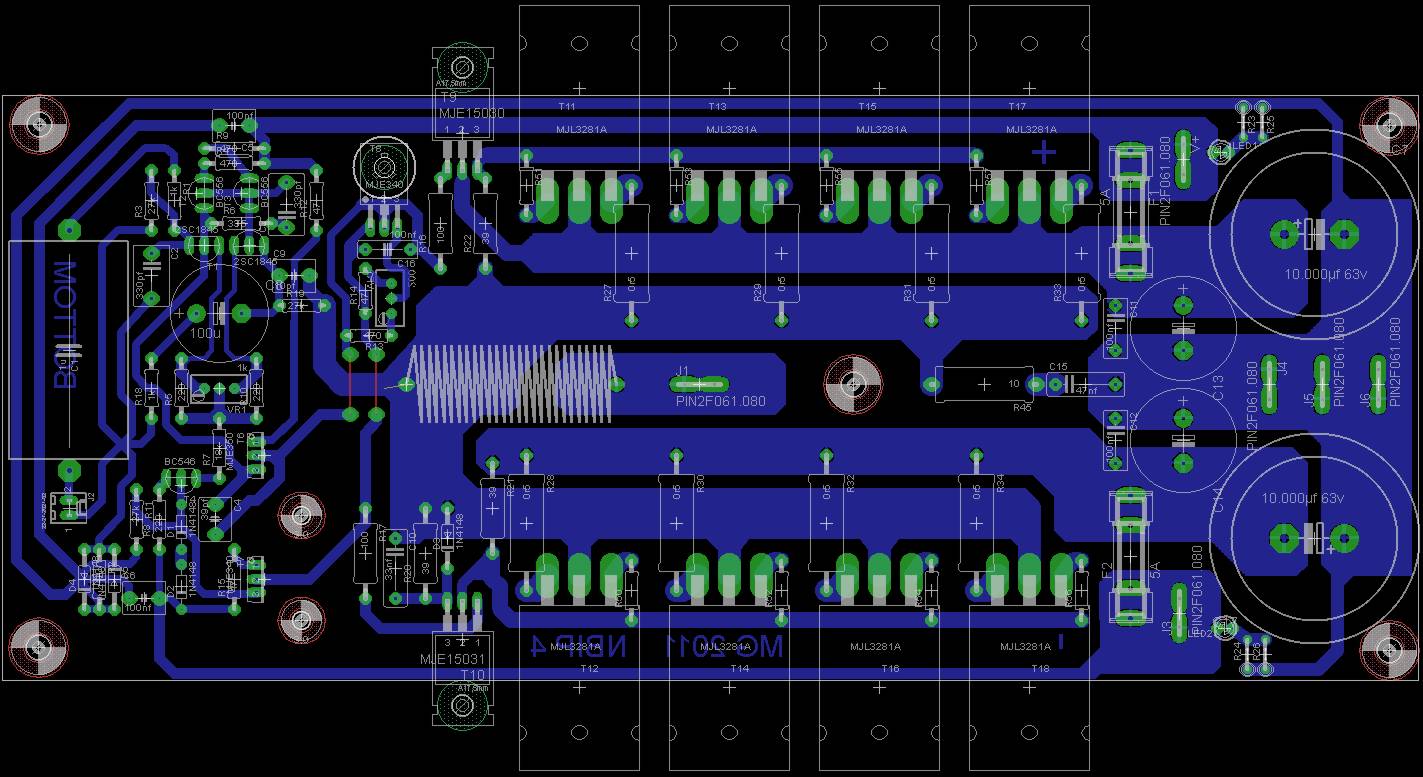

Next step i have, due drastic price reduction, The opportunity to purchase Rcore 500Va 2x36Va trafo. The price was so low that i finaly take five unit and will use 2 for Nbip (1 per chanel)
I built rectifier bridge to. The are base on On Semi Mur3020wt diode and rubish TO3 heatsink.
Futher i begin the case buiding : a wood and aluminium mix
Same spirit as my nmos 200 and as a little 6J6 preamplifier i am on building.
Next step will be 2sc1845 peurchasing and matching, and PCB etching for Nbip, Soft start and Speakers DC protection
Marc
Marc

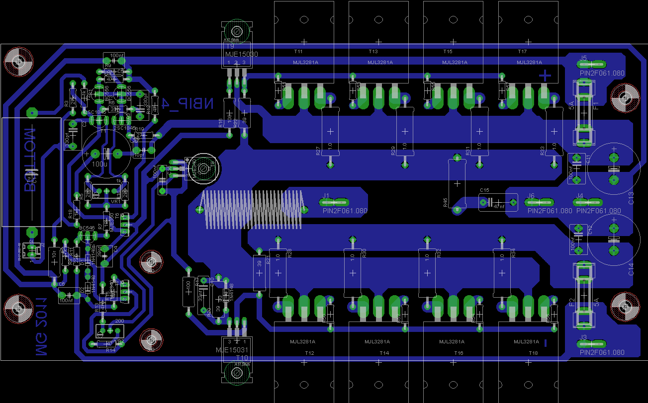

You need to invert the driver stage to allow the PNP quasi to work.
Thanks Andrew, so i need to check this more.

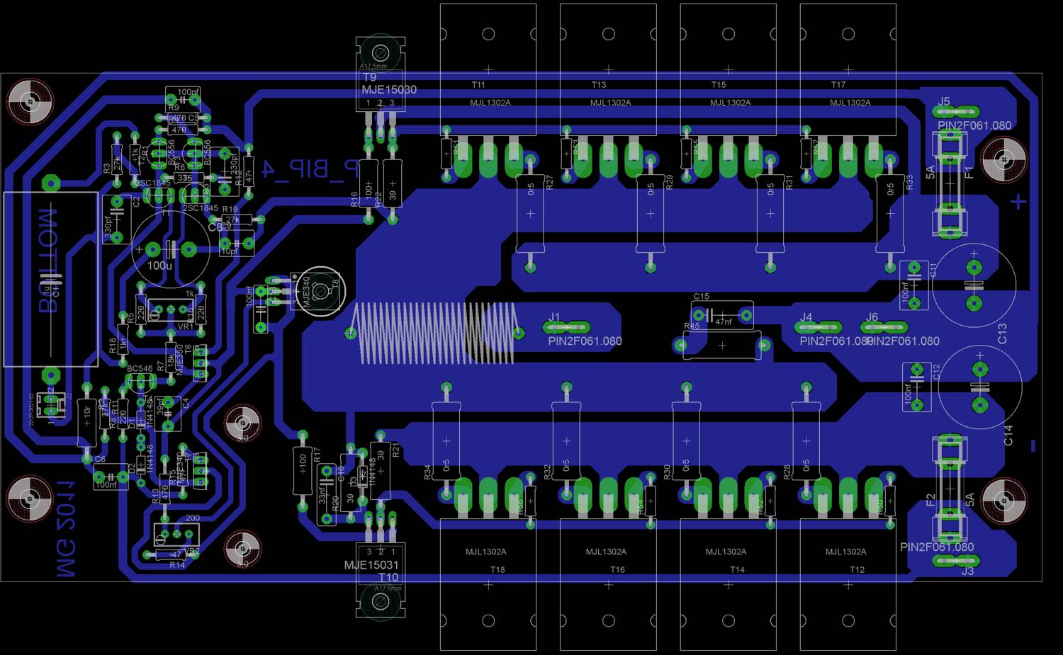

I spend some more time on new NBIP routing job. The goal was to separate the more i can signal input and power input so that any signal wire and power wire are crossing in case arrangement. I keep Quasi first stage layout. This all result in a sigle side PCB without straps.
Note : Emitter resistors have wrong value on Output transistor ; should be 0R5 not 1R
Marc
