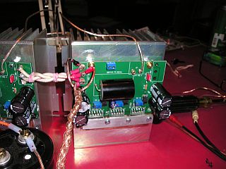

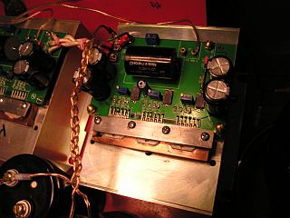

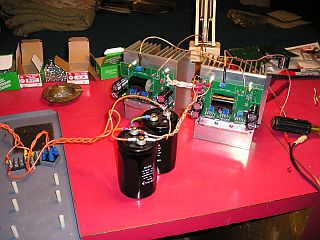

BPA300 mono block
here is a picture during the final test. i will build the chassis this weekend. not sure if i am going to make two separate monoblocks in one case or make two separated cases.
tryonziess said:
has anyone had any luck connectin the s`ingle ended leads directly to pcb for bridge operation. i connected the ground to one + input the the positive to the other + input. my amps sound fantastic with only the cd player driving them. i have a balanced sound card on my computer and will try it next. how is the transformer project going alex
It is good that you get rid of the noise.
When you connect like this and with single ended input source, you are essentially using only one PCB, which gives 150W max.
I am working on a balanced pre-amp now, after that is done I will try the transformer in my power amp. The transformer is better driven by an active preamp.
alex88. anytime i get the drv134 setup even close to the amp project it creates excess noise. i am going to have to work on this or go with the transformer. these units are incredible sensitive to stray signals. i am going to go back through the drv setup and see if something is not right or make a new one. i got the boards from digi01 and they seem to be well made. i still have some excess heat in one bpa150 module. it is not too bad just hotter than the one next to it.
alexcd, i am having problems getting my pictures to be accepted by the forum specs. i will send a few closeups once i get them shrunk to 105k for forum rules.
alexw88.. got the caps right where you show them on your amp. i have just enough space under the board for the caps and some air. alex i noticed that the mounting holes at the top of the board go right thru the power traces. i had to install insulating washers at those two standoffs so there was no chance of shorting. just in case some other builders have not noticed.

sprocket, that is how many i have. ain't it grand. let me check how much i paid alex for them. where are they to be shipped so we can add a tiny bit of postage. i initially planned on building 4 mono blocks or paralleling alex's original design with an extra pair. however, the final result of just the original circuit is great. i am also considering just running parallel instead of bridged. you will like this build. alex did a good job. i am off to a discrete symasym next to try it out. tad
