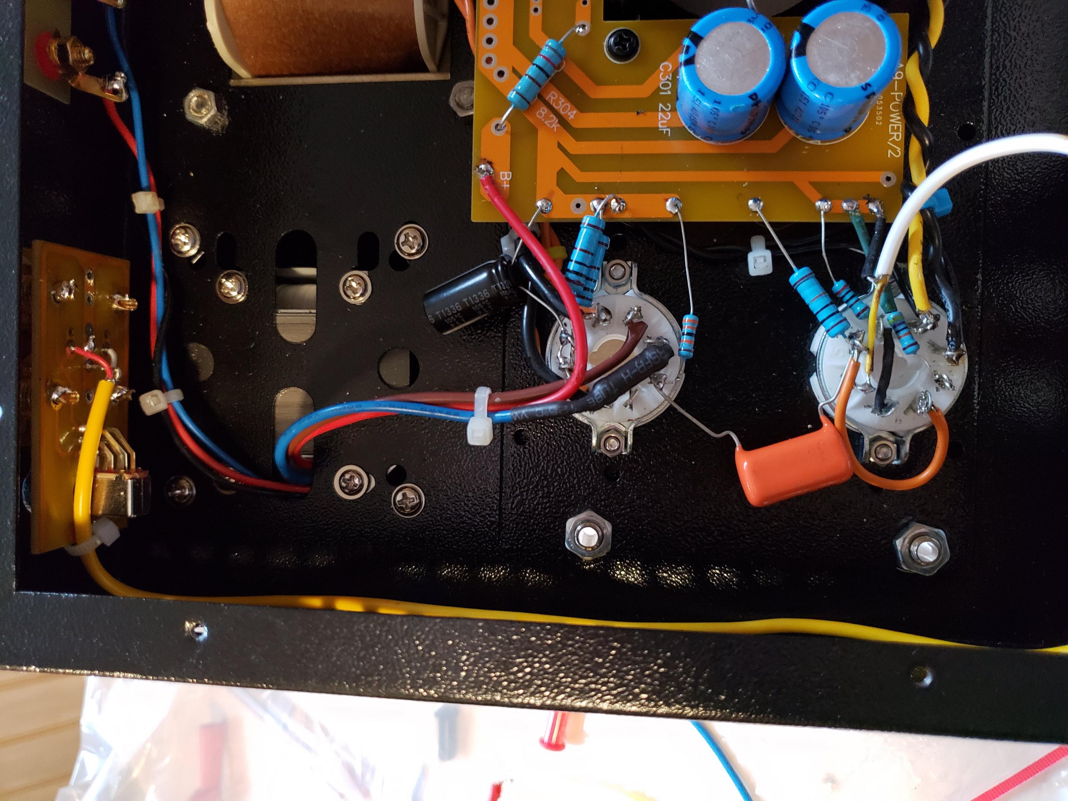

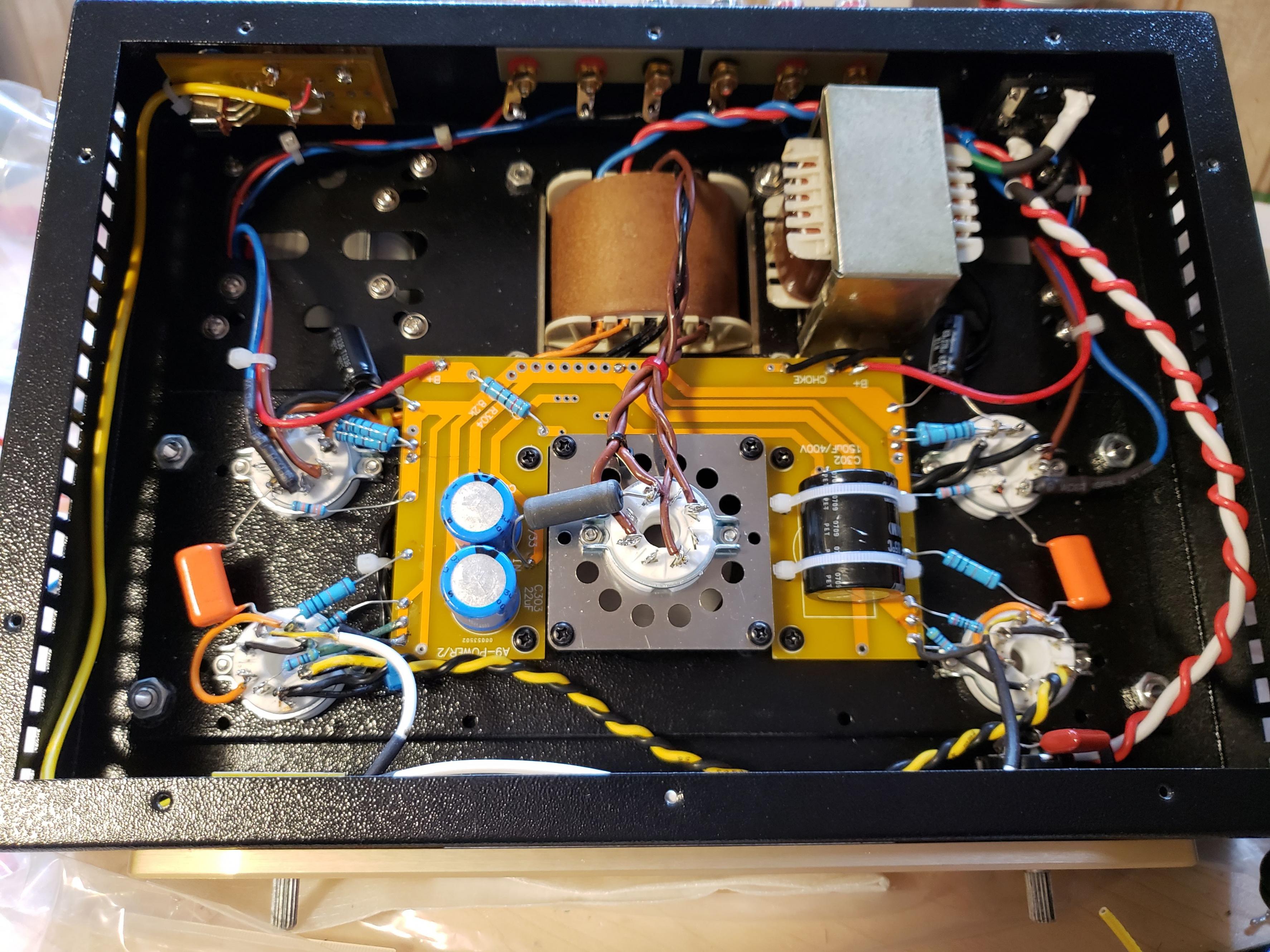

In this A9 kit I have, the negative end of the C302 filter cap (big black one on the PCB in photos) is tapped into the common circuit ground on the PCB. I have no idea where the ground for transformer is located as per the schematics that came with the kit. Does anyone out there with direct experience with this kit have any experience with this they can share because I am really confused on this grounding, earthing issue? Here is what she looks like now:

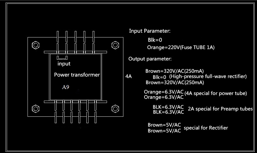

Does the diagram below (from LongRoad) show the connections (leads) from your transformer?
Assuming your PT has no shield lead:

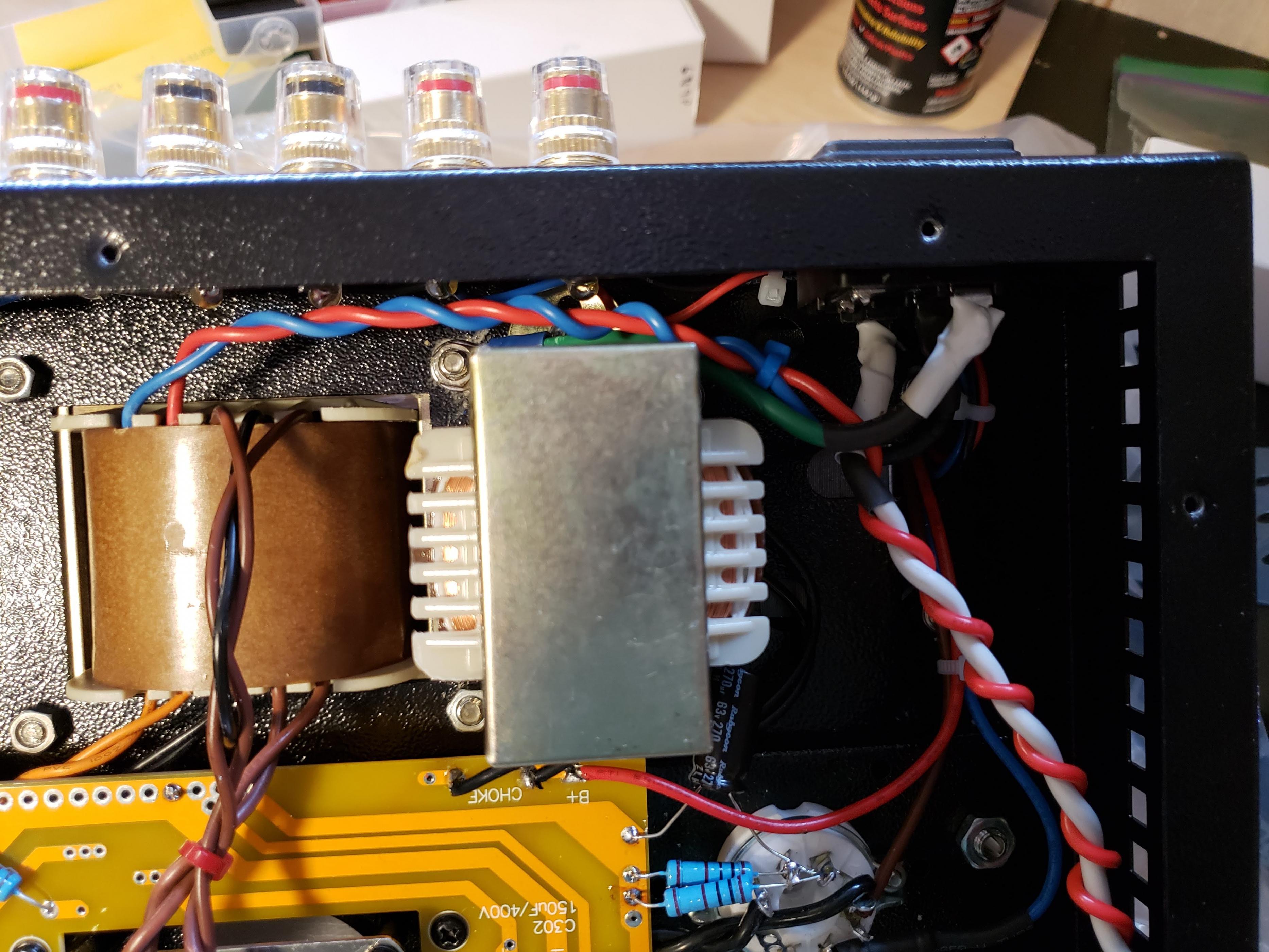

The PT body is grounded to the chassis via the bolt where you have connected the 'green' AC safety wire.
From your photos, it looks like the black HV center tap lead is soldered to the PCB ground plane, close to the transformer, and also close to the negative connection for the filter caps.
So the question is how and where do you connect a wire between the circuit ground and the chassis. The chassis end should be a lug securely bolted with a spur washer to bare chassis metal. Get instructions from Wavebourn on where to connect the other end of that wire!

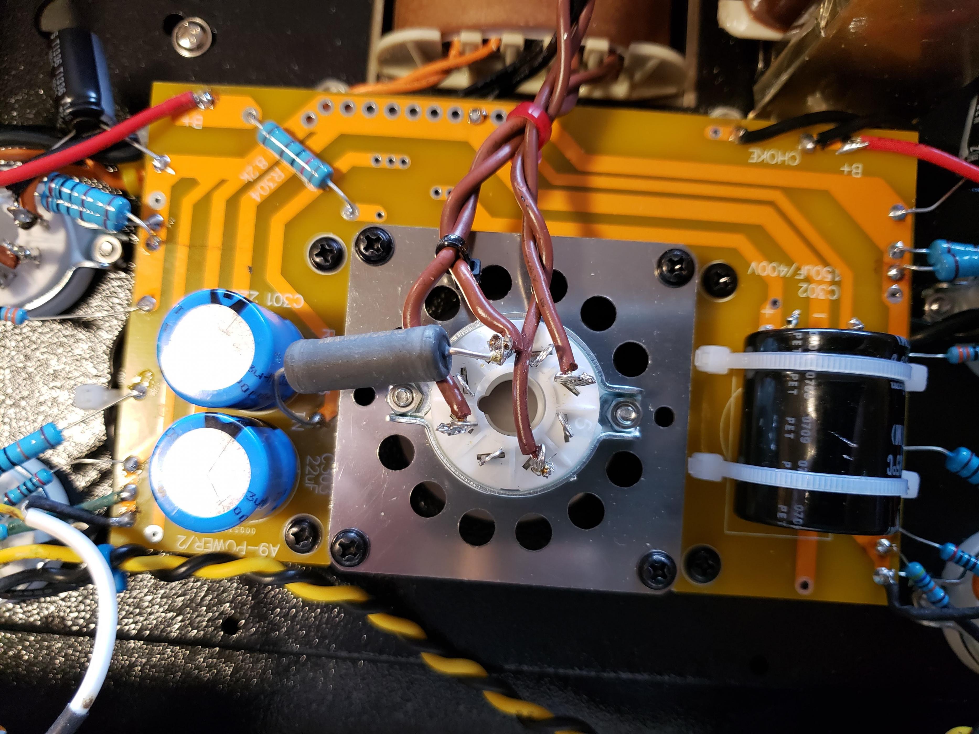

Please see the attached pic of Tim's PCB. I've marked spots where the PT CT connects, and where the filter cap connects.
To me, all three spots look electrically equivalent.
However, you seem to be saying that one spot is 'the worst' and another only a short distance away along a fat PCB trace, is 'the best'.
Perhaps you could suggest a good spot to solder a wire from the chassis to the PCB, please.
From your photos, it looks like the black HV center tap lead is soldered to the PCB ground plane [, close to the transformer, and also close to the negative connection for the filter caps. COLOR="Red"]yes[/COLOR]
So the question is how and where do you connect a wire between the circuit ground and the chassis. The chassis end should be a lug securely bolted with a spur washer to bare chassis metal. Get instructions from Wavebourn on where to connect the other end of that wireThis has been my question all along - nowhere have I seen this being discussed by anyone on this forum. Would I not simply solder a wire from the ground plane of the PCB to the bolt where I connected the safety ground? was planning to do the alligator clip thing for that stage. Right now I just want to energize the thing "without tubes" to check voltages across the various secondaries. Is that doable without wrecking anything?

So, if you were going to follow this advice, you would find a spot on the input jack PCB where the shields connect, and connect a wire from that point to a lug on the same bolt as the green/yellow AC ground wire connection.
Except there are traces between them that have resistance.
If the amp say draws 160 mA, the trace's resistance is 0.01 Ohm, and the filter cap is being charged during 1/10Th of the each cycle, that means the current through 0.01 ohm is 1.6A, that means 16 millivolt sharp 120 Hz pulses on that trace already. If say sensitivity of your amp is 160 millivolt, you get -20 dB hum if input current goes through the same ground trace. If it is even 1.6 volt, it would be -40 dB "only"!

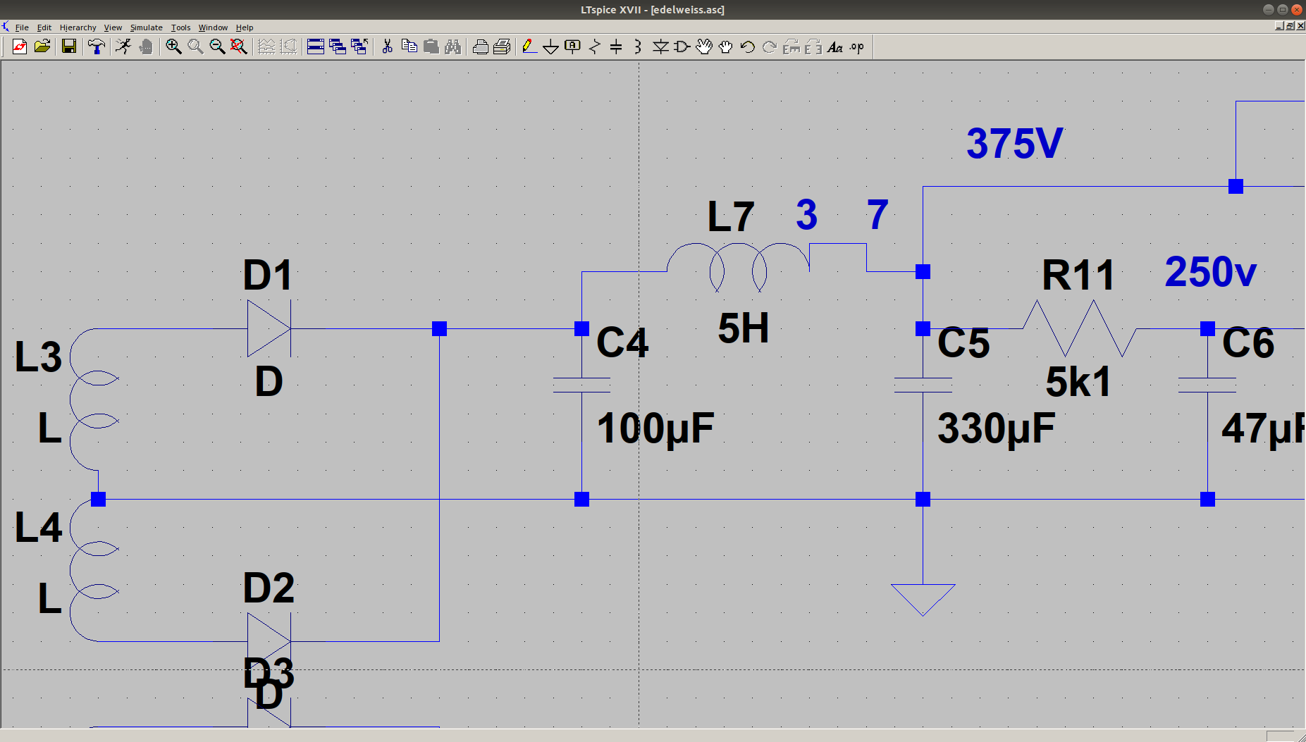

Close the loop with pulses directly on the first filtering capacitor using separate wires. Connect "ground" ends of the first and second capacitor by the separate wire. Then use the second capacitor as the reference.
Here is an example. You must wire exactly as drawn on the schematic: one wire from the center tap to the first cap, from it another wire goes from the second cap, and from the second cap you can power the rest, it is the ground reference point. May be for the incandescent lamp all ground wires are electrically equal, anyway it will produce the light, but in sensitive equipment they are not, they have resistance, and currents that flow through them cause on them voltage drops that being added to weak signals cause hum and even HF oscillations due to feedback!

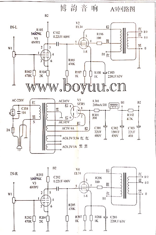

Judging by the original scheme of the A9 amplifier, the transformer screen winding is absent and not grounded.
The circuit also does not indicate that the transformer housing is connected to the common wire.
Most likely, the author of the scheme united the earth with a common wire.
Those. the amplifier chassis is grounded.
This is valid if the chassis of the amplifier is colored and is not a conductor.
The A10 amplifier has a bare metal and cannot be used as a ground.
