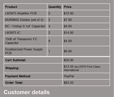

SOoooooo, which of the cheaper kits would you guys recommend. or is there a public PCB layout that I can use (local makerspace has a pcb mill)
I want to do this quite low budget and the chipamp.com kit is surely going to result in tremendous import fees so I would like to avoid that. I want to use a single transformer for the same reason.
Living in France :

Last time I ordered something from the US it was 21% of the items value plus a fee of 20 euro for the post office because they had to do the work with customs and stuff.
In that case I paid 27 euro extra on a 35 euro item... it pissed me off quite a bit and now I always keep things under 25 euro which is the limit to avoid import duties.
EDIT: *apply head to desk at high speed* I completely missed that they sell the pcb's for 6 dollar a piece... i'll just get the parts locally. I've seen some big *** 22000 uf capacitors for not much money to stuff in the power supply :D

Two pcb's and two lm3886 will cost me 23 dollar, which is 21 euro from chipamp.com. anything above 22 euro is taxed at the moment, i just checked it and it got even worse now; 3% of the value of the product, plus 21% of the value plus 30 euro for the paperwork... so I will avoid all these stupid fees :D
I will source the rest of the components locally, nice wima caps, big fat 225VA toroid for not too much, saw some (surplus) screw terminal 22000uf caps for 10 euro a piece (will have to check if they fit my chassis) etcetera.
So no ebay kits for me :D

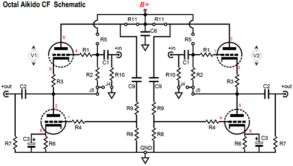

I've recently added the Octal Aikido cathode follower and it came out superb, no hum, no buzz, I was amazed that I cannot hear anything bad even with my ear right by the speaker and the pot fully open....
But it is lacking a little bass, just a touch.
I was hoping that knowing input impedance I will be able to calculate the Aikido's output cap.
At the moment it's 2uf.

.........................Could someone tell what the input impedance of unmodded xy amp be?............
what input components are you planning to use?
post the sch you have built to.
There is a 50k pot on the input (can make it 20k),the output goes straight to XY amp .
I'm looking for C2 value here.
Where are the input components of the XY amplifier you are asking about?
