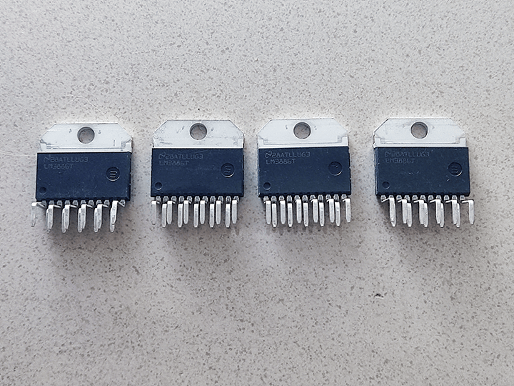

Hello dear friends ,
Quite recently, there was a limited number of LM3886T at Reichelt. I didn't want to miss the opportunity, I've purchased four pieces without hesitation. I was quick enough - they've sold them all in few days.
Yesterday the parcel with four new shiny ICs has arrived. Please, look at the snapshot below. Aren't they handsome?
I'm looking forward to build this fine amplifier again.
Have a pleasant day
