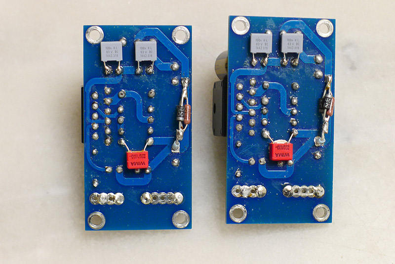

Long time no posting in this thread.
Looks like someone in China has been following this thread.
This is the result.
The link is here:
2 x Super NS LM3886 LM3886TF Audio Power Amplifier Kit | eBay

Did anyone test these?
I'm quite curious wether there is a "standard" pcb layout available that has a zobel and thiele circuit that I can just make myself or order online. I know about the chipamp kit boards but they are quite expensive
I have seen the thread but even there people are saying that things should be done differently. It almost seems as if there is no way to do I right because in every thread people are saying that things are wrong.
On the other hand I have seen a publication of a well known amplifier designer in the Netherlands (triodedick) that built one with those XY kits and he said there was nothing wrong with it.
It seems so strange that even though there are a lot of complaints about the circuits and layouts that nobody designed a proper layout that has it all.
A good side effect would be that the eBay sellers might copy it as they have done in the past and then maybe less people have problems with building this amp
I know of TWO quite different XY chipamp PCBs.
I have both.
There is no reason to condemn them with
Yes I have this kit..
Not so good for price, no bass and very noisy
They are excellent value for money.
They do not lack bass or bass extension, they are ONLY PCBs.
They are not "noisy". Yes they have an error in the Signal ground to Power ground when used in a stereo amp implementation. That error does not affect monoblock builds.
If any of these alleged problems affected Philfr, then that is down to an incorrect assembly or selection of inappropriate components, not the fault of the XY PCB
