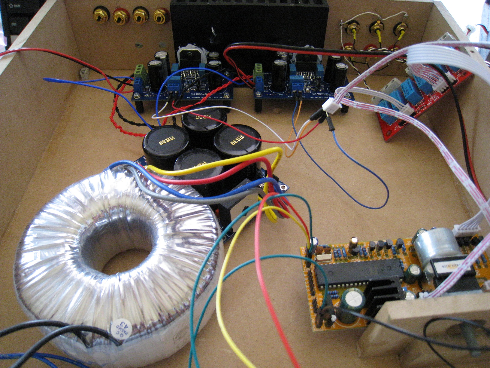

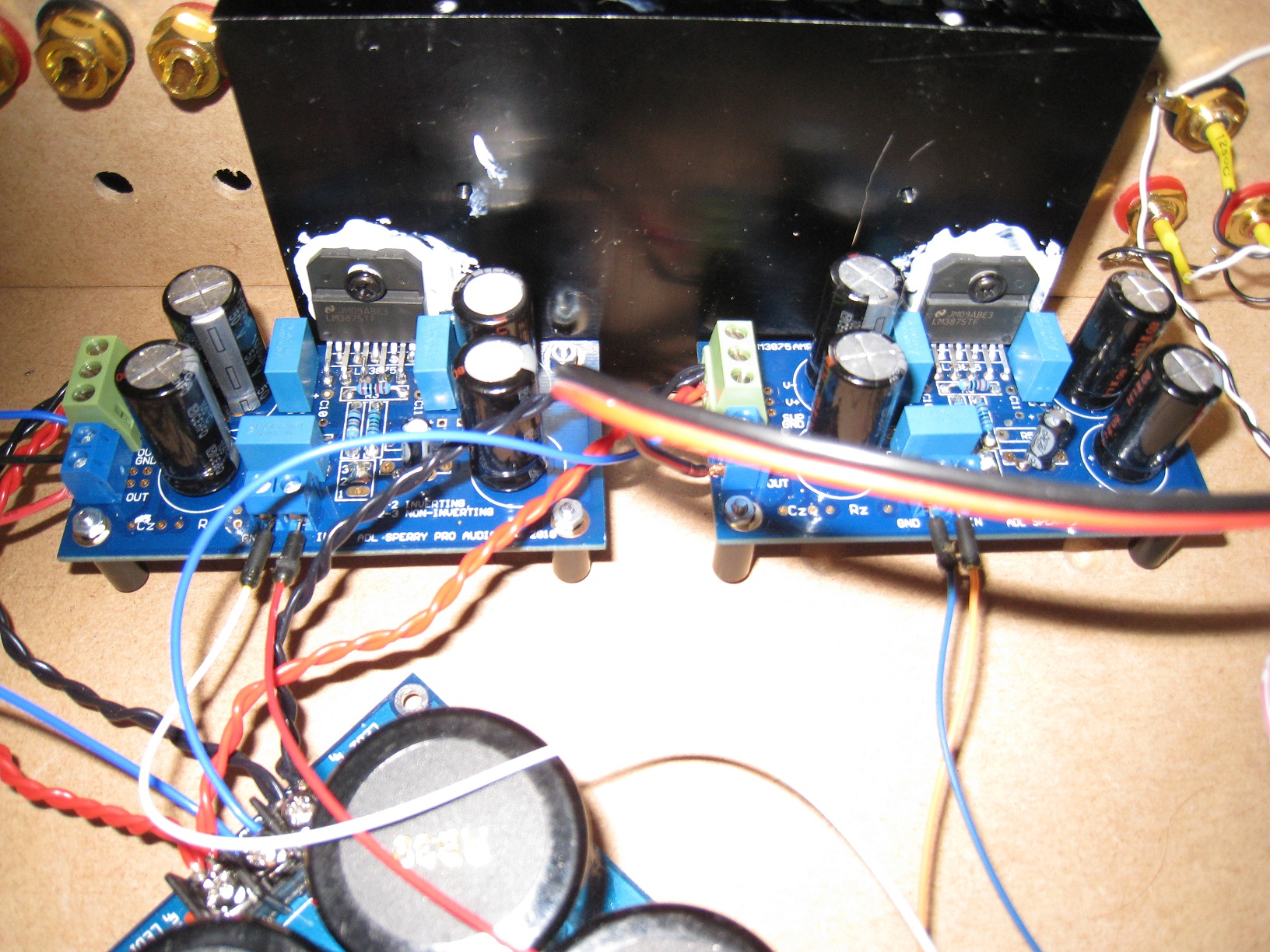

You interrupted signal ground and power ground on the PCB by scratching away the thermals. Now the signal ground is floating. That is the reason why the output swings to one rail.
You need a connection from signal ground to the power ground. For a test take a wire from the IN GND terminal to the OUT GND terminal and check, if that solves the issue.
That sounds plausible. I thought I did it just like Aguilabrava did. I guess I did it wrong. I will try it later this week. Thanks for your reply!You interrupted signal ground and power ground on the PCB by scratching away the thermals. Now the signal ground is floating. That is the reason why the output swings to one rail.
I do not get it. Are you trying to tell me that the input ground needs to connect to the power ground? Why where the bridges cut then?Corpius, by looking at your pictures you did cut the ground bridges the right way, I think what Pacificblue is telling you is that ALL grounds need to be connected so the input GND isn't floating. Just connect the GND's and test again.

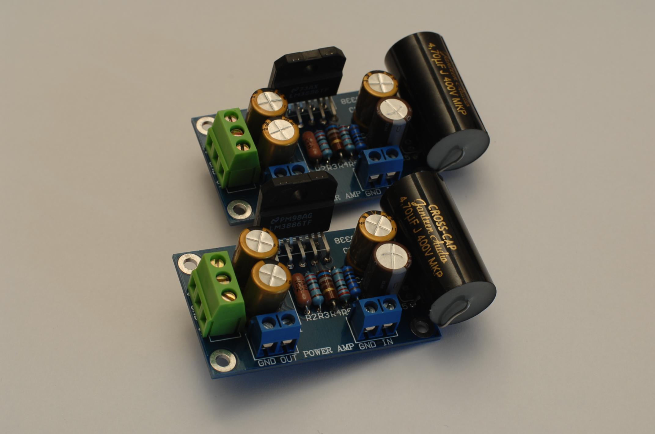

Here, the pictures of the new XY LM3886 amps I just put together yesterday.
The C1, C2, C3 are now Nichicon Fine Gold 100uF 50V, C4 is Elna Silmic II 47uF 50V. Ri (Inverting input resistor) was originally a 1K Ohm metal film but in these new amps I used a high quality japanese 680 Ohm carbon composition resistor. C5 was also replaced by a Jantzen Audio Cross Cap 4.7uF 400V. The Zobel R+C is now a 10 Ohm metal film resistor with a Wima MKS-2 0.22uF 250V, and the RF input cap is now a Faratronics polyester film 1nF 100V.

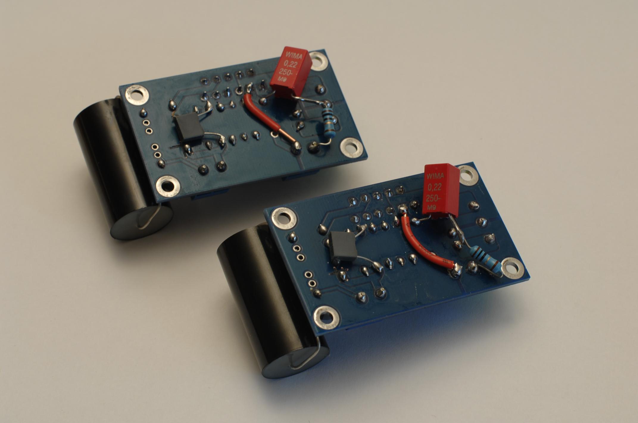

***In the pictures, the Zobel R+C is wrong, I placed the capacitor first, then the resistor, but the mistake has been corrected.
I used the "Corpius Method" to do the modifications in these new boards.

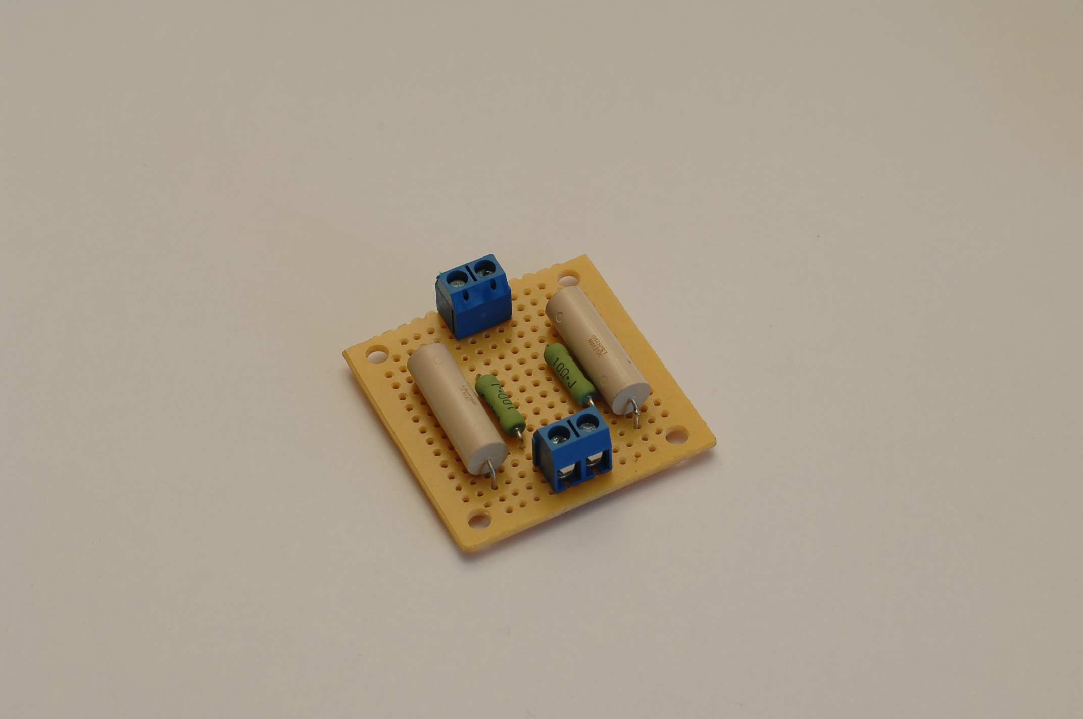

I also upgraded the R//L Thiele with bigger 1.5uH inductors and 2 high quality japanese carbon composite 10 Ohm 2W resistors, using the "Corpius Method" too, soldered on a PCB board I got at Radio Shack.
