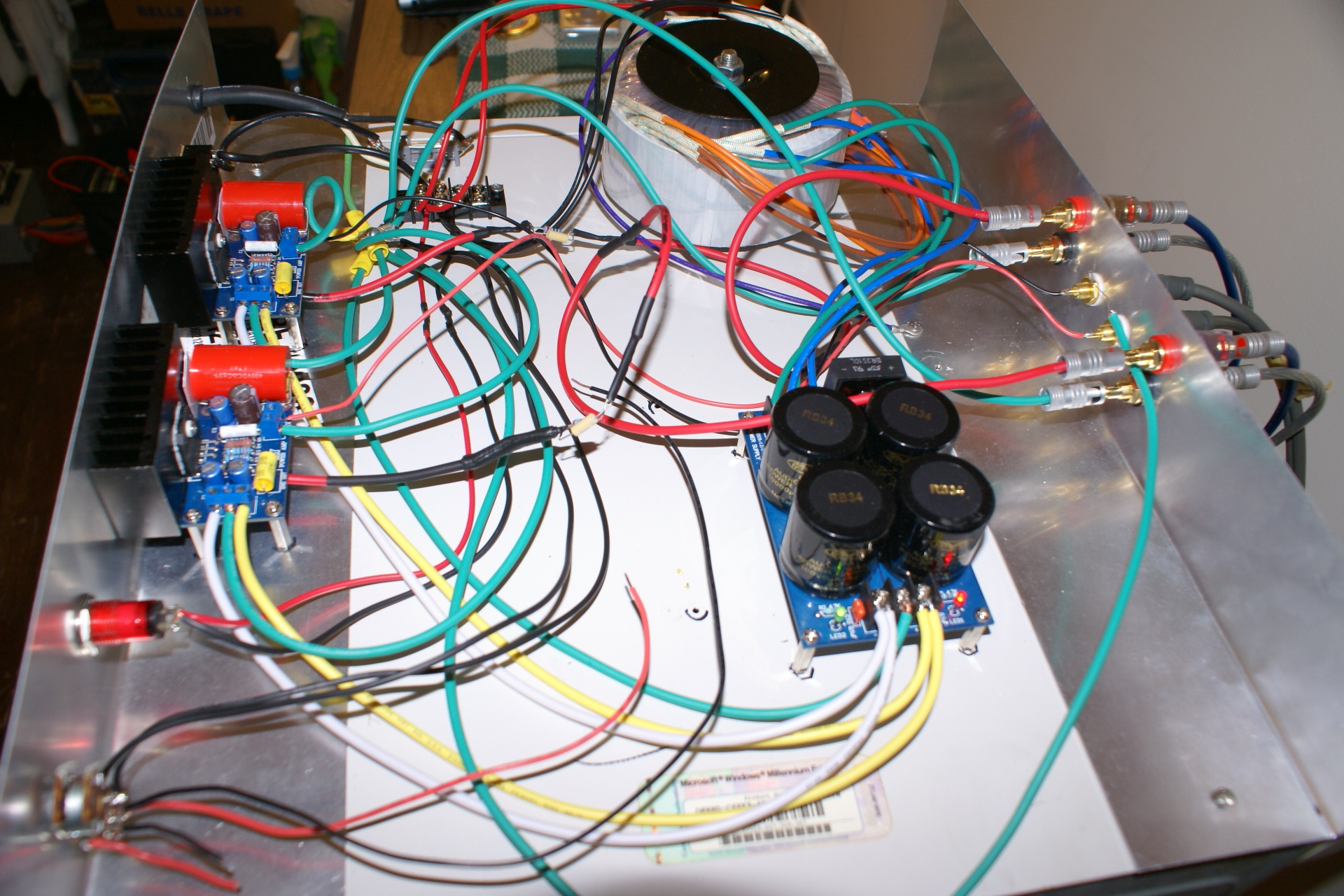

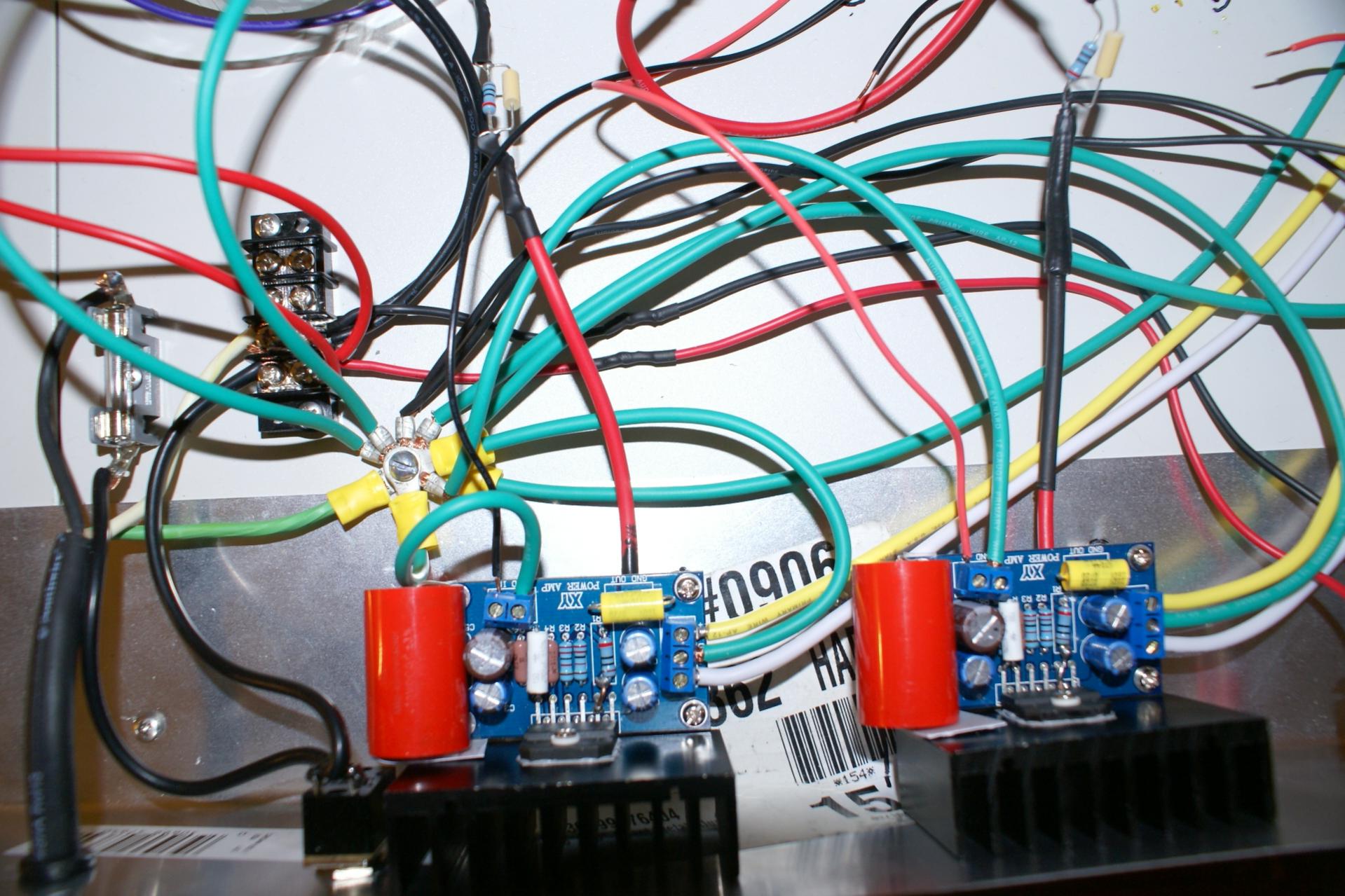

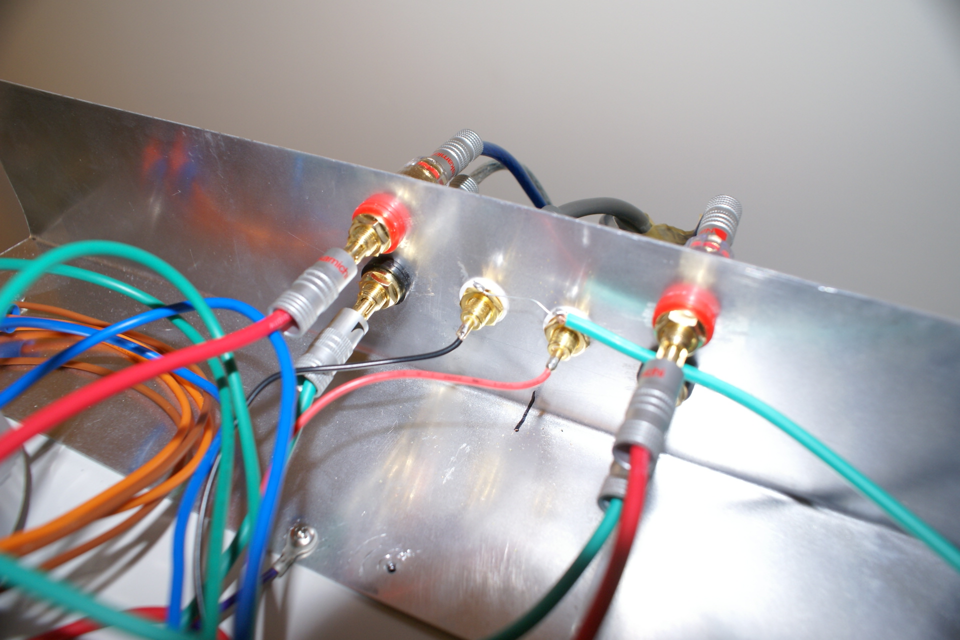

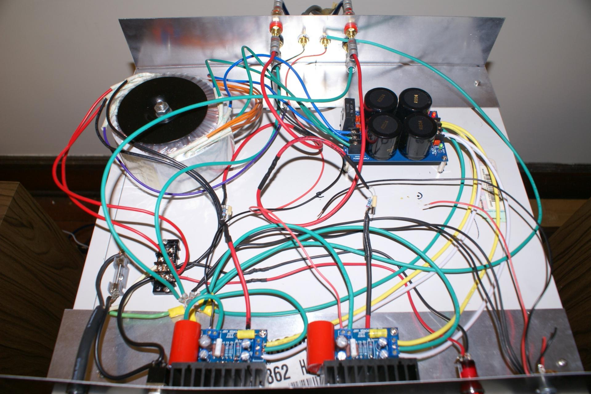

Here, the pictures of the amplifier. Right now the volume potentiometer is disconnected because of the issue I'm having with the Right Channel amplifier outputing 6 volts less than the Left Channel amplifier.
Again, there is no hum or any kind of noises in this amplifier, it sounds amazing, detailed, crystal clear sound. The only issue is what I have mentioned above. I know the wires are messy, I will do a better job when I put it in the enclosure.

Well, as you can see it, all the wires are like spaghetti plate!. The wires caring AC should be Twisted really well and also as close to the chassis as possible. The inputs wires should be as far as possible from AC lines and transformer! any noises picked up by the input wires...WILL BE AMPLIFIED😱!!! also "ground loops" are big problems too.
Spaghetti is just right...!

Yes, the whole thing looks like a mess, I knew that as soon as I'd post the pictures I was going to get a lot of criticism, I am ready for it...🙂
Now, the amazing thing is that even though the cables are a complete mess, I didn't have any hum or noises of any kind. I introduced hum last night when I added the two pieces of aluminum foil to the gaps between the heatsinks and the sheet holding the switch and volume pot.
All this issues will be addressed when I put this thing in a enclosure, but I need you guys help in the meanwhile. Can you please tell me where the ground loops are?. Can you please tell me if soldering ground cables to the heatsinks will get rid of the hum I have now that I didn't have before?.
