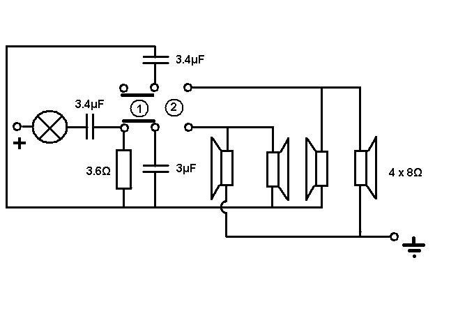

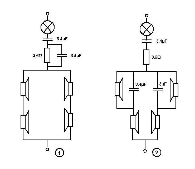

Here I post for you a BOSE 601 ser-1 xover circuitry. I missed the 2 bass drivers, they are connected in parallel, strait to the input terminals. More- interesting is the connection to the tweeters. On the second picture is the way, how they work at position symmetric and pos. asymmetric on back switch. Like always, the realization of the xover is simple, without PCB.
