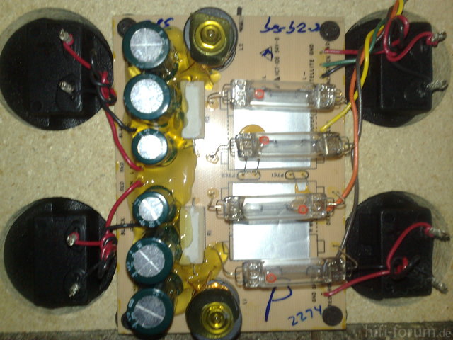

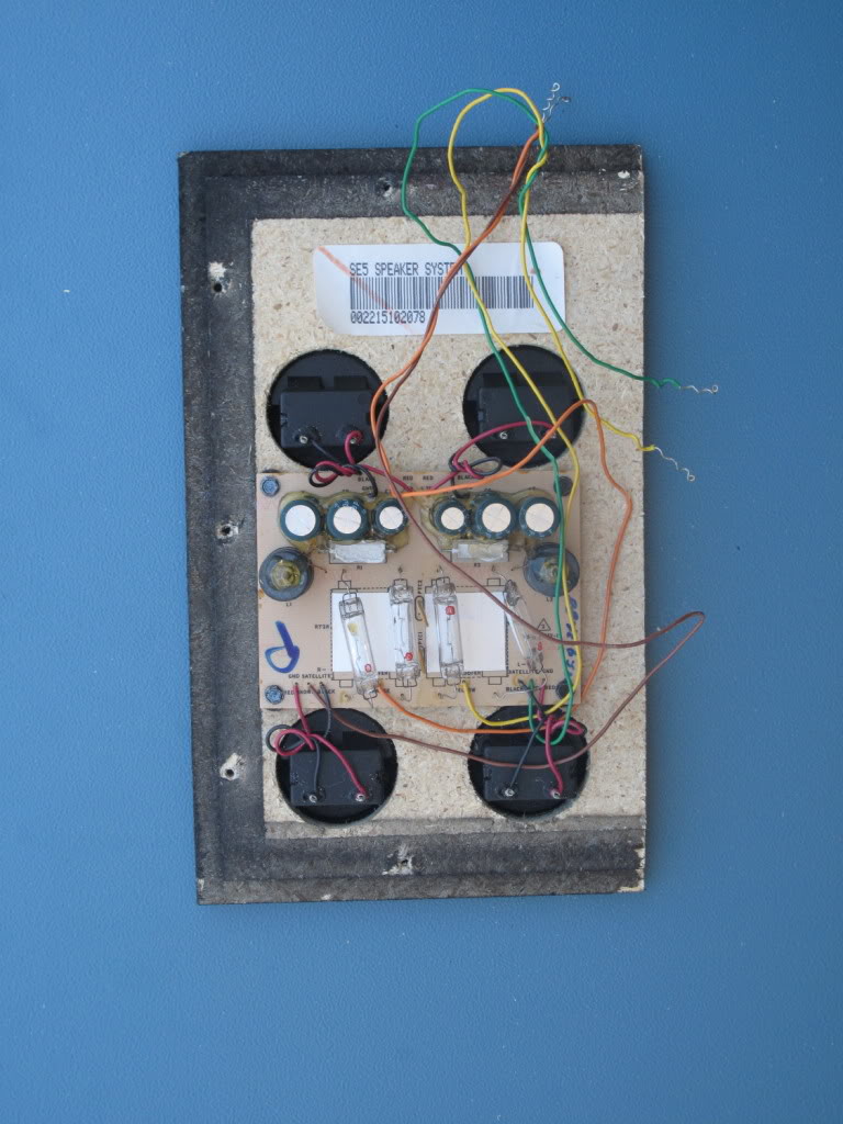

Bose Crossover Networks - Ultimate-/Reference- or only Average Quality Standard?

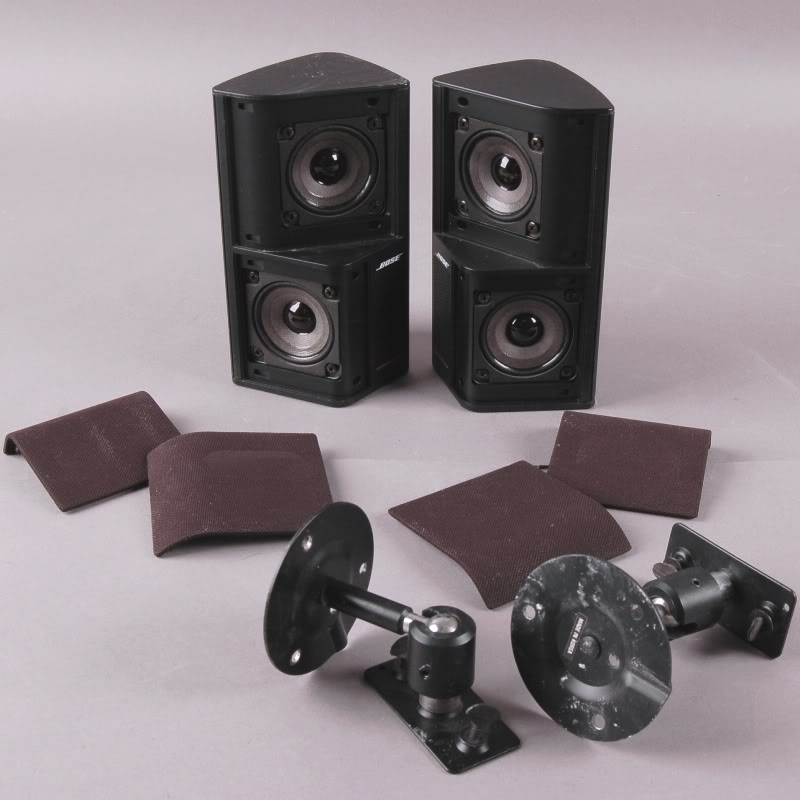

What about the quality of BOSE's crossover network devices for their acoustimass sub-sat systems like "SE-5" (SE5) ?
And what is the aim of the lamps, that illuminate the interior of the chamber (have a look to the attached pictures) ?
Some people tell me, BOSE is claimed by their speaker demonstations, that only the best components available on the world market would be used in their speaker devices.
Because I don't know about the technology of the Bose crossover networks this above mentioned (for several readers stupid) questions.
Thank you for comments and advices.

"Some people tell me, BOSE is claimed by their speaker demonstations, that only the best components available on the world market would be used in their speaker devices."
Best??????? Try "components that cost us next to nothing with a HUGE markup for the consumer" Bose' strengths are their marketing ploys to convince people to pay way too much for what they get in return.
Joined 2005

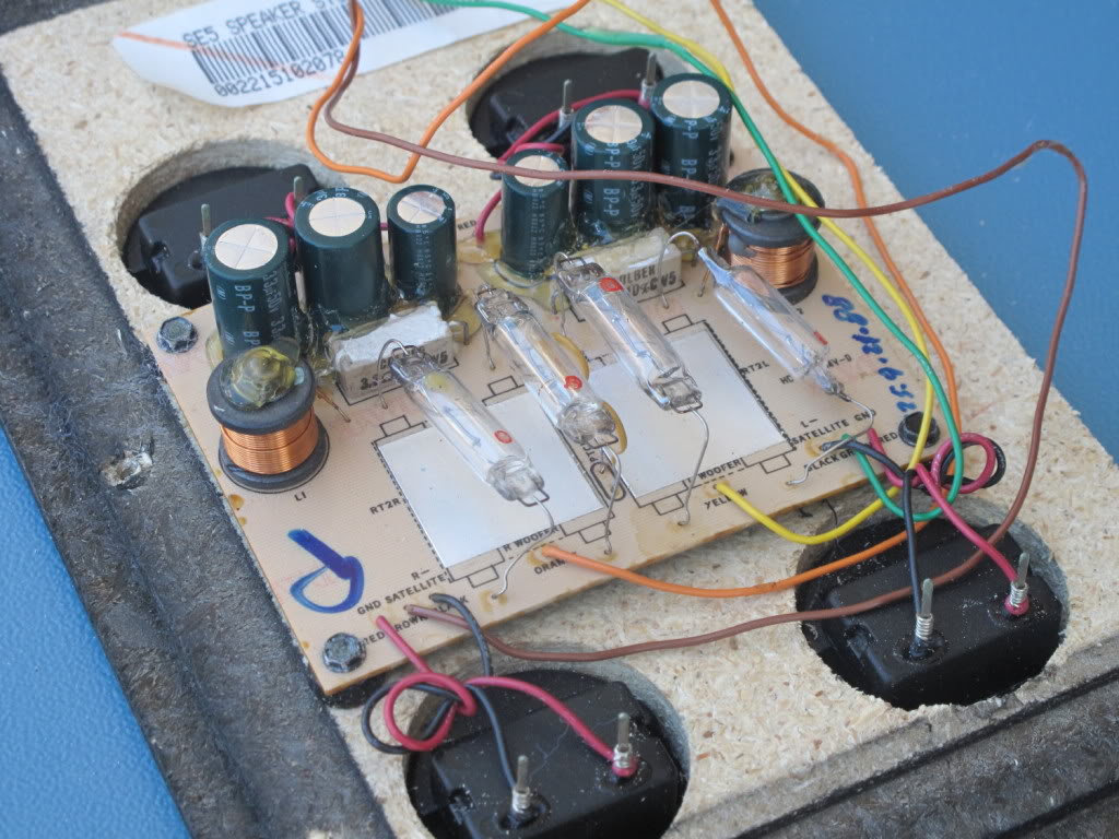

Cheap bipolar caps, thin wire, poorly dressed low cost labour wiring job, cement wire wound resistors, small guage inductors, was there any dampening material in the cabinets to absorb cabinet reflections? - more overpriced Bose crap
the parts quality is pretty common for mass market, mass produced speakers.
Iron core inductors and electrolytic caps indicate that this item was built pretty much as cheaply as possible.
Without the lamps the speakers would fail pretty quickly so they are a good inclusion.
To improve the design one could substitute air core coils and film caps with the caps having the most influence on the sound quality.

I would replace the electrolytic capacitors with polypropylene since they last much longer. Generally the electros start to dry out after about 15 years but polys last much, much longer. Normally this is fine, the foam surrounds blow out about the same time as the electrolytics dry out so...
The inductors I would keep stock--spend the money elsewhere since no matter what you stuff in the crossover--it is still crossing too high in frequency to work properly. I believe the frequency is around 200 Hz or so.
The light bulbs as others have pointed out act as limiters--they burn off excessive voltage to protect the speakers. I had protection bulbs in a pair of JBL ProIII 5" woofer/1" tweeter small speakers about 20 years ago--the port tube would light up if I got too crazy. :D
The wire wound connections on the inputs is secure but they can develop corrosion after 10 to 20 years. Two options, either unwrap and resolder them or you can replace the input plates with 5 way binding posts if you like. That will give you a much more secure connection.
Had a buddy that inherited a set of those SE5's--he really didn't like the sound of the cubes so replaced them with 4 ohm JBL ProIII speakers. That caused the passive crossover to start tapering off the bass to the ProIII at 100 Hz instead of 200Hz stock settings due to the lower impedance. He stuffed the "bass module" between the two JBLs, adjusted his EQ a touch and liked the sound much better.
Good luck!
The lamps are a common trick for speaker protection. Their cold resistance is fairly low so they pass most of the signal. If you play too loud then they will heat up and their resistance will rise. This puts a soft limit on input signal.
Not real elegant but it works.

That Bose crossover certainly looks like it was built to a pricepoint. A low one. There may be more skill to that than is obvious.
The lamp in line is an old tweeter protection trick - in pro audio anyway. Don't think I've ever seen it before on anything but tweeters. You can buy the lamps at Parts Express. Eminence PX:BULB Replacement Crossover Fuse 290-659
