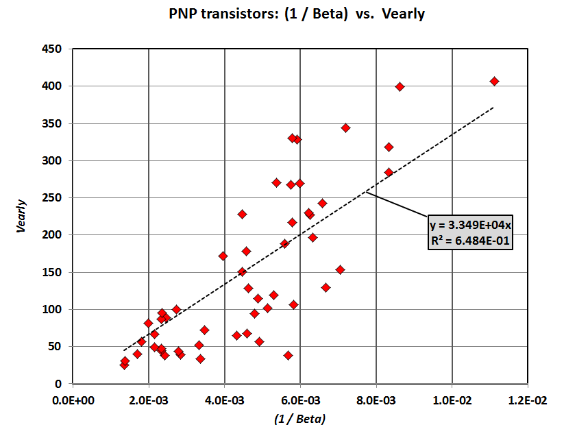

I had a sudden Aha! realization while brewing coffee this morning: When you perform Linear Regression, you automatically get a "Goodness Of Fit" statistic called R-Squared. This might shed some additional light, when trying to judge how well or how poorly Bob Cordell's Figure Of Merit (Figure 1) fits the measured Beta and Vearly of 52 different PNP transistor part-numbers.

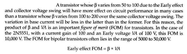

To perform Linear Regression, we need a linear equation in canonical form: y = mx + b . Starting with Bob's FOM equation
  • Beta * Vearly = FOM
we multiply both sides by (1/Beta):
  • Vearly = FOM * (1/Beta)
and then, for perfect matching with the canonical form, add zero:
  • Vearly = FOM*(1/Beta) + 0
There it is, an ideal textbook linear equation: y = mx + b, where (y = Vearly), (m = FOM), (x=(1/Beta)), and (b = 0).
I put these into Excel, made a new scatter plot, and told Excel to overlay its fitted Linear Regression line (Figure 2). Excel says the best fit value of FOM, for these 52 different PNP transistors, is 33490. Call it thirty three thousand. The R-Squared statistic is 0.65, which suggests to me that the model fits the data moderately well, although the scatter plot in Figure 2 does show there is often quite a large error (> 300% !!) between Predicted_Vearly from the equation (dotted line), and Measured_Vearly from the curve tracer (red diamonds). We can see why Bob's book says that the FOM of real transistors usually falls somewhere within a ten-to-one (!!) range.

I had a sudden Aha! realization while brewing coffee this morning: When you perform Linear Regression, you automatically get a "Goodness Of Fit" statistic called R-Squared. This might shed some additional light, when trying to judge how well or how poorly Bob Cordell's Figure Of Merit (Figure 1) fits the measured Beta and Vearly of 52 different PNP transistor part-numbers. ...
Nice work, Mark; an r^2 of 0.65 and how it slices through the data suggests there are other variables at play that are unaccounted (looks almost like a fractional power law would greatly improve your regression, note how everything is below the regression for low 1/Beta and above the line for high 1/Beta). So I'd definitely say there's a relation between Beta and V_early, but would be reluctant to use Beta*V_early as a figure of merit unto itself, unless very loosely. None of this is a criticism of your work, just my interpretation of the plots.

I tried all of the regression models that come with Excel: Linear, exponential, logarithmic, power, moving average, polynomial. None of them were any better than the linear model. Fourth order polynomial fit, did give some erroneous and hilarious local minima and maxima, but scant improvement.
The scatter plot shows the data is: scattered. There does not exist a smooth curve which goes through each datapoint.
Fair enough, Mark. And, yes, it's definitely easy to overfit the data, so the simplest regression that gets the job done is usually the best one.
