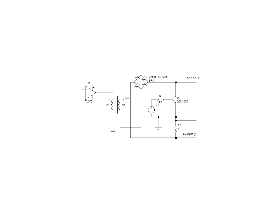

If it helps anyone I use an oscillator driving a power amp feeding a transformer load, that can be switched to feed into the primary or secondary winding to give a high current/low voltage measurement or high voltage/low current, a bridge rectifier on the output, then use a second (isolated, preferably) supply for the base current/gate voltage. Sweep the voltage from the oscillator control on the scope (dual channel, X-Y mode) measuring current through a 1 ohm resistor. One day I might get around to building a stepper for the base/gate drive and building it into a single unit.
Interesting link to the curve tracer kit.

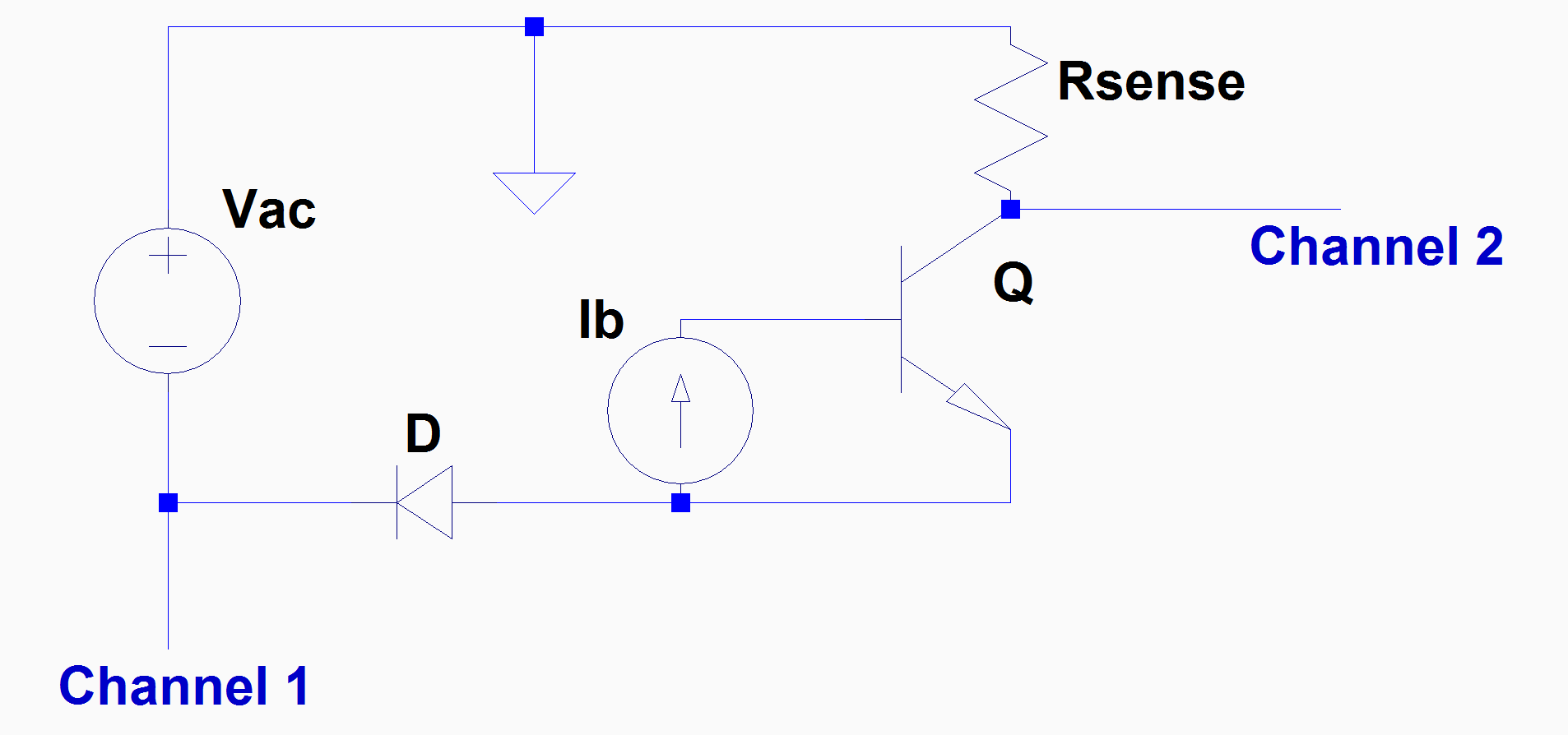

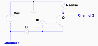

Thanks for that. Shouldn't this idea also work without a transformer, and for small-signal transistors without a power amplifier (depending on source voltage)?
Matthias
I use a transformer to provide a floating output. This is to allow the scope channels to be grounded, and the bias supply (which is not floating) to be referenced to ground too, and then the current sense resistor voltage can float accordingly.
