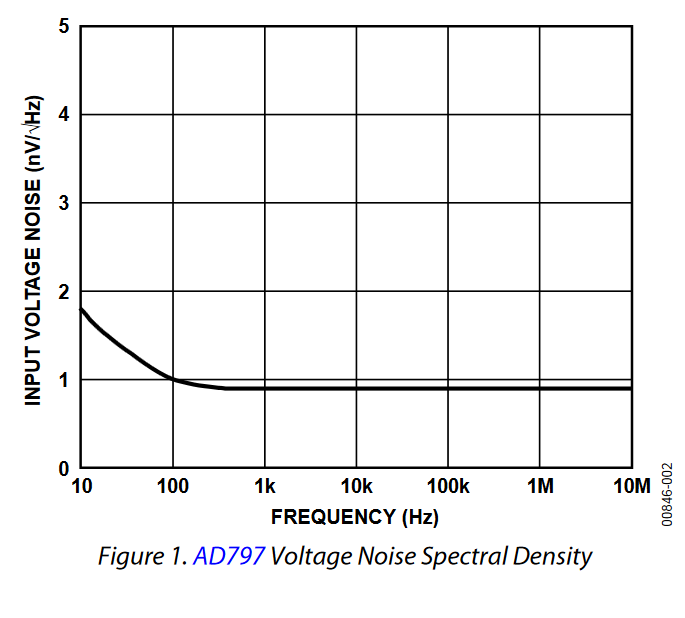

It's more common to use a bandwidth of 22 kHz (theoretical max possible frequency from a 16 bit 44kHz compact disc) in noise calculations for audio, see Self 6th ed p. 151 list item 2.
However it's fairly easy to achieve < 4nV/rtHz in a power amp with unbalanced inputs, at the cost of other specifications. "Merely" build a noninverting input stage running at a gain of +14dB (5X) from an AD797 opamp whose input voltage noise is < 1nV/rtHz and whose bandwidth is 22 MHz at a gain of 5. Live with a low input impedance of 500 ohms, which you achieve using a 100 ohm input bias resistor (and 100R feedback resistor) plus 5X bootstrap. Fit a DC servo to deal with any DC offsets. Connect your bog standard 10nV/rtHz Blameless power amp to the AD797 output and jiggle the compensation capacitor to make the cascade stable with good phase margin. Done.
Total input voltage noise is the RMS sum the individual noise sources: (10 nV / 5x gain) for the Blameless, (1 nV) for the AD797, and (1.29 nV) for each of the 100R resistors. The RMS sum works out to be: 2.89 nV/rtHz. And it was easy.
BUT: you have an unbalanced amplifier: forget XLR inputs. You were probably forced to reduce its open loop bandwidth to maybe 80% of the unadorned Blameless bandwidth, to accommodate the extra phase lag from the AD797. You had to cough up an extra $10.50 for the AD797 and then you had to provide ±15V power supplies to drive it. And the finished amplifier has a 500 ohm input impedance so you can't possible drive it with a "passive preamp".

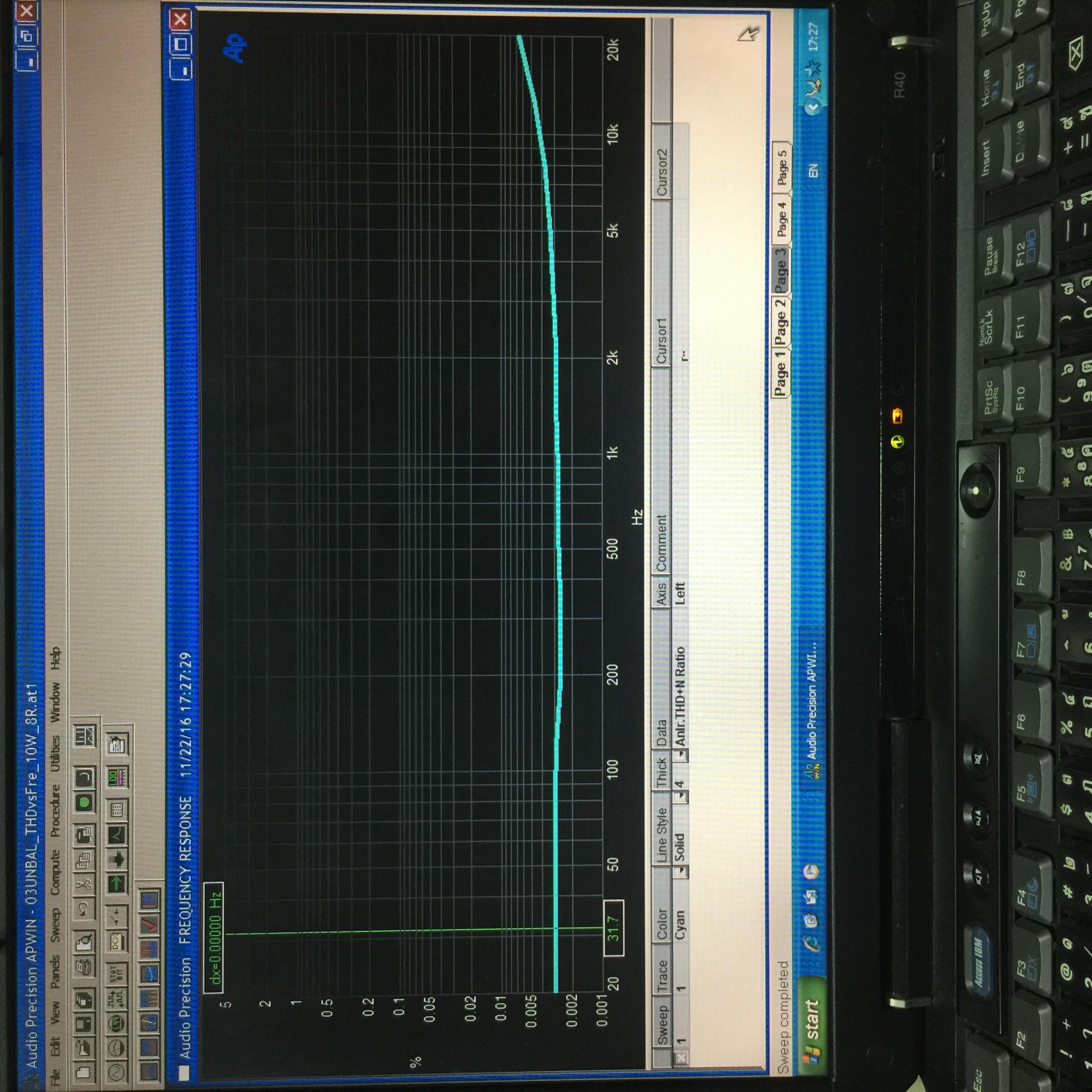

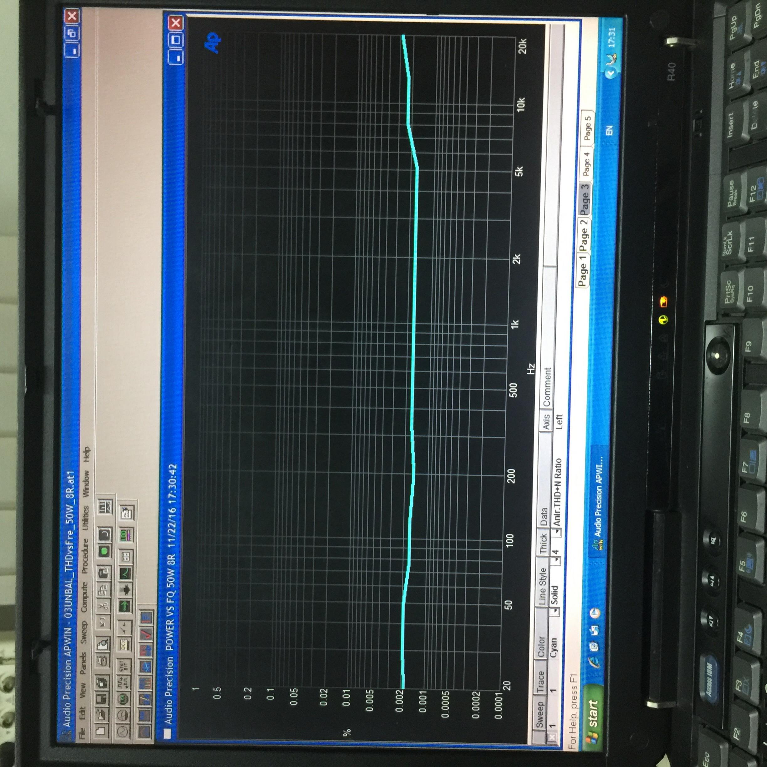

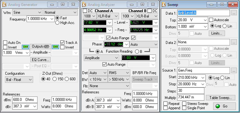

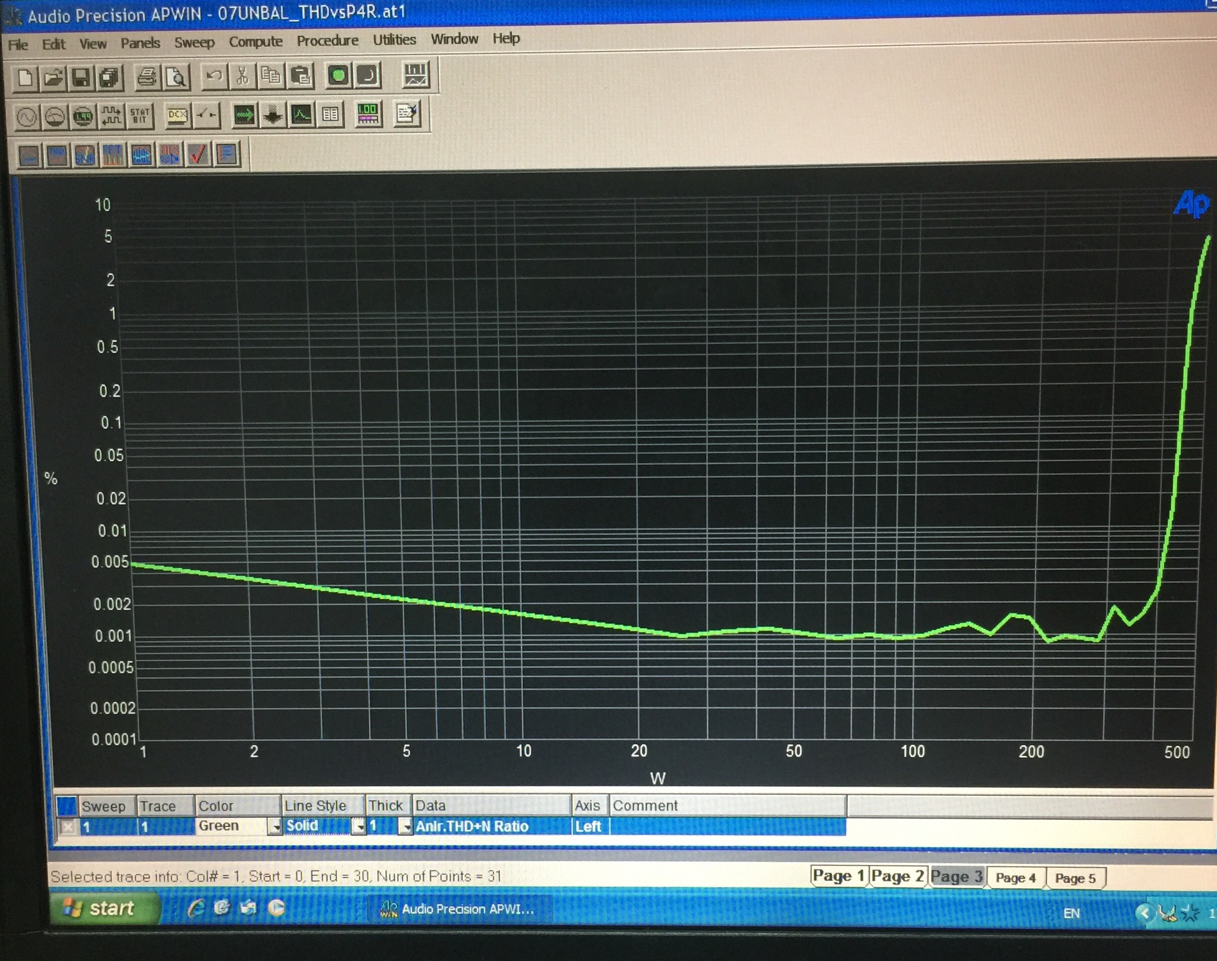

Stability of CFA PAmp...... When I received Dadod's loaded pcb i powered and tested it with clip lead jumpers for everything... to load, groundings, PS leads... long lead wires all over the place..... no oscillation or instability. Nor when same lash-up drove QUAD ESL for loads.
THD+N P into 4R
THD+N vs Freq 50W/8R
THD+N vs Freq 200W/8R
A few examples, only. I will double check these because the results are close to limit of this old SYS ONE dual-domain Audio Precision used at factory.

D. Self does a pretty good job of pointing out that balanced inputs ruin your chances of achieving 4 nV/rtHz input voltage noise. Since balanced inputs are absolutely required in the year of our lord 2016,
This is why before I could attempt my first amplifier build I was obliged to tackle the challenge of implementing Self's ultra-low-noise balanced to single-ended input stage (SSAD 2nd Ed. chapter 18).** My Theta Digital Casablanca IV preamp/DAC/controller only has balanced outputs.
As I went through my first amp assembly I was surprised (appalled?) at all the hoops that had to be jumped through to ensure the "ground" reference remained clean. First I had to go from balanced to single-ended, then star on star, carefully route that ground wire etc etc. Bruno Putzey's article the G Word began to resonate more loudly each day. Why not discard the ground reference altogether and go fully balanced? As a newbie to this hobby I'm wondering why the topic isn't discussed more often with designs presented...
Perhaps it is unnecessary when one becomes skilled in the dark art of star grounds.
** I stopped at the quad LM4562 (LME49740) and didn't venture into AD797 territory

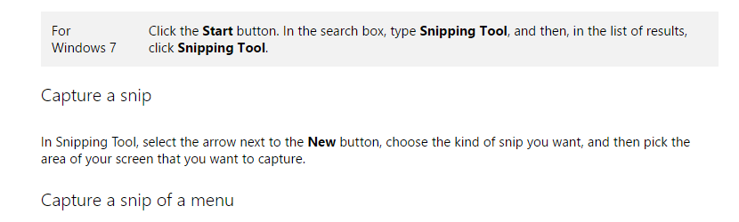

I think he suggested to use screen shots rather than photos from a camera. The screen shots can be cut out and rotated and saved and send, with better resolution as well. I think it would save you time and frustration and make better pictures. I learned that very fast when I started editing for Linear Audio!
Jan
Just tried it with an arbitrary screen open, see attached. Easy as pie, and much better images.
Even AP screens come out well (sorry, didn't have a test handy).
Jan
