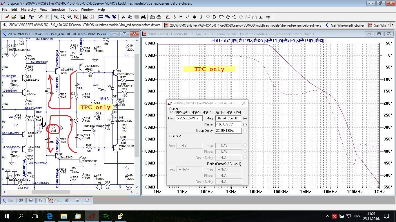

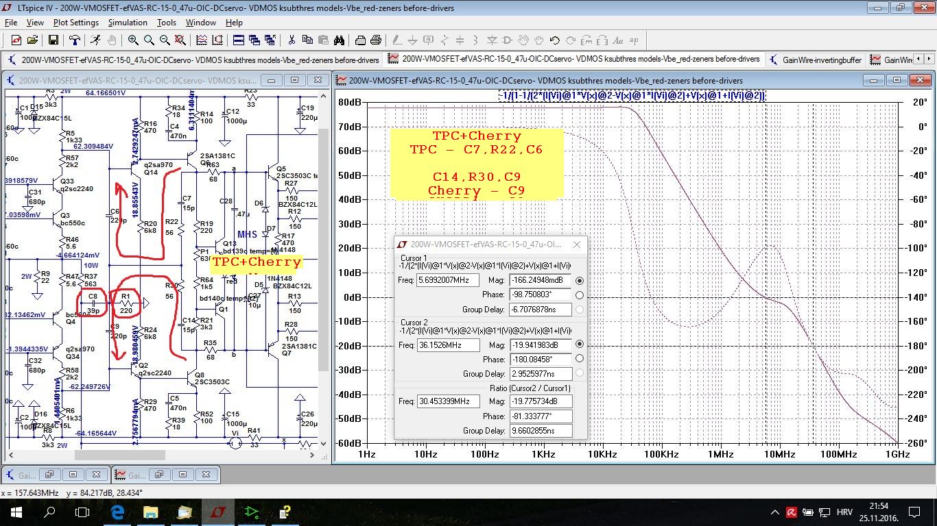

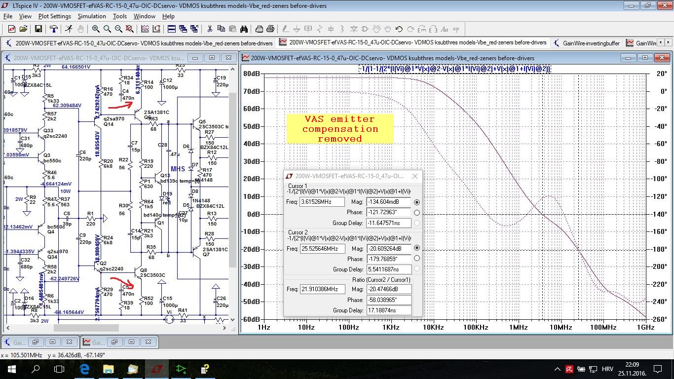

Compensation used in 200W CFA
Current on demand is important quality of CFA but compensation is most important here.
When I started this CFA compensation it was first with TPC:
upper leg: C7+R22+C6
lower leg: C14+R30+C9
and R1 to get two pole compensation around enhanced VAS.
PM not good enough.
After that Chary compensation added with C8 from the output to the TPC R1, actually to the enhanced VAS inputs and it improved the Phase Margin greatly.
The VAS emitter compensation added to improve the Loop Gain at higher frequencies. It increases ULGF to 5.5 MHz.
A crude calculation made before fine simulation tuning.
I hope this can help to explain the compensation used and it was quite easy with this CFA.
Damir
