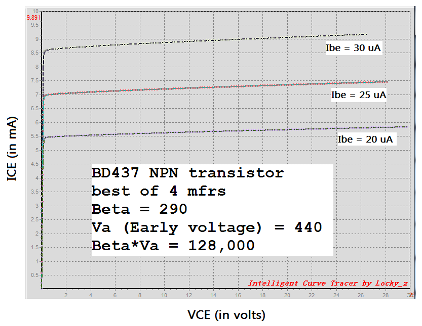

So far in my testing of PNPs the Sanyo 2SA1407E has been above average but not world-dominating on that Figure Of Merit.... a high figure of merit in regard to the product of Beta and Early voltage. High Early voltage alone is not that great if Beta is not also high
However the new (3rd) Edition of Art of Electronics has a handy table which suggests interesting candidates to study. One that leapt off the page was the medium power NPN device called BD437. As shown in Figure 1 below, numerous semiconductor companies offer the BD437 so I simply bought ten pieces from each manufacturer. The best of the best was pretty darn good, see Figure 2 below. Regrettably it's a relative low voltage (45V) device with relatively low fT (3 MHz), which places limits on its application.
_
_
BD441 it's 80 V same family.
