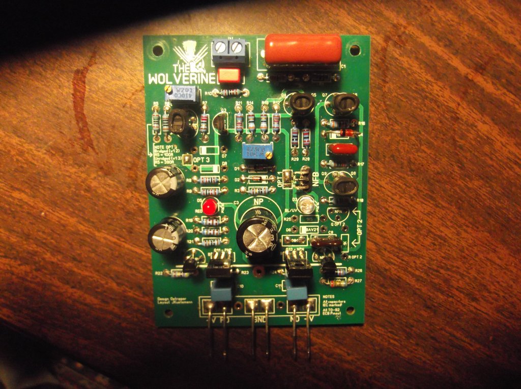

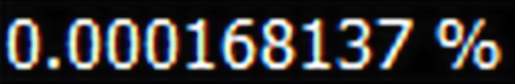

At the first moment i have imagined the tripple darlington was the issue..then i have removed the first from the three stages, re adjusted the floating emitter resistor to 220 with the output back to EF double darlington..
I cannot reduce this capacitor below 130pF without face oscilations...with three stages at the output, with two stages and tried even with a single stage... please, confirm this value.... and....if you wish, tell a little bit more about this circuit.... i know it was made to "see" higher impedance.
I have readed your excellent book, but sadly the circuit i chose to try if driving me crazy.
I have used a very modified circuit into the Mark One...but even this way the circuit is unable to work with 33pf..... less than 130pf it starts to oscilate.... wave form becomes an amplitude modulated carrier with some few Megahertz in the carrier.
Circuit really reduces distortion but square wave form resulted very bad....not a good slew rate...raise time no good.
Is this 30pf just a reference?
Thank you,
regards,
Carlos

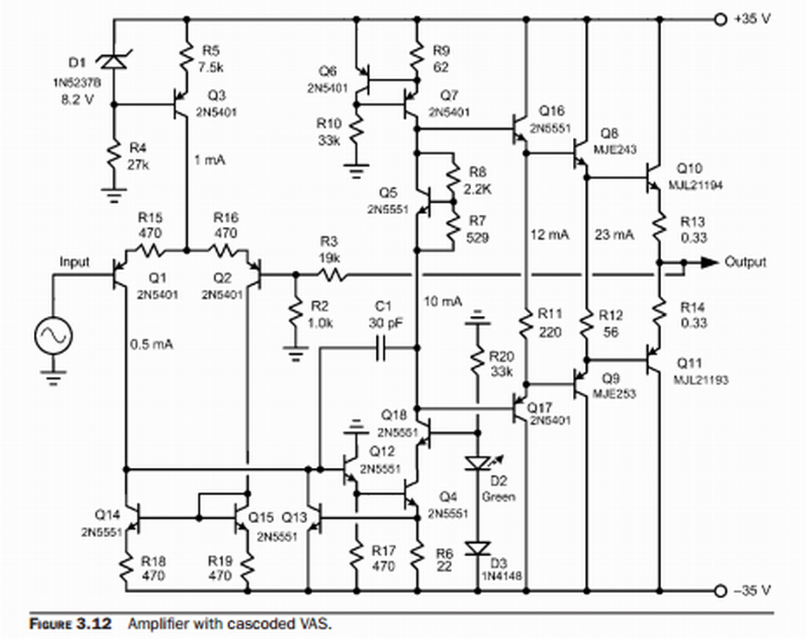

Page 68 dear Bob..... figure is attached... 3.12 is the fig. number
Question is simple...considering that i will be using the same output, is C1 value correct?
I need a simple answer...yes or no..then i will search for my own mistakes in the pcboard parasitic capacitances and inductances.
My circuit is modified..but current to VAS is the same and output i built the same to check this capacitance value.... i will modify my way...but i need to know if this value is correct or if was a revision mistake...maybe 130pf is the value, as i found it as the smallest stable value to use in my particular circuit.
Values in the VAS are different..but i made it the same as your schematic to check because my way was not working...but your way also not worked....i have built the VAS, and the output the same as your schematic in order to check the value..also the VAS current is the same you use..also the supply voltage is the same you use....made this way to check....then i will make it my way as the input is different in my circuit and also the output.
Thank you in advance by the time spent.

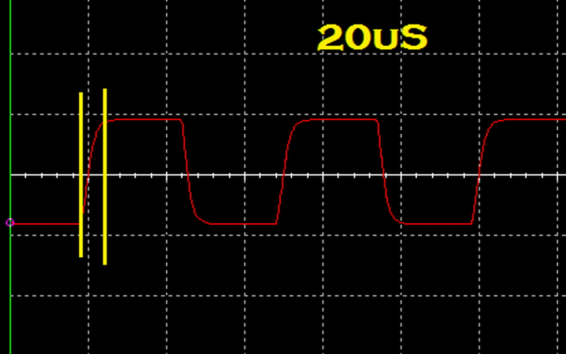

Raise time, in the Simulator and also in my scope resulted not that good
See.... 20 Khz raise time..... 1/3 power
So, i imagine some mistake i have made or revision error in your book...but i believe more in my own mistake as you are a great designer.
My unit, my particular unit...this one i have built.... is measuring even worse when watching the scope display....so....i do think something is wrong.
Sonic signature is nice.... very flat....no audible peaks in any particular frequency range.... well...my input and output, while listening, was very different than yours..also the values in the VAS different too.... returning to your schematic i found some peak in treble..despite the slew rate that sign to us that treble would be not that good....but was fine and the sonic signature felt into the treble at my home.

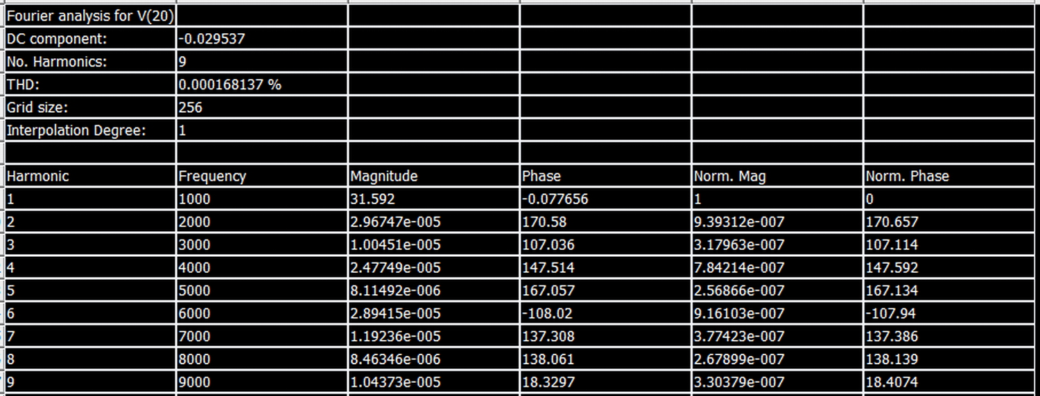

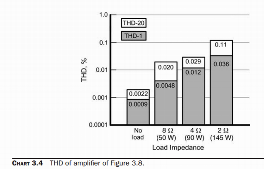

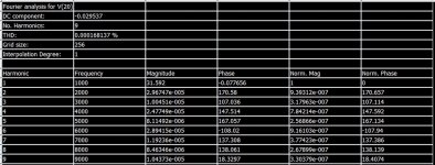

Your amplifier, dear Bob, can measure very low THD
Very good one.... have beated mine Dx Mark One.
Well....it can go lower if i figure out how to use 33pf as compensation
Your amplifier goes much lower than 0.0048% loaded with 8 ohms.... but have to tweak and get out from the exactly calculated values..some drift from the optimize values reduces THD.... some out of the box thinking.
Your Cascode VAS is a great contribution to our community.... great one.... i may use your circuit if i figure out (or if you help me) how to use 33pf as compensation.

Hi Mr. Cordell.
I have a question after seeing Carlos using your schematic in Fig. 3.12 in page 68 in your book.
I am hesitant in building a SS power amp for the reason that you described the complementary differential stage is superior because it's lower distortion. I always have a believe that for good sound, less is more. I really don't want to build the complementary differential input. Not only you have to double the LTP stage, you have to put in over current protection to avoid the VAS from drawing excess current. The more circuit, more more chance to cross couple and susceptible to EM interference.
Thanks and Happy New Year.
Alan

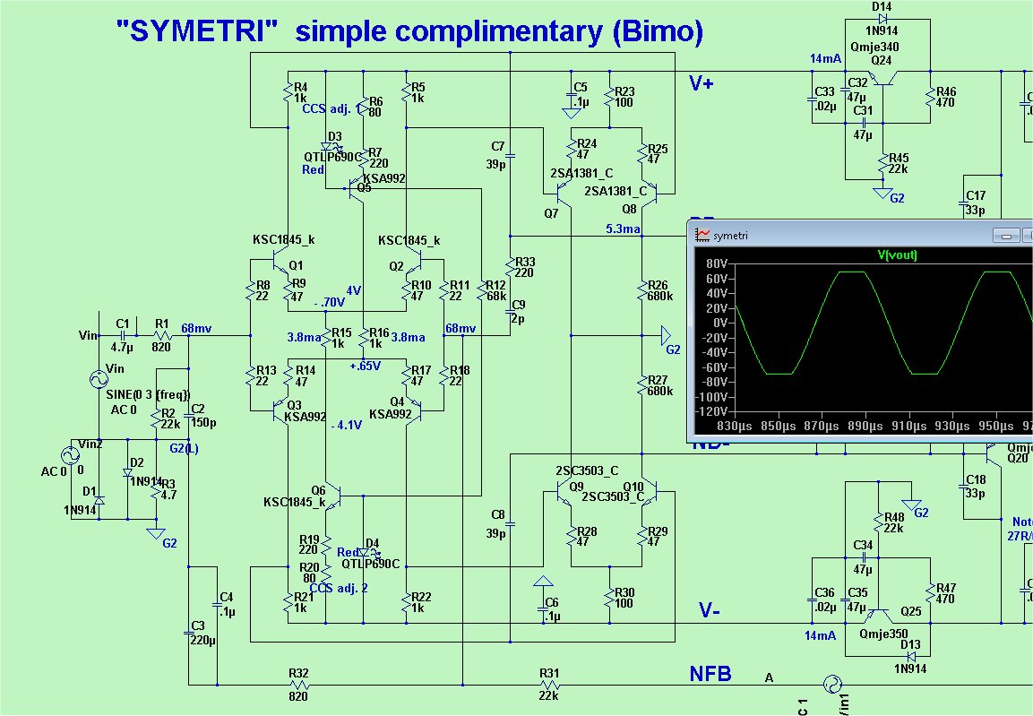

What's wrong with "obsessive complimentary".
They don't have to be complicated (below).
"What are the benefits" ?? OMG
10ppm - soft clipping - saturation is "tamed" - 150+v/us slew (even with a VFA).
- get this slew rate with 5ma VAS currents
I was a "LIN" fan up until a year ago - those days are gone.
Thermally, some of the complimentary's will cancel to the uA (VAS I).
PS- LIN is still good for "industrial" duty (subs /PA)

Bob's excellent example - better than Self ...
I wholeheartedly wish Carlos luck to use Bob's LIN example.
It works (below) ... I use it as my "tester" , as it is SO "rock solid"
at ANY rail voltage.
Spilled the wine on it - it still worked
PS - still , myself and most others prefer the "faster" complimentary
IPS's - they are more "engaging" (I no longer believe all amps sound the same).
