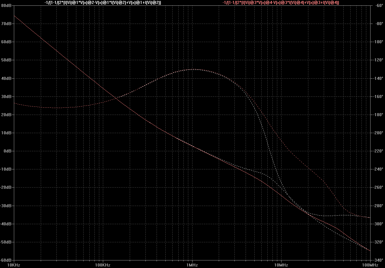

I've seen ... not a shred of coherent proof that an audio amplifier can be non minimum phase.
You may want to look at this one.
Clearly non-minimum phase, a surprise to me.
It is above the unity crossover frequency but sufficiently close to be of interest.
Pink trace is the result of an 820 pF capacitor in parallel with the VAS emitter resistor.
I have not yet worked out the details.

I should have used the term non-minimum phase and or with a right-half plane zero. The term all-pass generally implies a flat frequency response, which the VAS obviously does not have. The Miller-compensated VAS most certainly does have an RHP zero, albeit at a high frequency.
If you feed a Miller-compensated VAS with an AC current source, and you assume that the transistor has high beta and high ft, then almost all of the input current flows through Cdom. At most frequencies, the VAS then acts as an inverting integrator, with the collector current of the VAS transistor essentially equaling that through Cdom. To make this collector current flow, a small amount of voltage from the input current must appear at the base, and that voltage is inversely proportional to gm of the VAS.
At very high frequencies Cdom begins to look like such a small impedance that the voltage at the base combined with gm does not produce enough collector current to equal that of the current through Cdm. In essence, at high frequencies where Cdom is like a short, the transistor just ends up looking like a resistor whose value is 1/gm. In this case, the applied input current merely appears across this resistance non-inverted. The functionality of the Miller integrator has thus transitioned from inverting to non-inverting, and is a non-minimum phase device.
Miller-compensated VASs that are degenerated have lower transconductance, so the frequency at which the impedance of Cdom equals that of 1/gm is lower. With Cdom = 100pF and 1/gm = 25 ohms, that frequency is approximately 60MHz.

Nobody has said that the closed-loop response of an audio amplifier is non-minimum phase (at least at frequencies not significantly greater than ULGF). Nobody has said that a non-minimum phase characteristic is a good thing for an amplifier or a useful extra degree of freedom.
What was referred to is the open-loop gain. Specifically, I noted that the Miller integrator can be a non-minimum phase circuit.
Rather than making absolutist statements about what you perceive to have read, you would do better to ask for clarification of what has been said, since there is often a better way that could have been said. Oftentimes, what people say for reasonable brevity may have unsaid caveats. It is perfectly reasonable to bring these caveats to people's attention or give the poster an opportunity to clarify by citing those caveats. This is how reasonable technical discussions are carried out, and everybody learns, rather than being confused by a person picking an argument.
