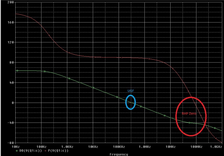

... a non-minimum phase system is one with singularities in the RHP, be they zeros or poles.
That makes a TIS a non-minimum phase system.
RHP poles don't make very satisfactory amplifiers.
I am somewhat surprised just how much non-minimum phase.

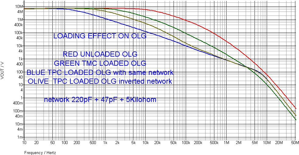

For a fair comparison, one has to compare apples and apples, which requires that the compensator component values be made identical in both cases.
Using the same network will indeed yield almost the same results
distorsion wise in the relevant band but at very high frequency
the VAS/TIS gain will be seriously shaped by the loading effect
of the capacitor that goes to its output , hence , the VAS/TIS high
frequency response with TPC wont be exactly the same as with TMC
wich doesnt suffer this loading to some extent , we could even assume
that connecting the bigger capacitor to the output node with TPC
will add some inherent shunt compensation , moreover with low
values of the grounding resistance.

In this case we would have a Miller OTA showing all pass property around the zero. There are of course well known ways to avoid this trap like a resistor in serie to make the zero negative or making the capacitor path unilateral ( Ahuja) . Then the positive zero disapears.
Simple SPICE simulation should demonstrate that the RHP zero does not give an all-pass characteristic to the transimpedance stage (TIS).
Secondly, as I have pointed out previously, the RHP zero is of no consequence if you use a BJT-based transimpedance stage, as it will typically reside well beyond forward path unity gain frequency. This may not be the case with a MOSFET TIS because a MOSFET's transconductance is more than an order of magnitude smaller than that of a BJT. This is why Miller compensation about a MOSFET TIS requires a resistor in series with the compensation capacitor.

As I have indicated previously, the RHP zero resides well beyond unity gain for a BJT TIS and is at a higher frequency than the first two dominant poles.
Therefore, at no point do you have a flat frequency response before unity gain due to the RHP zero. Moreover, due to the presence of non-dominant poles after the onset of the RHP zero it is highly improbable that you'll have a flat all-pass frequency response even after the RHP zero takes effect.
That's unreasonable Mike and not at all required for an apples vs apples comparison.
I'd agree to an equal number of components, but if resistor in TPC is 10k and in TMC is 8k, that is still a perfectly reasonable apples-to-apples.
of the capacitor that goes to its output...
This need not be the case. If loading of the TPC network on the TIS's output is an issue, simply connect the larger of the two capacitors to the input of the TIS. Problem solved.
I disagree. Profoundly.
The only fair comparison is one that guarantees the same loop gain about the output stage with TPC and TMC, and, simultaneously, gives virtually the same unity loop gain frequency and stability margins.
The above can only be guaranteed by using the same compensator component values for TPC and TMC as I have previously demonstrated.
Hi Mike,
There are many combinations of C1, C2 and R1 that satisfy both of your criteria to a quite adequate degree of accuracy. I suspect that you have not done enough simulations with different ratios of C2 to C1 where the ULGF has been held the same and the amount of loop gain about the output stage at 20kHz has been held the same.
For this reason, it is not necessary to make all fair comparisons between TPC and TMC with identical values of C1, R1 and C2.

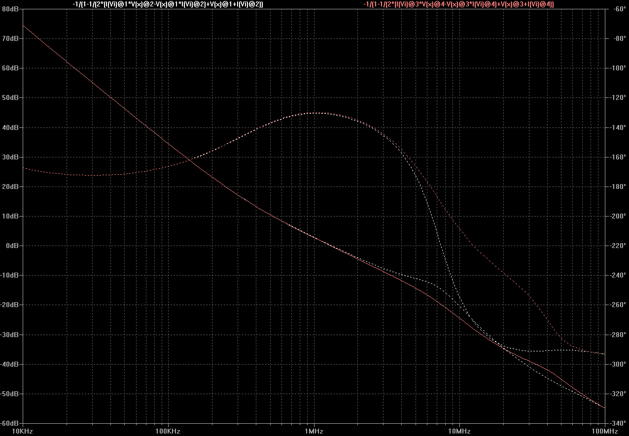

Hi Jan; good to hear from you.
Actually, the resistor in both compensation schemes (TPC and "TMC") establishes the location of the LHP zero that is required to restore a single pole roll-off (from an initial double-pole roll-off).
Now, if the loop transmission of the whole amplifier with TPC is to be the same as the loop transmission about the second stage and the output stage with "TMC", and, additionally, if the two schemes are to give virtually the same unity loop gain frequency and stability margins for the loop enclosing the second stage and the output stage with "TMC", and the whole amplifier with TPC, then the location of the zero must be the same. This is why the resitor in TPC must be identical to the resistor in "TMC" for an apples and apples comparison.
I demonstrated this by simulation a while ago in this thread.
Not solved but slightly displaced.
But why not checking all thoses loading effect with simulators.?

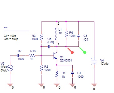

To summarize (for large Cmiller and gm2):
gain bandwith : gm1/2piCmiller
freq of zero : gm2/2pCmiller
non dominant pole : gm2/2piCload this non dominant pole is created in the OTA, it is not a non dominant pole coming from the class AB buffer poles although the input capacitance of this buffer is included in Cload.
If Cmiller is >> Cload the zero is at lower frequency than the non dominant pole. From a phase point of view, a positive zero acts as a pole. To be able to stabilize such a circuit, this singularity should be at least 3 times the GBW frequency to have enough phase margin ( rule of thumb), this can be achieved with gm2>3 gm1
In this case we would have a Miller OTA showing all pass property around the zero. There are of course well known ways to avoid this trap like a resistor in serie to make the zero negative or making the capacitor path unilateral ( Ahuja) . Then the positive zero disapears .
If these tricks are not used, the OTA stage is non minimum phase because it has a positive zero and the amp with feedback is still non minimum phase because if I recall well a basic property of control theory: the zeros of the open loop transfer function are the zeros of the closed loop function.
Using Blacks formula: F(s)= G(s)/1+G(s) H(s) if G(s) = N(s)/D(s) then
F(s) = N(s)/(D(s) + N(s)H(s))

Mike, you have demonstrated loadsa stuff. Alas ALL your demos (at least the SPICE sims) seem to have appalling THD & stability. IMHO, none of them would be stable with 'real life' loads.michaelkiwanuka said:I demonstrated this by simulation a while ago in this thread.
Few of us are concerned with the difference between pig sh*t and cow sh*t. Apples & oranges would be better compared in something with some semblance to a 'good' amp.
Bode plots on sims of wonky amps look testicle but it would be good to show improvements of your beloved TPC against TMC on something with 'good' performance. 'Real life' would be nice but you seem to spurn any such evidence.
In the meantime, SPICE THD & stability with different loads will do for a start.

Waly, if I read you correctly, your 'reliable measurements' are solely about Loop Gain and Phase Margin. Can you confirm this?Waly said:I was able to confirm through reliable measurements in our university lab that TMC and TPC are exactly equivalent. This should be understood in the sense that given a TMC compensated amp, there is a TPC compensation that provides exactly the same loop gain and phase margin.
What others measured on power amplifiers, I have no idea, but I am not under the impression this forum is anywhere focused on reliable lab measurements.
I'm rather saddened that you discount the efforts of those who at least attempt 'real life' measurements. I for one am far more interested in these than dubious pontificating by various pseudo prophets.
While I'm happy to generate pages of semantic and pedantic diarrhea, I'm under no illusion that these even approach the practical usefulness of my 'Definitive Dissertation on VAS vs TIS'
Ok
Ok
Don't understand "non-dominant pole created in the OTA". Who is Cload other than the next stage input cap?
Why would one make Cmiller >> Cload? I would think this would be highly unusual in audio amplifiers.
Ok
Ok, this condition is practically always fulfilled in audio amplifiers.
In this case we would have a Miller OTA showing all pass property around the zero. There are of course well known ways to avoid this trap like a resistor in serie to make the zero negative or making the capacitor path unilateral ( Ahuja). Then the positive zero disapears.
There are essentially three methods to compensate RHP zeroes: as you said, a resistor in series with the Miller cap, a voltage buffer [1], or a current buffer [2]. See also http://www.ece.ucdavis.edu/~hurst/papers/MillerComp,CAS1.pdf and http://dr.ntu.edu.sg/bitstream/handle/10220/4680/Gain-Enhanced%20Feedforward%20Path%20Compensation%20Technique%20for%20Pole-Zero%20Cancellation%20at%20Heavy%20Capacitive%20Loads.pdf?sequence=1
If all these are happening beyond the UGF (which seem to be always the case in audio amplifiers), then what would be the relevance? In fact, you don't even need an OTA to get the same results; a simple common emitter circuit will reveal the same effect, see below. As I mentioned before, each and every common emitter (or source, or cathode) gain stage has a RHP zero, because of the Cob (or the equivalent for tubes, jfets, mosfets, etc...).
Outside audio, there are indeed cases (like in CMOS opamps, where due to the low transconductance of the devices the RHP zero can indeed occur around or before the UGF) where taking care of the RHP zero really matters. Otherwise, in my opinion, unless one chooses a pathological audio design only to make a point, the RHP zero issue in audio amplifiers can be safely ignored.
[1] P. E. Allen and D. R. Holberg, CMOS Analog Circuit Design. London, U.K.: Oxford Univ. Press, 1987.
[2] B. K. Ahuja, “An improved frequency compensation technique for CMOS operational amplifiers,” IEEE J. Solid-State Circuits, vol. SSC-18, pp. 629–633, Dec. 1983.
