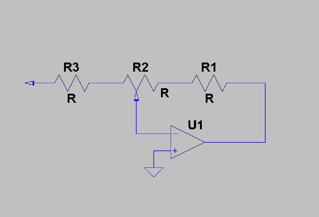

Just barely on the same subject, I found a useful page here:
Resistor's behavior at HF and VHF.
So a 100k resistor at the emitter probably contributes .33pF or so. I contacted the author and he said if the resistor were lowered from 3/8" to 1/4" to the ground plane, capacitance to ground would increase by .33pF. So, capacitance of that resistor should not be more then 2pF I think, even if you use a ground plane.
On the topic of passive components, maybe you can discuss this in your book?
Bruno Putzeys r4 random rants, raves and ramblings
It is interesting that a linear pot would give very low distortion. Based on this, Rod Elliot's mod to make log pots out of linear ones could be one of the best volume control options. However I'd really like to see what Bruno envisions when he mentioned putting it in the feedback loop. Shunt, series, or feedback from the wiper? Any of these options could be done safely with bypass resistors, unless the point is to present the wiper with the full opamp input impedance and minimize current.
I'm not sure if this is what Bruno had in mind.
I used this many years ago to get a log response from a linear pot.
