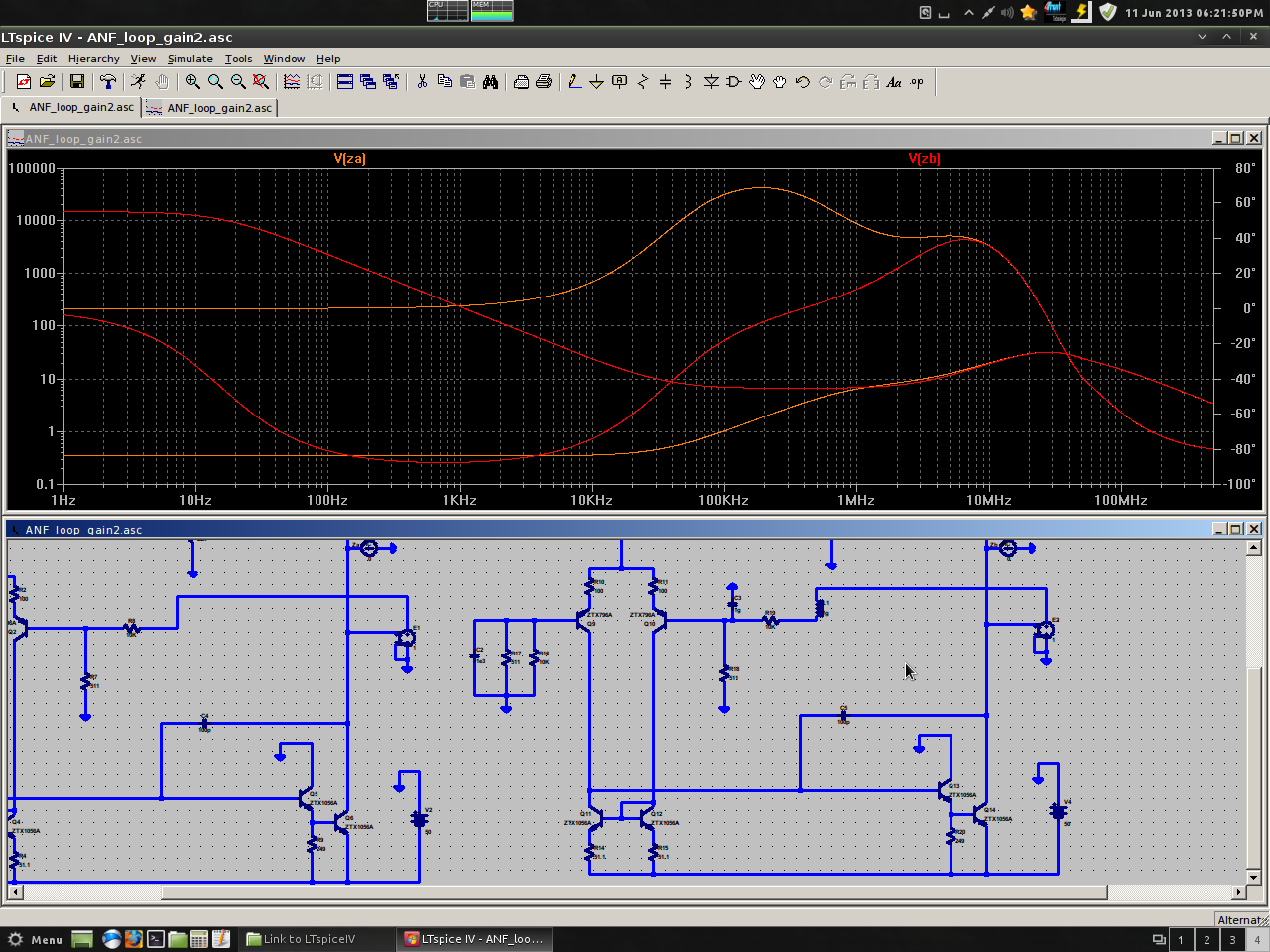

I did, and again got a different result.

The major feedback loop has no impact, at least to a first order, on the output impedance of the TIS. You can confirm this by disabling the major loop by means of a large capacitor shunting the inverting input of the amplifier to ground or using a large inductor in series with the inverting input of the amplifier.
Further, Bob, I have also demonstrated that the minor loop has no effect on the loop gain of the ANF current source. Why do you find this so difficult to appreciate? :scratch:
Tomorrow I'll do as you've asked; viz. run a sim of the loop gain of the current source with a resistive load.

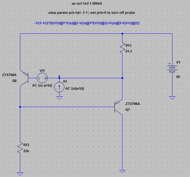

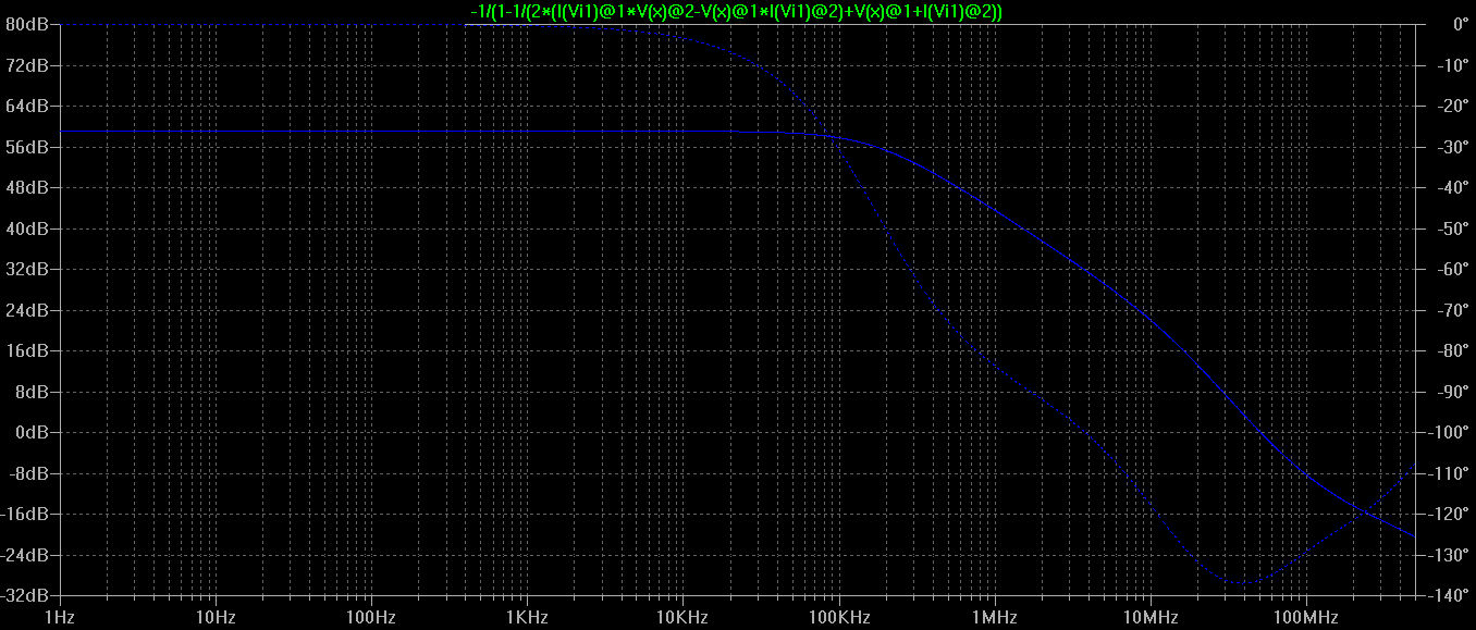

The figure below shows the loop gain of the amplified negative feedback current source in isolation with its output short circuited to ground. The asc file and transistor models are also included.
Bob, I think it is now apparent why loading the current source resistively is not a good thing, so I shall not be running that simulation I promised you after all.

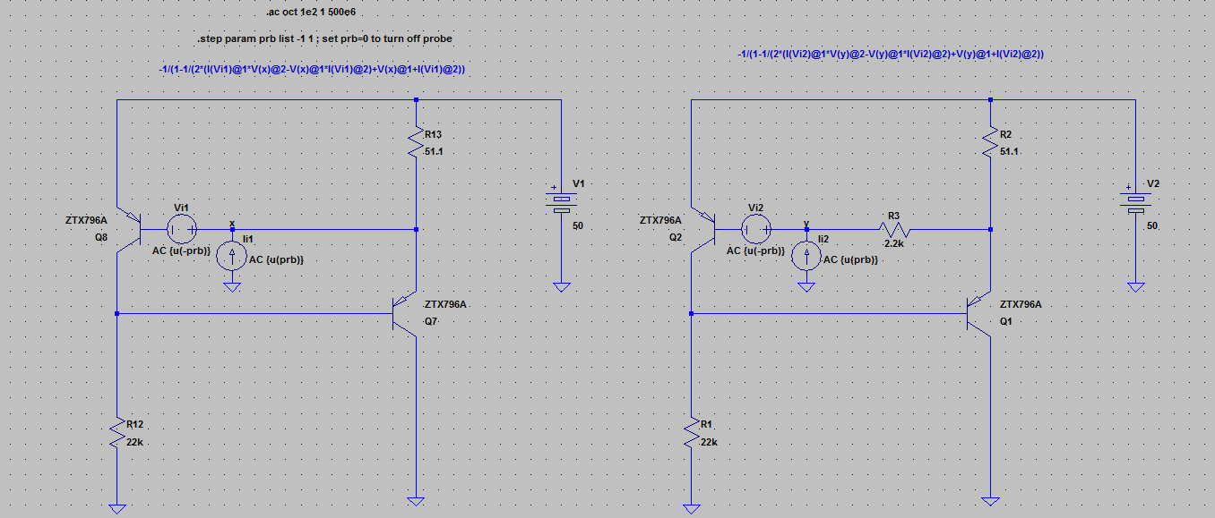

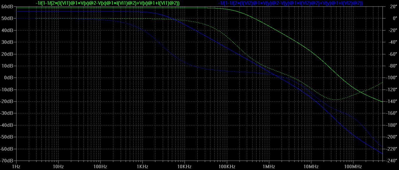

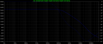

You'll recall that I indicated somewhere in this thread that placing a resistor in series with the control transistor in the amplified negative feedback (ANF) current source reduces loop gain. This remains true as shown below.
Of interest, however, inclusion of the 2K2 resistor also reduces the unity loop gain frequency drastically; in this case from 50Mhz (phase margin~44 degrees) to just under 2Mhz (phase margin~83 degrees).

As far as I am aware nobody has reported instability local to the ANF current source in the absence of the resistor in series with the base of the control transistor in amplifier applications.
Therefore since the 2K2 resistor reduces loop gain at 20KHz by 20dB its inclusion may not be a good thing.
Presumably this reduction in loop gain is due to the low pass filter effect that occurs with the resistor in conjuction with the input capacitance of the control transistor.

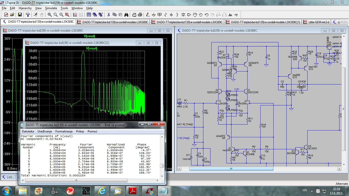

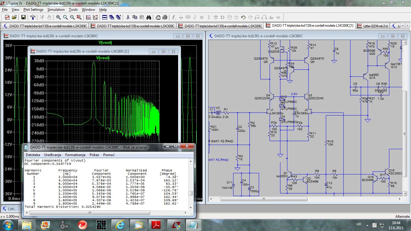

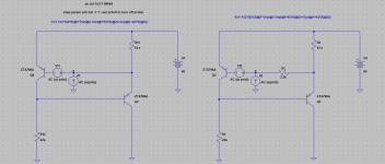

Hi Bob,
I used driving the input cascode bases directly from the input tail in my TT amp http://www.diyaudio.com/forums/solid-state/182554-thermaltrak-tmc-amp-2.html#post2634734 and you suggested this to me(actually to use aditional BJT to do that, Q9 in this case).
I simulated a bootstraped input cascode and connected to the ground and difference in distortion eas huge. It could be because I used fets for the LTP not bjts.
BR Damir

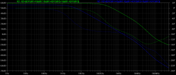

Hi Mike,
Thanks for running these simpler simulations and arriving at the higher loop gain. It looks like we are all on basically the same page, now.
Loading the current source resistively is OK, but only if it does not allow a too-large amount of gain in the common-emitter-connected control transistor. But testing the feedback current source in isolation while it is loaded into a short is best.
With respect to the series base resistor, I think its use is a matter of degree. As you pointed out, a 2.2k value greatly reduces the loop gain to a point that it may interfere with the goodness provided by the feedback action. It does, of course, give us a more comfortable phase margin in the feedback current source loop. At the same time, zero resistance may often give a phase margin that is smaller than we'd really like.
So perhaps an intermediate value of that resistor is what would be good. Maybe a couple hundred ohms. Enough resistance to bring the ULGF of that loop to 10MHz or less is probably enough.

Hi Bob,
BR Damir
Hi dadod,
Great piece of information. So this would argue that the effect of common-mode HF distortion is indeed revealed by SPICE, if I interpret what you are saying correctly. I note that these pictures you show are for 20kHz THD.
As you point out, you are using JFETs for the LTP, not BJTs. And JFETs can be a bit more prone to CM distortion, so it is conceivable that that could account for the difference between your experience and that of Self.
BTW, it would be easy for you to complete the experiment by changing the simulation slightly to connect the cascode base driving signal to a replica of the feedback signal instead of to ground or the tail. That would answer the question, at least for the case of your amplifier, whether there is much difference in driving the cascode from the tail or a replica derived from the output.
Bob

Hi dadod,
Bob
Hi Bob,
Thank you Bob, and here is next simulation were the cascode base driving signal connected to a replica of the feedback signal, with a bit worst result then if driving from the tail. Could be because the phase difference?
BR Damir
