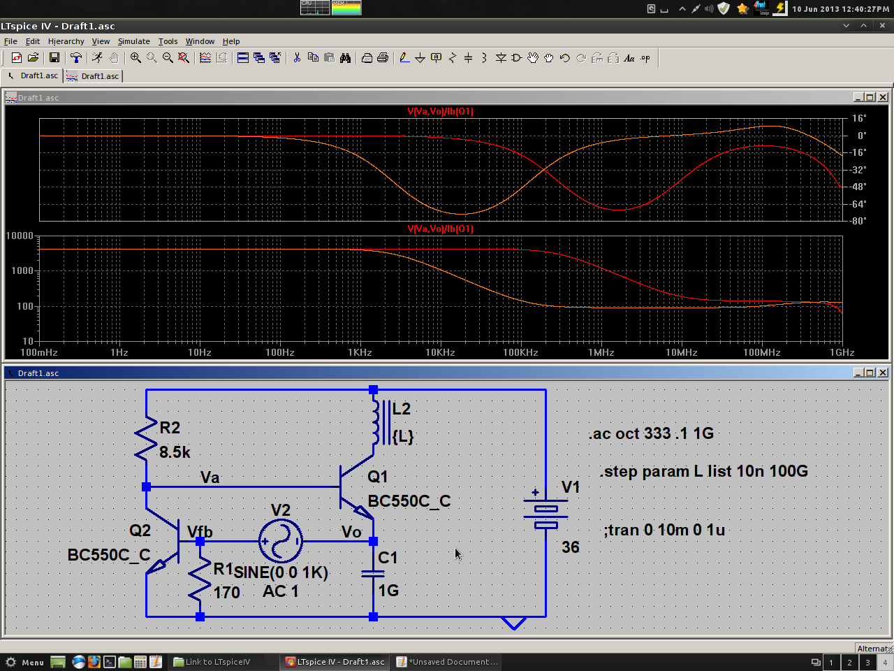

Well, base resistance interferes significantly. So what? Using a high impedance load alters the internal loop, making the results wrong.
  • Screenshot from 2013-06-10 12:40:27.png
I have no idea what you're talking about; which "base resistance" are you refering to? I cannot make head or tail at your attempt to simulate loop gain of the ANF current source.
Do you even know how to use the "Tian" lope gain probe in LTSpice? If so, why haven't you used it?
Anyway, I don't owe you an explanation for anything. I have demonstrated to my satisfaction the typical loop gain of the ANF current source. That is sufficient.
I never said you owed me an explanation. But it would be appreciated because we can't both be right at the same time. It is strange that you would stop talking now when you are normally so eager to tell us how wrong we are.
Those were not actually attempts to simulate OLG, and because Rbe and Rm are ratios, in AC analysis it doesn't matter anyways. As long as there is a stimulating source the impedances only need to be derived from local signals.

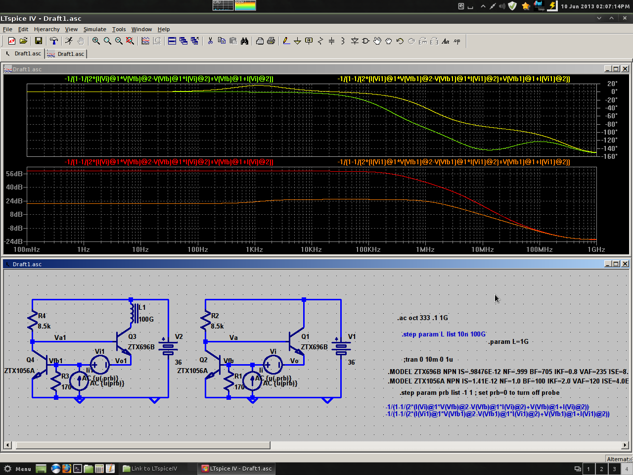

Here is the loopgain. Nothing changes.
Of course, because feedback is not taken from the output, loopgain tells us nothing but whether the circuit is stable. Notice that when simulated correctly, phase margin dips to 37 degrees.

Running the current source in isolation is precisely what I am doing by isolating it from the rest of the circuit with a very large inductor. The use of a large inductor for this purpose is routinely recommended by such luminaries as Rosenstark, Sedra and Smith.
Err.rrh! They recommend using a large inductor to isolate a Voltage source or something with rather less Z than a 'current source'
You cannot obtain valid results by simply connecting the current source to a voltage source via a resistor because that resistor would define the output impedance of the current source giving wildly inaccurate results.
But you aren't measuring its output Z. You are measuring Loop Gain. For this you want to isolate the current source from other stuff. To do this, SHORT OUT IT'S OUTPUT.
If you want the Loop Gain of the CCS in situ with the effects of OPS, Ccb etc, remove the inductor.
If you want to measure its output Z, then use your inductor and connect the other end to earth.
If you want to know the relative effect of OPS on VAS & VAS on OPS, use your inductor and measure Z on either side of the inductor. I do this in #2877 http://www.diyaudio.com/forums/solid-state/171159-bob-cordells-power-amplifier-book-288.html#post3475959
I have never heard of an inductor being described as a current source by anyone; it is no such thing.
Rather, the inductor is a virtual open circuit at all frequencies of interest allowing the output impedance of the current source to be defined solely by the output impedance of the source BJT.
Err.rrh! Isn't a perfect current source 'a virtual open circuit at all frequencies of interest' while supplying a DC current (or a controlled current for a VCCS etc)?
The description of an Inductor as a current source was used by many basic electronic texts in da old days to describe the evolution of simple amplifiers from a single BJT with collector resistor ... to full Class B with LTP i/p .. sorta the Jurassic prelude to Bob's Fig 3.1
It is also the basis of many Golden Pinnae SE amps bla bla.

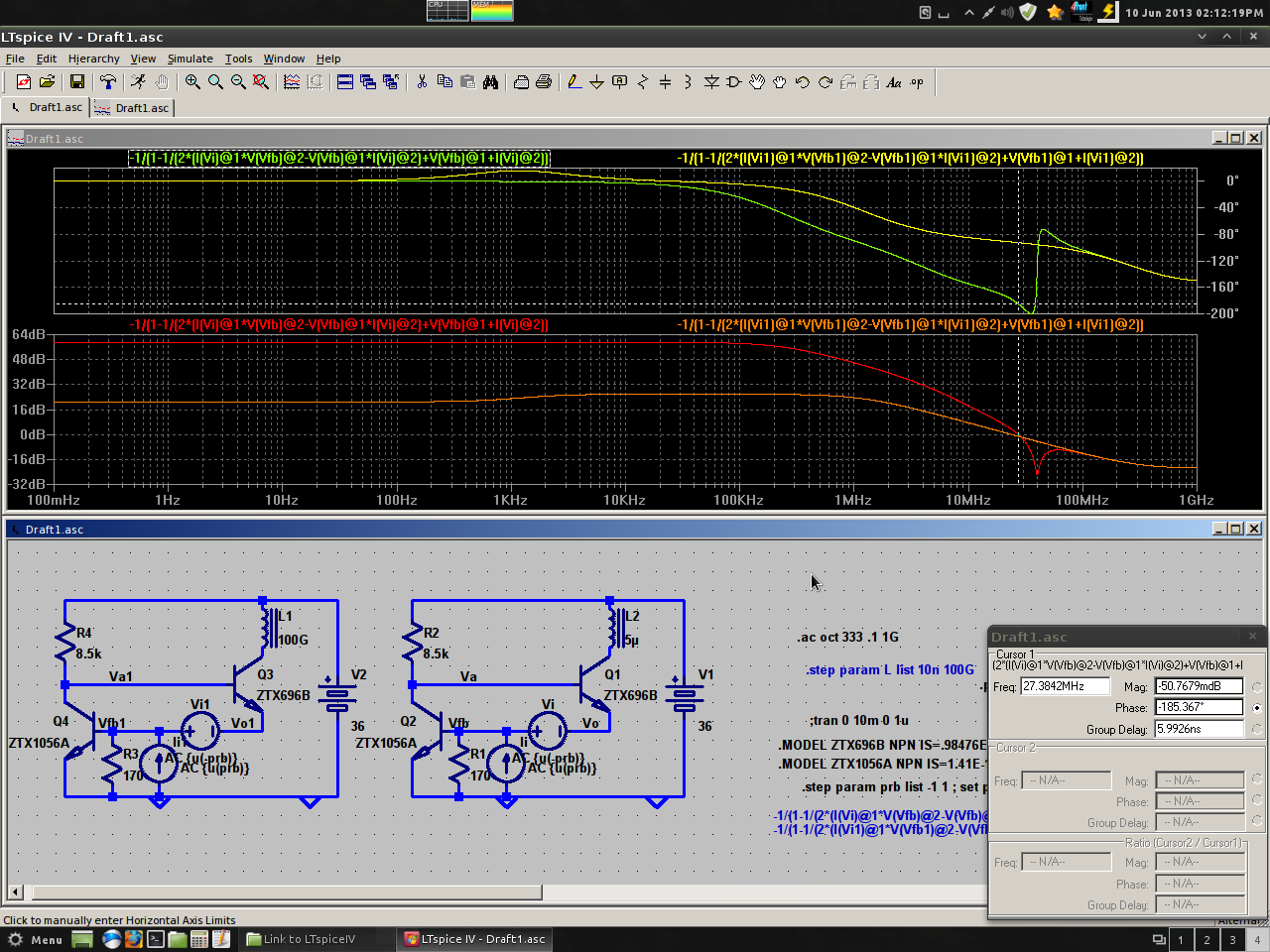

For the same reason that some voltage regulators/amps oscillate with capacitive loads, I can provoke oscillation in this "unconditionally stable" circuit with a 5uH inductor at the output. Not applicable to most circuits, but worth knowing, and even more worth understanding.
But wait, with your loopgain simulation, we have false results and no way of testing stability into any legitimate load. Oops!

Using a current source, as you did in your analysis, is unrealistic and probably explains your somewhat exaggerated loop gain result. I used a more realistic resistor.

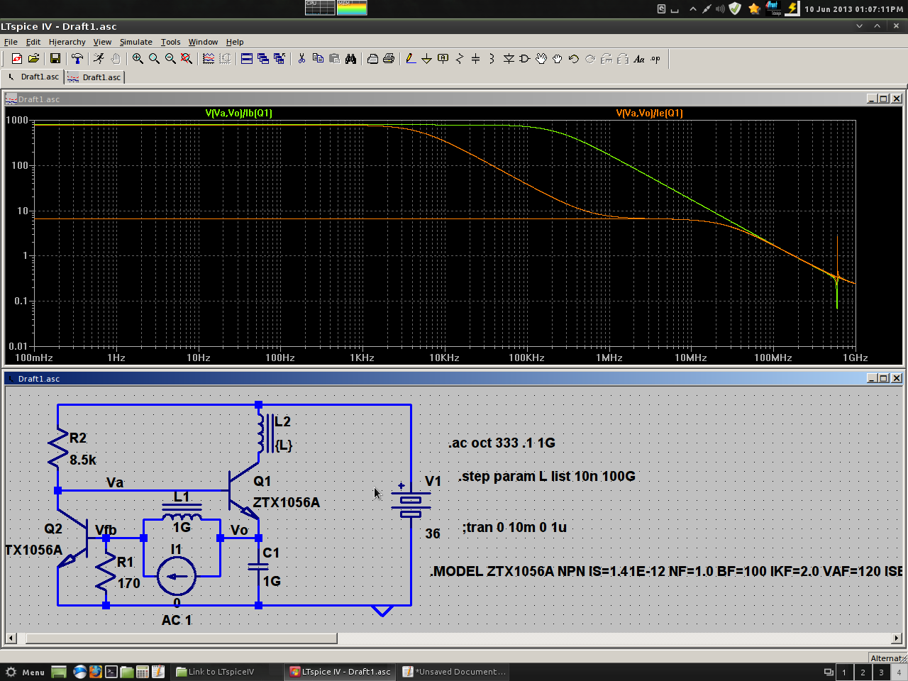

Feeding it with a current source gives us the worst case. Using 22k instead makes only a small difference in the end result, assuming your transistor beta is 100.
A huge inductor is a virtually infinite impedance at AC, but it allows DC current to flow, some in some regard it acts like a current source in the AC domain. My use of the term current source was poorly chosen, but you should have gotten the picture anyway.
As I suggested, you should run your own sanity check with the current source by itself. The complexity of the way in which you are trying to simulate a fairly simple issue is undoubtedly tripping you up.
