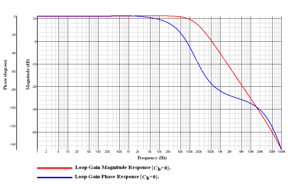

Bob, I suspect this resistor was used by Self to protect the control transistor in the event of the current source transistor failing short circuit. This is exceedingly unlikely.
Harry, I doubt that the amplified negative feedback (ANF) current source could be a source of instability; its loop gain barely exceeds 10 db, and, moreover, its phase margin exceeds 90 degrees at a unity loop gain frequency of only 500KHz. See figure below.

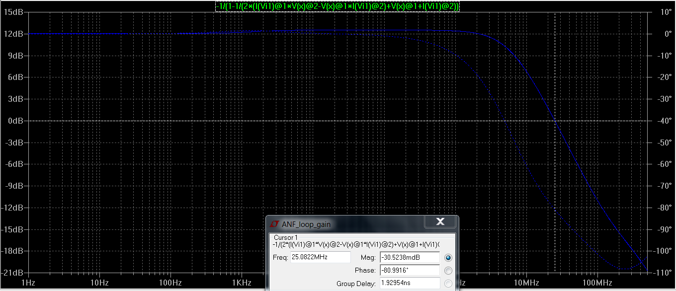

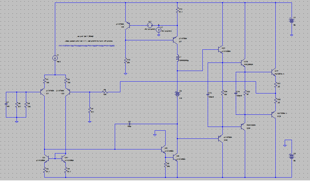

Hi Bob,
I simulated the loop gain of the ANF current source circa 2004 for an unpublished 103pg article I wrote on double pole compensation and the push-pull TIS.
I simply used the Adel S. Sedra and Kenneth C. Smith (to be found in their book "Microelectronic circuits") method of measuring loop gain in SIMetrix.
Similarly, you can measure the ANF current source's loop gain in LTSpice by placing the so-called "Tian" loop gain probe (which is really a Middlebrook probe) in series with the base of the control transistor and decoupling the current source transistor from the collector of the TIS in a Thompson topology amplifier by means of a very large inductor. The results are shown below.
In this case the loop gain is of the order of 12dB and phase margin is 100degrees at unity loop gain frequency of roughly 25MHz. Note that loop gain increases slightly as the reference resistor, to which the current source's base is connected, is reduced in value; the unity loop gain frequency also increases. It is not immediately apparent, to me anyway, why this is the case.
I have attached the asc and the relevant models for those interested in running the simulation.
Unless you can point out shortcomings with this approach I believe my results are correct. P.S. where did you get that 6K value from? :scratch2:

Hi Mike,
Your problem appears to be the use of the very large inductor. It does not allow the current source transistor to function normally. The inductor is superfluous to the simulation anyway.
This sort of thing is why we always want to be able to do a simple sanity check on our results.
The 6k is simply the approximate input resistance as seen at the base of the current source transistor - it is the 60-ohm RE multiplied by the transistor's beta of 100. It is the dominant load for the common-emitter configured control transistor.
Let me know if there is something you think is wrong with my simple loop gain analysis.

Bob, the inductor is not a problem. It is required to isolate the current source from the singularities of the rest of the circuit so that only the loop gain and the singularities local to the current source can be ascertained.
The input resistance or impedance at the input of the current source BJT is not 6K: it is more like 6k in parallel with the resistor delivering current to both the control transistor's collector and the source's base.
Mike, with regard to the 6k, you are right, but note that in my simple analysis I stated that the current to run the control transistor was a current source.
You need to run the current source in isolation. You do not need to run it inside an amplifier to analyze whether such a current source has a certain amount of loop gain. We are just talking about a 2-transistor circuit here. Get rid of the inductor and just run the current source by itself, with the output of the current source connected to the supply or though a resistor of reasonable size to the supply.
In the approach you are using, you are basically loading the current source with a current source, which is what the huge inductor is at AC. We don't test current sources by loading them with a current source.
Using a current source, as you did in your analysis, is unrealistic and probably explains your somewhat exaggerated loop gain result. I used a more realistic resistor.
Bob
Running the current source in isolation is precisely what I am doing by isolating it from the rest of the circuit with a very large inductor. The use of a large inductor for this purpose is routinely recommended by such luminaries as Rosenstark, Sedra and Smith.
You cannot obtain valid results by simply connecting the current source to a voltage source via a resistor because that resistor would define the output impedance of the current source giving wildly inaccurate results.
I have never heard of an inductor being described as a current source by anyone; it is no such thing.
Rather, the inductor is a virtual open circuit at all frequencies of interest allowing the output impedance of the current source to be defined solely by the output impedance of the source BJT.
The inductor greatly increases the impedance at the CCS collector, increasing the magnification of its miller capacitance and Early effect. What you need to give it is a voltage source+resistor at the collector, not a high-impedance load. This is what will emulate isolation, not an inductor.
No. Read "Feedback Amplifier Principals" by Sol Rosenstark.
I have had a 2-Q CCS oscillate, and a 2-Q current mirror oscillate. So there is more to it than this.
With an inductor at the collector, open-loop gain will dramatically worsen due to the output transistor's Rin=Rm. A collector resistor effectively turns the output transistor into a C-B diode across the first transistor, regardless of static Vce. Measure Rm and Rin of the output transistor in your simulation. You'll find it's much different with and without an output inductor.
BTW, the feedback in that CCS is not at the output. Therefore Zout is paralleled by Zcb of the output transistor. It is analogous to putting a resistor in series with the output of any voltage amp.
