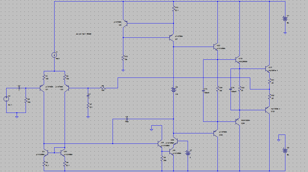

At what frequency was the peaking, and how much peaking was there.
I assume this was at the output of the amplifier. Dis you look at peaking at the collector of the VAS?
The closed loop frequency response peaking was at 30MHz at the output of the amplifier as shown below. The response at the output of the TIS was virtually identical. As noted previously, you need at least 220pF shunt capacitance at the output of the three transistor TIS to eliminate the peak.
I used Zetex models for the input stage and the TIS. These are also attached, together with the models for the drivers and the output stage; you can compare them with your models.
Hi Mike,
Thanks for providing this closed loop response.
You certainly have demonstrated a fairly sharp peak in the closed-loop response above the ULGF.
But this is not my amplifier.
Please sim this with the component values in my design, if not with the transistors and models I used.
You have made several changes to the design which can influence behavior. You have much higher transconductance in the LTP and correspondingly higher Cm of 100pF. Please use my Cm design value of 30pF. Please use the operating currents that I have used in the LTP and the same degree of degeneration in the mirror. You are running much higher current in the EF preceding the VAS transistor. Please use the amount that I use. Please use emitter degeneration on the VAS transistor, the same value I have.
Once you have done this, it is also a good idea to do a sanity check on the role played by the cascode by seeing what results you get by removing the cascode transistor.
It is significant that you have demonstrated this behavior in a Darlington cascode VAS, but it is also important to demonstrate whether this serious peaking behavior occurs in my circuit.
It is also significant, and in fact somewhat reassuring, that you have shown that in fact this local instability does indeed show up in the closed loop response.
Bob

Michael, I don't understand your reluctance to sim Bob's circuit as is.
I have simulated Bob's circuit "as is" and still obtain the same results.
I don't know how many times I have to tell you this, but read the following carefully this time: I have simulated the amplifier with the TIS emitter resistor and found that it compromises stability of the minor loop. Your notion that it aids stability is a complete myth in all respects. I hope you don't compel me to repeat this yet again.
I don't know how many times I have to tell you this, but read the following carefully this time: I have simulated the amplifier with the TIS emitter resistor and found that it compromises stability of the minor loop. Your notion that it aids stability is a complete myth in all respects. I hope you don't compell me to repeat this yet again.

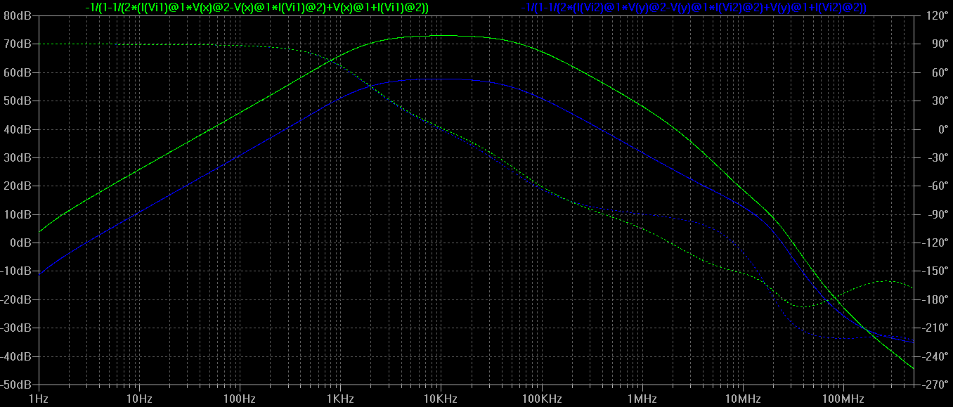

Bob, minor loop phase at unity gain with emitter resistor 192 degrees. (blue trace);
minor loop phase at unity gain without emitter resistor 185 degrees (green trace)
You can do the closed loop frequency response plot yourself if you wish; i've attached the file.
Hi Mike,
I think I'll leave that to you since I have provided the .asc and the models I used.
