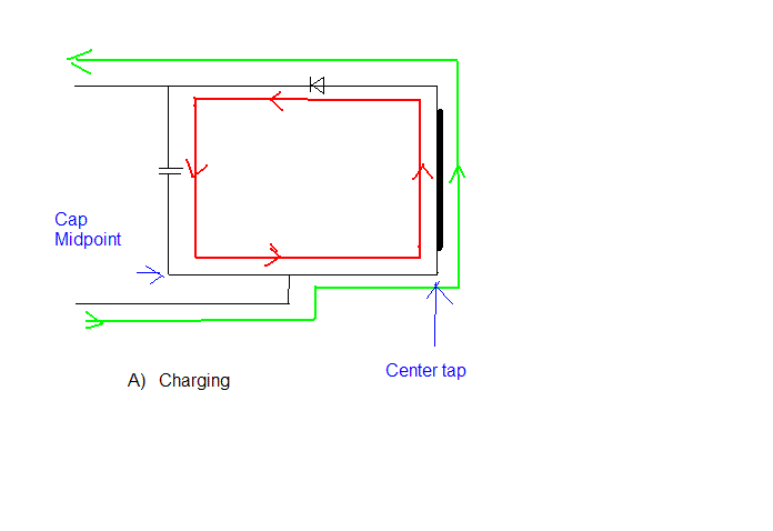

Case A is when the diode is forward conducting and charges the caps. In this case there is both load current and charge current flowing in the circuit.

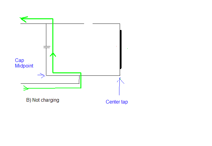

Case B is when the diode is reverse biased and no charging takes place. In this case the loop through the winding can be considered as broken, so the load current flows back to the caps instead of the transformer. This is usally the case for most of the time. I omitted the diode in this case to emphasise that the loop is broken.
It is clear then that there is always current flowing through the cap midpoint, but only sometims is there current flowing through the transformer center tap. So to answer Mikes question "what happens at the center tap", most of the time nothing happens at the center tap.

Christer said:
I should also point out that i deliberately returned the load current to a point between the cap midpoint and the center tap in order not to have a preconceived notion of where it should be returned. As soon as we choose either point as our return point, then all current will pass through that point because of our decision.
Preconceived or not, the amplifier return should be attached to the capacitor as short as possible. The AC voltage drop of the charging ripple current on the wire marked yellow will be seen by the amplifier no matter how good the cap is. In fact, the better the cap (closer to AC short), the worse it gets.
It makes no sense first paying obscene amounts of money for first class low-inductance, low-resistance capacitors and then making sure that one doesn't get the advantages.

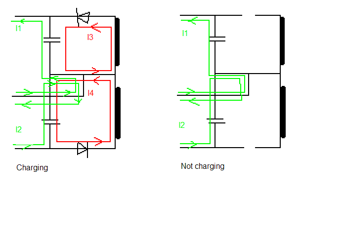

OK, here we go.
I ignore the cases where only one rail is charging, but that should be straightforward from these two cases.
Then you have to sum currents, of course, to find out in which direction current is actually flowing in the varios ground leads.
taking the simpler (not charging) diagram first.
If the two rail currents are equal (I1=I2) then the current in the middle wire is zero.
That was your first observation (no current in the leg to the ground).
That also means no current in the horizontal wire from cap common to the ground wire. This is the situation that was referred to earlier by others.
Now look at the situation when the two rail currents are not equal.
I1 does not cancel with I2.
That means that there is current flowing in the middle wire.
This current is exactly equal to the difference between the two rail currents.
Now. let's consider what this unbalanced current is.
The voltage amplifier draws quiescent current. often these quiescent currents are very similar on the two rails, but they do not have to be identical, in fact it would be very difficult to design them to be identical. However, these quiescent currents are essentially DC currents and will not modulate the voltage on the rails.
The next current drawn from the rails is the output bias. This again is a DC current.
Finally we arrive at the current that we really need, the load current. Since we are dealing with dual polarity supplies and a push pull amplifier, this next part applies exclusively to this case.
The load current is supplied by one half of the output stage. the other half cuts off. This load current is exactly equal to the increase in one rail current plus the decrease in the other rail current (Iload=I1' -I2'). The amplifier will move out of it's ClassA range and become ClassAB. the current in the lower rail will go to virtually zero and the current in the upper rail will be very slightly higher than the load current. Now let's trace the route that this load current takes.
I'll use my numbers and letters to make it easier to follow:load current comes out of the amp and entersthe load, comes back out of the load and goes to D2-B-8-7-6-[amplifier+ve] then back to amp output.
When the signal reverses to the other half waveform the top half of the amplifier cuts off and the lower half of the output stage sinks the load current. The new route is D2-B-8-9-10-[amplifier -ve].
The current we are dealing with here is audio frequency and is relatively smoothly changing (upto high audio frequencies). That implies that the voltage drop in the leg B-8 is a smoothly changing voltage in phase with the audio output.
Now let's go to the charging version of the circuit.
I2 is approximately equal to I1 when the amp is idling. and this results in I3~=I4 when idling.
the current in the middle horizontal wire between the smoothing caps and the centre tap is I3-I4 and is approximately zero. The voltage drop in this middle wire due to charging currents is approximately zero.
The charging currents are going from the top diode down through both caps through the second diode and back up through both windings. That is equivalent to the route 1-2-3-4-5-6-7-8-9-10-11-12-13-14-15-16-1. no charging current in 16-A and no charging current in 8-B. But I think it is important that you should note that the voltage drops in 7-8 and 8-9 as well as the two wires above and below 16 are suffering from the voltage variations caused by the charging currents.
Let's add in the load current. Fortunately I don't have to repeat myself, it is identical to the earlier not charging case. The two routes act independaently of each other except that a partial cancellation of charge into and load current out of each of the capacitors in turn when charge co-incides with draw (in that capacitor). The capacitor has a tiny bit less ripple when the draw and charge coincide. But only for that short period of charge (about 5 to 10% of the waveform period).
I don't think I have been fully exhaustive here but hopefully enough to get on with.

Andrew,
you are really trying hard to make things more complex and mysterious than they are. It doesn't really matter if the load is an amp or whatever. Just look att how the currents flow and apply Kirchoff.
I really don't know what you were trying to say with your most recent post, but as far as I can see, what you said conforms well with my figures. Does that mean you agree with me? Or what were you trying to say?

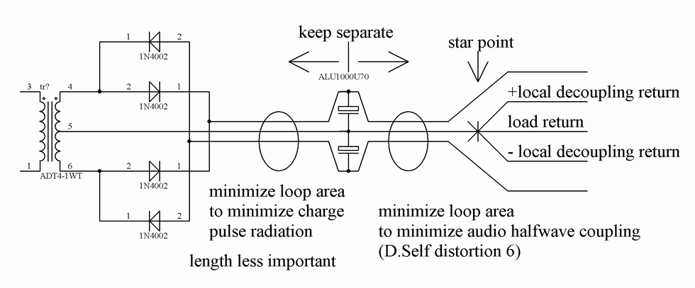

I think it should look this way:
kvholio said:
By keeping the ground-traces, +ve and -ve close together.
In the few designs i've made they always end up at the center of the pcb, not at the extremities.
This also offers the advantage of having short connections for local smoothing/decoupling caps.
Agree, but with the star point as close as possible to the cap midpoint, but not exactly at the midpoint. That is, the lead between caps and star ground should be as short as possible but not zero length.
Hi Christer,
have a look at psu.zip
A=connection to centre tap, this is very short 20mm to 50mm.
B=connection to cap common, this is very short 20mm to 50mm.
Join A & B and this junction becomes the start of the audio ground.
6-5-4 and 10-11-12 are twisted together, these are very short, 40mm to 60mm.
1-2-3 and 15-14-13 are twisted together, these are short 50mm to 100mm
All these connections fit with "keep it compact" and "small loop area".
Keeping them short fits with the low impedance (inductance + resistance) requirement.
But importantly, the audio ground is Neither the centre tap NOR the smoothing cap common.
- Bob Cordell Interview: Power Supplies
