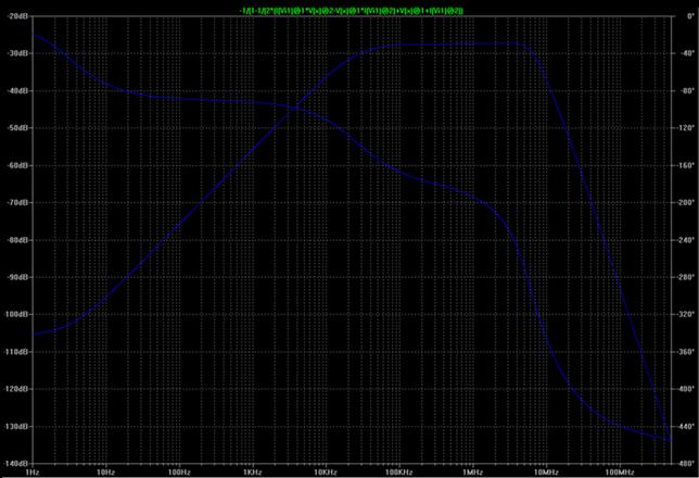

If you compare the first and last figures here, you'll see that the first figure is a multiple-loop system, while the last one is single-loop. So they are equivalent from an input-output perspective. Likewise, the loop gain of the last figure is the same as the inner loop gain of the first. But because of the block manipulations that have been done, groups of blocks have been coalesced. If any loops ended up being collapsed into a single block or similar, certain information about those loops will no longer be available. One such piece of information is the loop gain of any minor loops that may have been collapsed into a single block.
I don't know how, or even if, I can convince you of this, but here's another attempt. Remember this post? Try taking that sim, and moving the loop gain probe so that instead of being inside the innermost loop, it is, say, right in front of one of the diff amp inputs. Then compute the loop gain using the expression provided. Maybe that will convince you?

No need for apologies Mike - it's just a communication thing . Maybe we can agree on inner/outer terminology so it will match Rodolfo's paper when it comes out. I'll just change my naming if necessary.
Can you conceive of conditions (e.g. some imbalance condition) where this might not be the case?
You may want to look at this in more detail.
I don't know. I wouldn't want to make a snap judgement without looking at it carefully.
