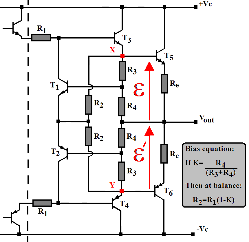

Error-cancellation-by-feedback.
Folks, working from MH's equations given in the figure below, the following may be deduced:
1. Select R3 and R4 to bias the output stage, and
2. Establish the ratio R2/R1=R3/(R3+R4) for maximal error cancellation.
It is my understanding from this equation, and from the schematic below, that the error ''E'' is extracted from the output stage with respect to its input ''X'' and simultaneously attenuated according to the transfer function R3/(R3+R4).
Thus, transistor T1 receives E.R3/(R3+R4) at its base, and must thereafter amplify the signal by (R3+R4)/R3 to reverse the attenuation occasioned by voltage divider R3, R4.
It follows, therefore, that since T1's gain (in ''common-emitter'' mode) is approximately R1/R2, then, in order to restore unity-gain-transfer of error ''E'' through T1, gain provided by the later must be R1/R2=(R3+R4)/R3, which is identical to Hawksford result in (2) above.
Simultaneously, transistor T1 necessarily provides the inversion mandated by stylized summer S2 here.
Clearly, the above analysis also applies to the negative polarity, whose electrical point of reference is ''Y''.
From my perspective, therefore, this analysis demonstrates that, at balance, there is NO such thing as infinite feedback in this loop, and that my objections were entirely valid in fact.
Now, Brain, if you have VALID objections to the above, arm yourself with cohesive and coherent evidence in rebuttal.

Now to calculate the gain of the feedback loop. Fig 8. is the simplified output stage (with the phases of G1 and G2 put right!) with the FETs removed (optional). The input is grounded and a voltage signal V1 is applied to the output. The ratio of v(n1) to V(out) or v(n2) to v(out) shows the gain of the loop.
I'll do the algebra in case anyone is interested.
The maths is tedious unless you assume perfect symmetry of the top and bottom halves. So assume gm1=gm2 and therefore v(n1)=v(n2). Remember, this is an ac analysis so dc levels are ignored.
The bottom half can now be ignored and effectively removed from the circuit.
Let i be the current through G1 and gm be the transconductance of G1.
v(fb0) = i.R4 + v(n1)
v(n1) = -i.R1
i = gm.[ v(fb1) - v(fb0) ] = gm.[ (v(n1) + v(out))/2 - i.R4 - v(n1) ]
substitute -v(n1)/R1 for i
-v(n1)/R1 = gm.v(n1)/2 + gm.v(out)/2 + gm.v(n1).R4/R1 - gm.v(n1)
which simplifies to
-v(out)/v(n1) = { 2.( 1 + gm.R4 )/(gm.R1) - 1 }
v(n1)/v(out) = - { (gm.R1) / [ 2 + gm.(2.R4 - R1) ] }
If you put in the values shown in the diagram, gm = 0.04, R1 = 680, R4 = 330, the ratio v(n1)/v(out) = -23.
The loop gain or "correction power" is 27dB. The real circuit will be different because the circuit values are different and there are some extra parts. Perhaps Andy or jcx would measure this in the full circuit simulation.

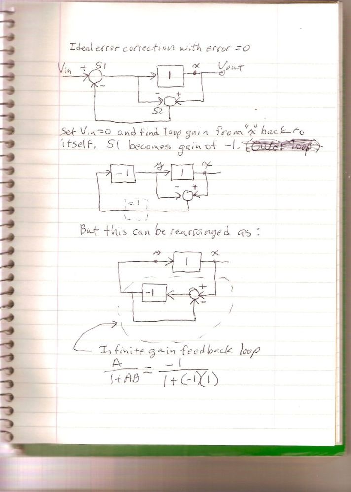

Nixie said:From andy_c's scan: ""Set Vin=0"
I assume you are doing this without loss of generality, for example only?
For a loop gain calculation, the external input is set to zero, and a signal is injected inside the loop (at "x" in my diagram above) to measure the gain all the way around the loop back to where the signal was injected.
So in the standard feedback system with forward gain "A" and feedback factor "B", the loop gain is A*B. But to get that you have to set the external input to zero.
andy_c said:
Bob is right, Mike. See the loop gain calculation in the attachment.
Hi Andy, your analysis is incorrect.
This may be established by setting all the ''K'' terms here to unity.
This gives a loop gain of zero for zero error extracted; i.e. an ideal voltage follower.
